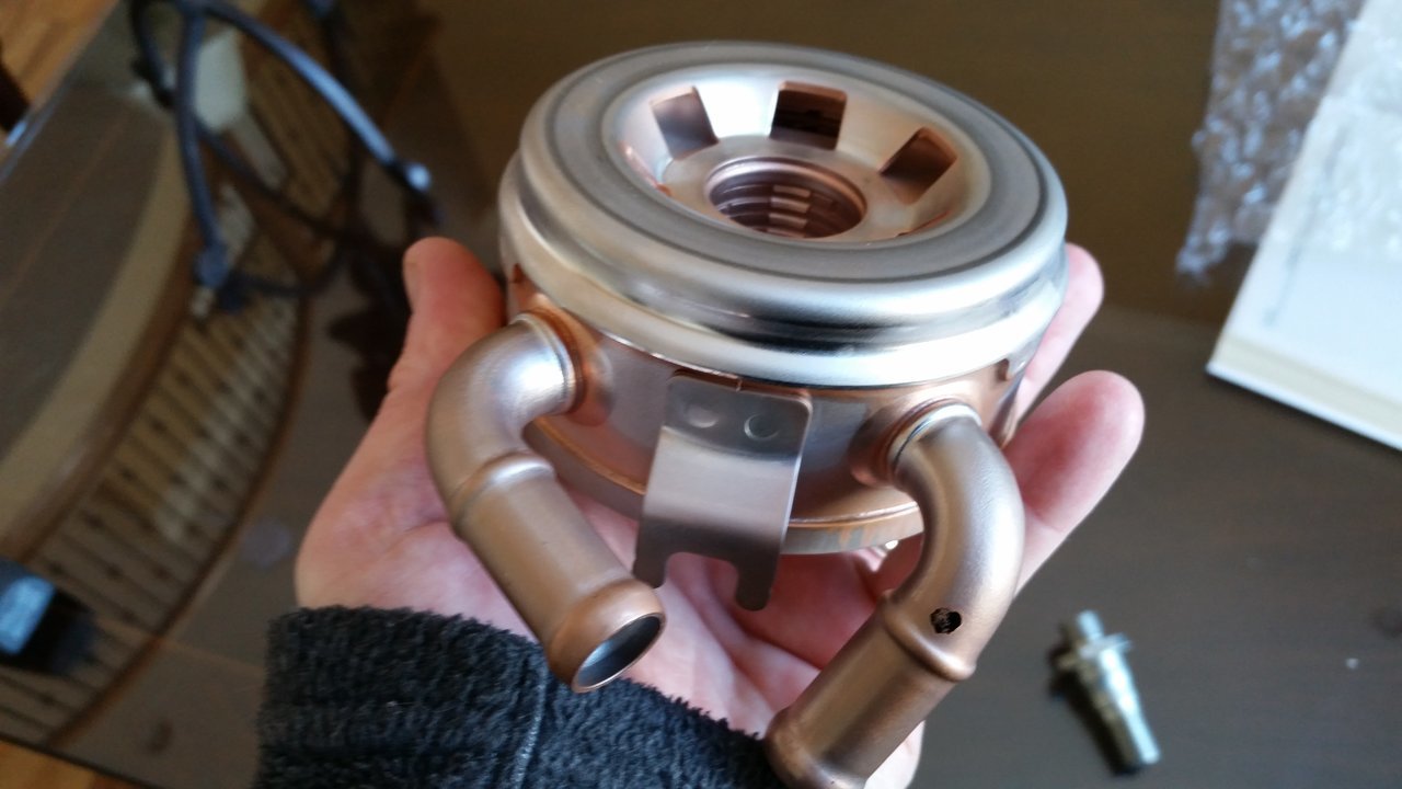

    The copper brazed stainless donut heat exchanger is always the killer from Toyota. If one part is aftermarket, my bet is on that one.

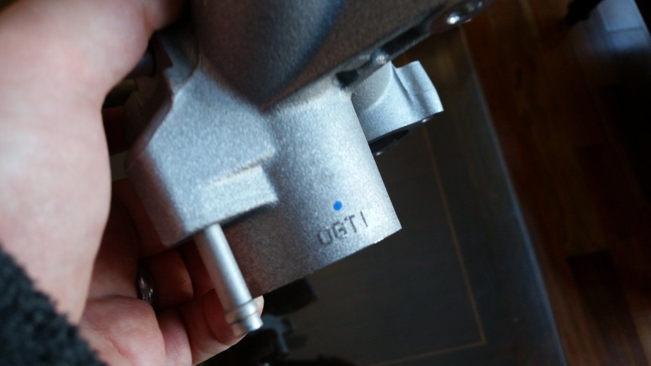

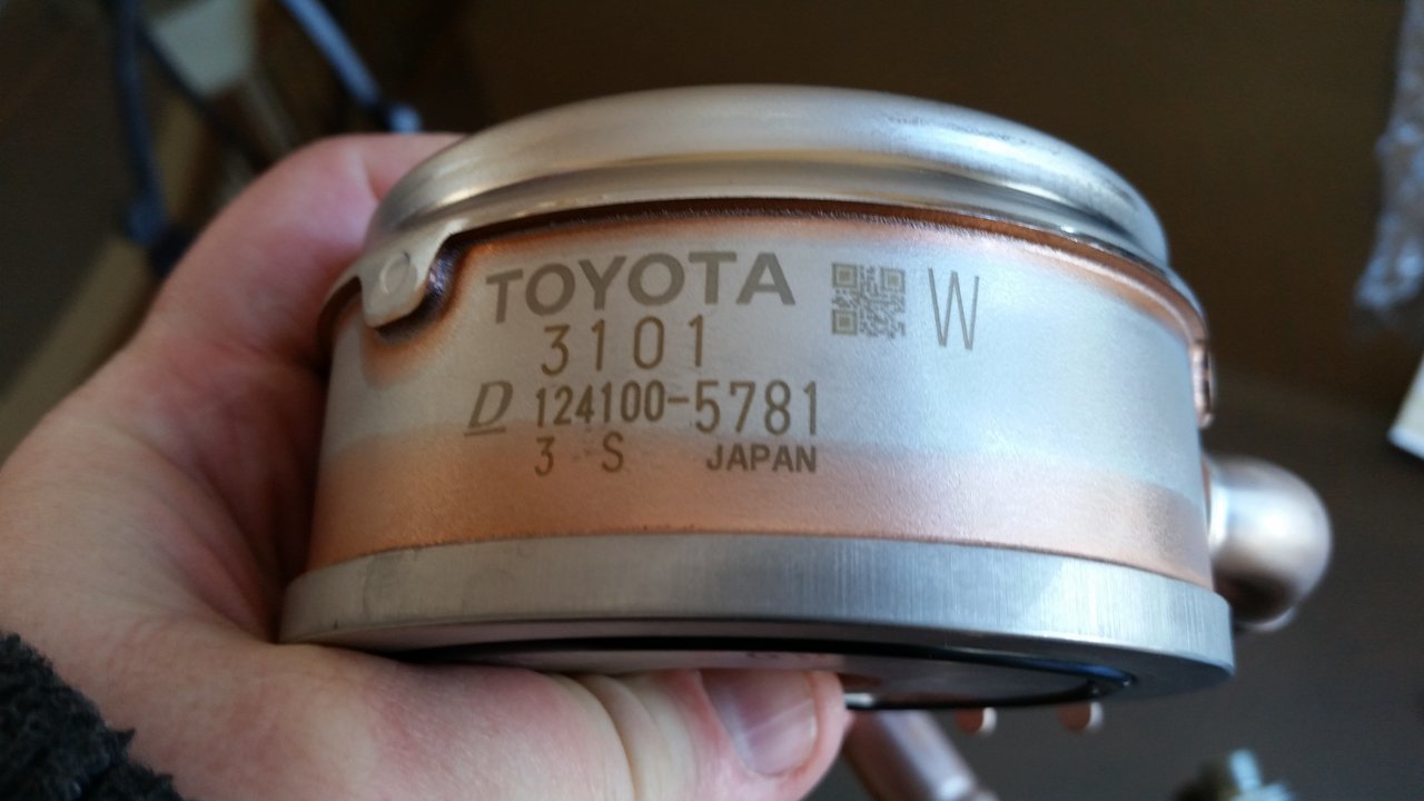

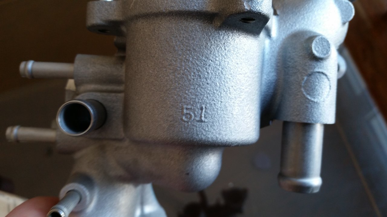

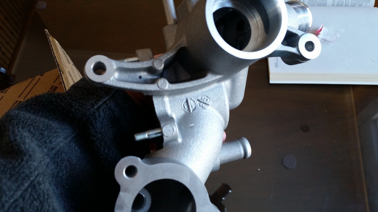

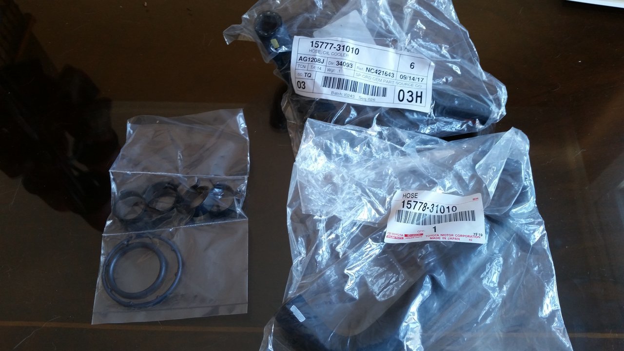

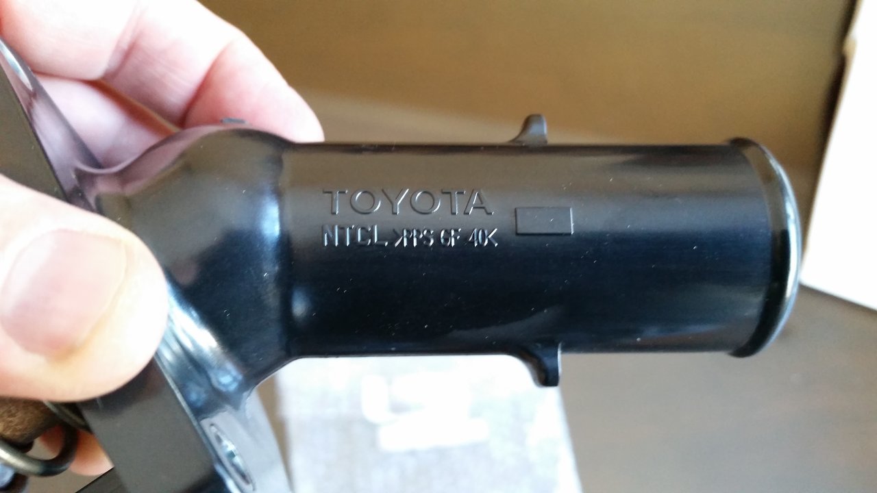

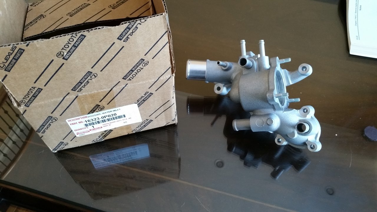

    The Source One parts arrived yesterday - only 3 days after ordering via USPS. Everything looks to be legit factory parts (see pics below). The kit also has everything needed for the install including gasket O-rings and hose clamps. Should be an easy installation. The only issue was that the seals on most of the big parts were already open. The box holding the water inlet housing was open, the sticker holding the thermostat's bubble-bag closed was torn open, and the filter adapter just came in bubble wrap. I think that maybe this vendor is a repackager of returned items that can't be resold at dealerships due to package damage. I see nothing to indicate that the parts are irregular other that their packaging, but for a third of the price that's fine by me. For $350 vs. the next best price of $650 and closer to a grand from the dealership, this is hard to beat. I might go to a dealership and have the parts guy pull the adapter just to see if it's identical, but I feel comfortable with everything now. Anyway there are no moving parts, so a leak is the main risk. I might also take the adapter to my lab at work and pressurize the water circuit to about 20 psi to see if it holds just for fun. I'm pretty happy with this deal, and will wait for warmer weather to slap it on. The only how-to write up that I could find for adding the cooler was on an FJ forum, and I can't allow that to stand. I'll take pics and provide a step-by-step in the spring.
