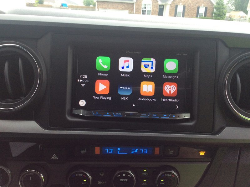

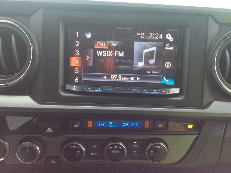

  17. May 28, 2016 at 5:31 AM
    #17
    bts1225
    bts1225 Member
    Dec 31, 2015
    #173635
    20
    Bryan
    2016 Toyota Tacoma TRD Sport
    Here are a few photos

    Did you lose any functionality with the center display between the gauges? I'm curious if you lose the radio info, nav directions, or anything else that the factory head unit pushes over to that display.
    forty2 likes this.
  19. May 28, 2016 at 2:19 PM
    #19
    forty2
    forty2 Well-Known Member
    Aug 21, 2015
    #162379
    1,391
    Cascadia
    2016 DCSB OR 6MT
    This.
  20. May 28, 2016 at 3:48 PM
    #20
    bts1225
    bts1225 Member
    Dec 31, 2015
    #173635
    20
    Bryan
    Yes nav directions no longer pop up there or incoming phone calls. You can still view the radio info that is playing.
