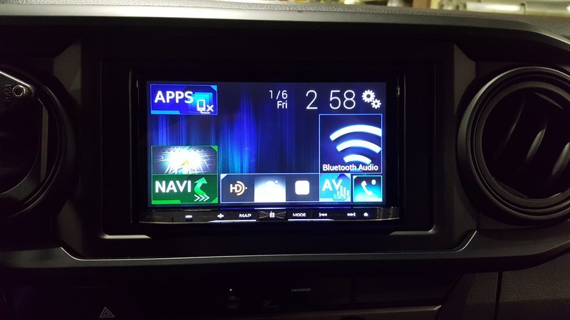

    That actually looks really clean, I like it! I couldn't care less about the Navigation or Phone Calls on the gauges. I'm guessing that's the install kit that Crutchfield included for buying the radio?

    Yes that's the install kit from Crutchfield and it looks great.
    The factory Bluetooth mic won't work anymore but I ran the mic and cable that came with the radio and put it in the exact location of the factory mic so it looks built in also. Just pop out the factory mic in the overhead compartment and put the new mic there. It came with just enough cord.

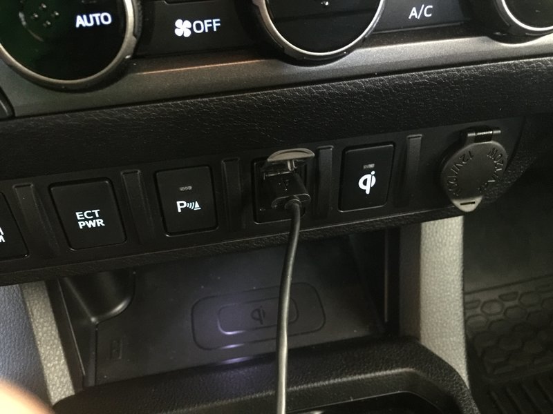

    I forgot to mention that the harness from Crutchfield also includes the adapter to keep the factory USB port on the truck so you can use this port to plug your lightening cable into to activate CarPlay if you want.image.jpg

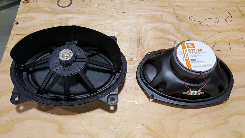

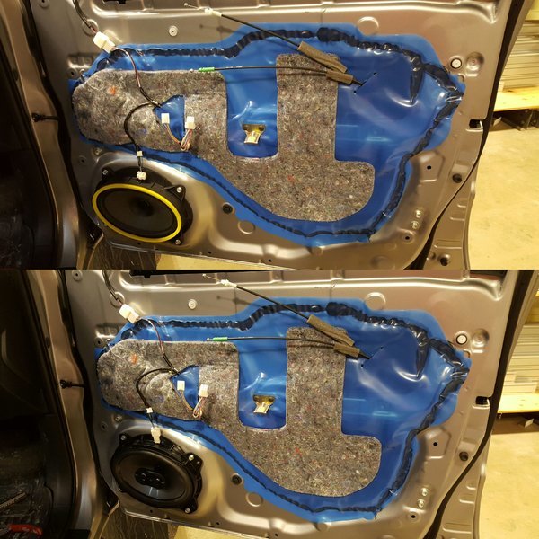

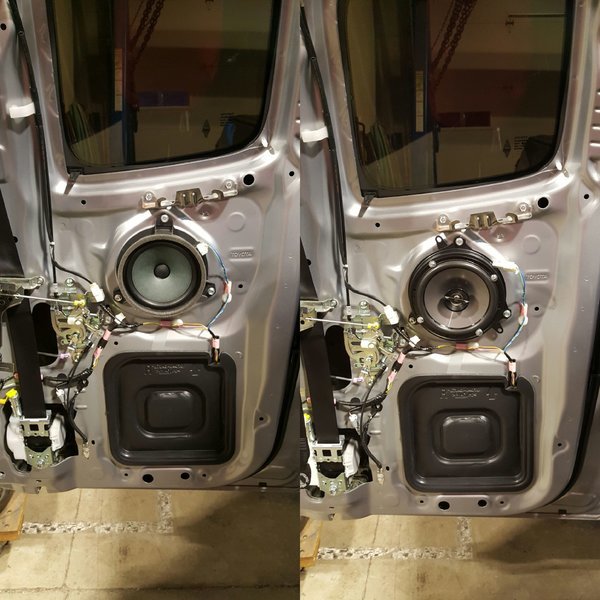

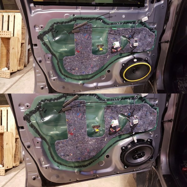

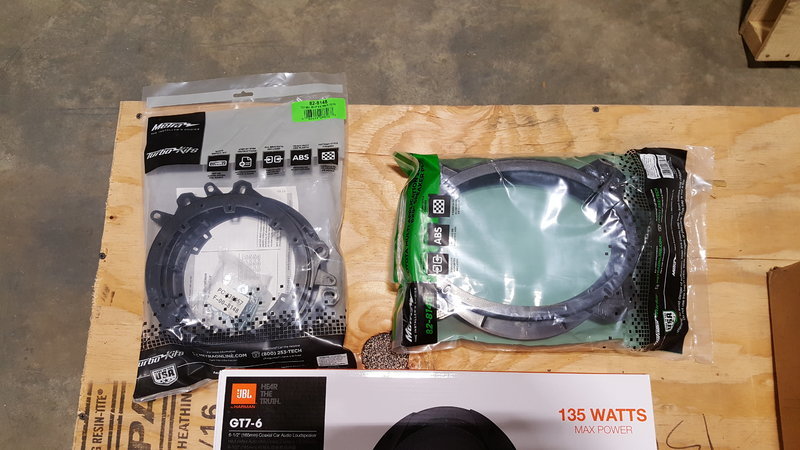

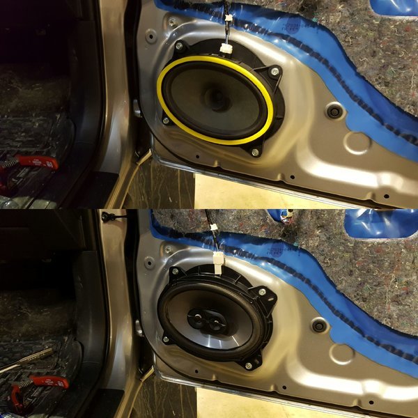

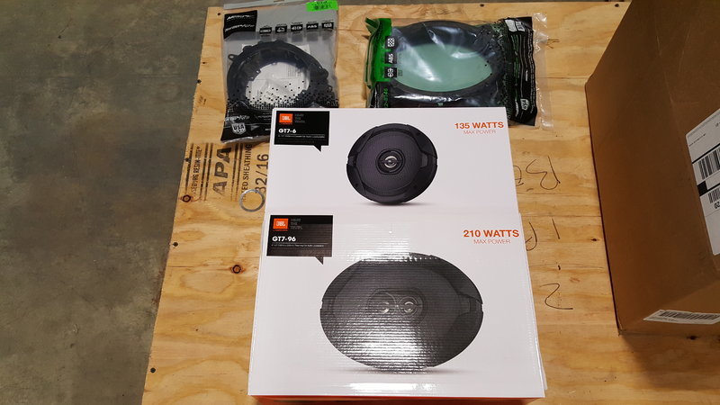

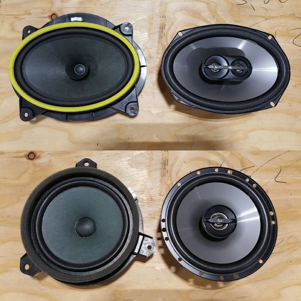

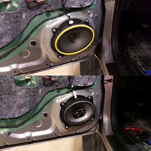

    So last week I installed my new Pioneer 8200NEX radio and with that radio I figured you cant have the stock crappy Toyota speakers so decide to upgrade and got 4 new speakers! JBL GT7-96's 6"x9 3 way speakers for the front and JBL GT7-6 6 3/4 speakers for the rear. Sounds so much better than factory, it's unbelievable how a good speaker can make that much of a difference. All the tinny sound from the factory speakers is all gone!
