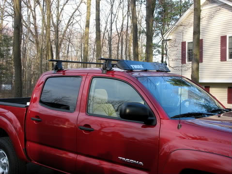

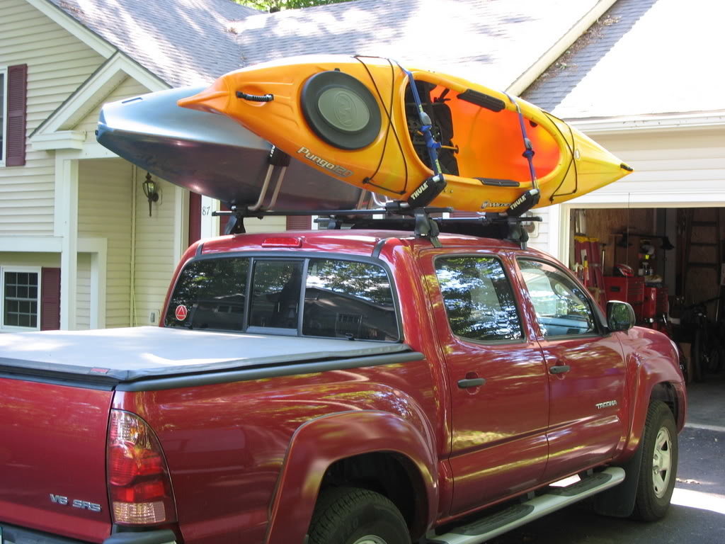

    On my last truck, I had a track system on my cap like the one you are talking about which worked great for my kayaks.
    On the tacoma DC, I mounted XT towers w/ crossbars & added a fairing. I keep the rack system up year round & have had no issues even on many long distance trips. It works great for the size & types of kayaks I use.
    What kind of kayaks do you have & what hull attachments you plan on using? With the J-Hulls I can sandwich 3 12' kayaks up there, but usually its just two of them like in the pic. The hull attachments come off when not needed. Post some pics of your set-up when complete.

    xedge, those pictures are great. i just came back from the store with a brand new rack for my 07 dc. i looked at your pictures, and it looks like i got the same thing as you (minus the kayaks). how do you like the fairing? was the wind noise bad without it/did it cut the noise down much? i haven't driven the truck yet with the rack on.

    The rack makes no noise at all with the fairing. It costs like $50 bucks but is worth imo. The whole system has withstood the Vermont winter & many touchless carwashes :D. No noise either. Also, I put a tape over the empty lock cylinder socket above my driver door (electical tape) because I do not have the lock option and the spot did whistle slightly. The tape stopped that too.
    Did you get the track system and cab towers or what? Post some pics, I love this rack setup big time.

    Been mounted on the truck for over a year with no rubbing issues. I clayed, polished & waxed the mounting area & made sure the rubber tower feet were clean by using a product called Just Once which is like 303. I do an inspection everytime I put anything up there plus check the tower tension regularly. I do know what you mean for I had the same set up on an older tacoma that I took off and on & it rubbed horribly. That is why I just keep it up there.
    They do compress your weatherstripping inside the door but nothing has leaked for over a year in any of the 4 doors.
    I do know over at Toyota Nation or maybe it was here where a member pulled up the rubber strips and mounted yakima towers I believe to the factory holes. I really didn't want to go that route or the factory rack so my trade off was the Thule setup. I am very happy
    with it.
    Oh yeah, I wanted to add that the XT towers actually have a litte lip on them that fit nicely into the factory strip rubber channel on top which hold the tower much more secure than more old tower setup. Its not like the tower is just sitting flush on the roof. The channel gives it a much more secure feeling if that makes sense to ya.

    I got the exact same system you have, just without the fairing. i did some highway driving yesterday and today though, and the noise was prety loud. loud enough to almost drown out my flowmaster (which is not a good thing), so it looks like i'll be buying a fairing soon. it once i get my final bike rack and everything set up on it i'll post some pics.
