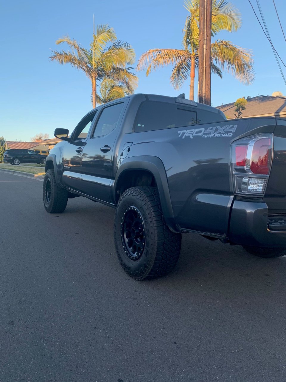

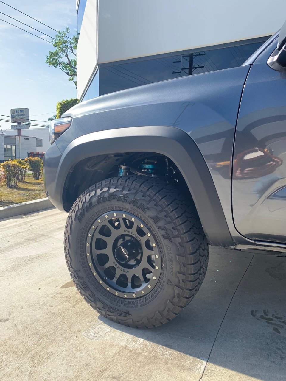

    I recently put Kings on my 2020 TRD Off-Road. I only lifted the front an inch and left the rear stock.
    Is there differences between TRD Off-Road, TRD Sport, SR5 and Limited as far as rear suspension and rear ride height? I'm trying to lower the rear about an inch and wondering if I need one of the other models leaf springs?
    Any insight appreciated.
    Thanks!
    Josh

    Trying to level it out and instead of doing a 2" in the front I want to do a 1" in the front and lower 1" in the rear. I feel like 33's look tiny and weird when the truck gets too high.
    Hmm this is interesting. A guy I know has a Limited and his stock sits lower in the rear.
