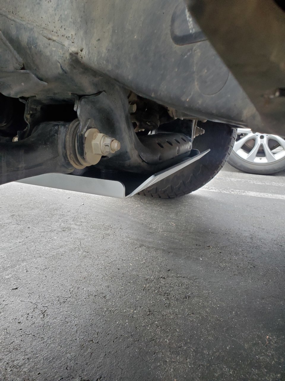

    Hey all,
    I was wondering if anyone has had the rear nuts (M8) for the skids come off the cross member and how they fixed that.
    Its this cross member, that the rear LCA mounts are on. Both the welded nuts have broken off and my skid rattles. Pretty annoying.
    I was hoping that the holes on top would line up, but they are too far inside. The holes where the bolts go threw are pretty much where the bend ends.
    So far I have thought of rivnuts or cutting the cross member open and welding new bolts in.
    Thanks,

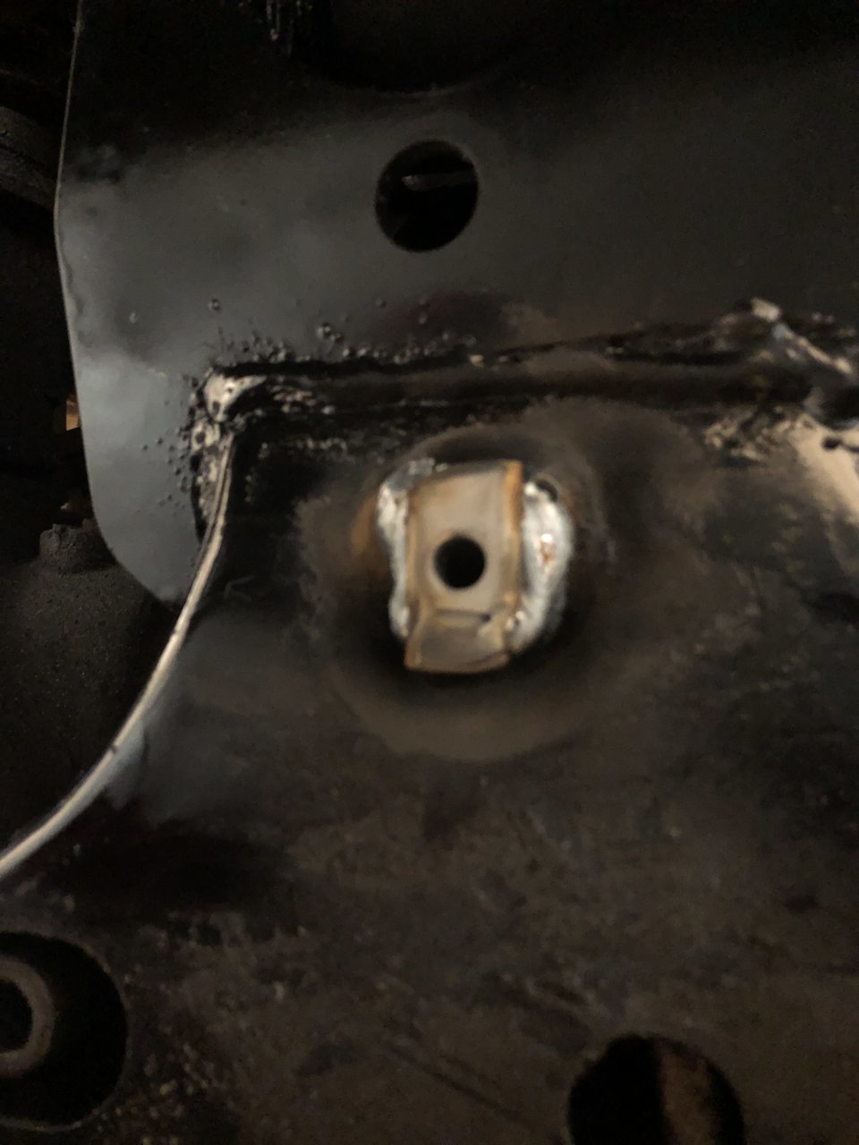

    So what @Skell and I did was weld some 3/8-16 unistrut nut directly to the crossmember. This actually made my beat up IFS skid fit a lot better as well.
