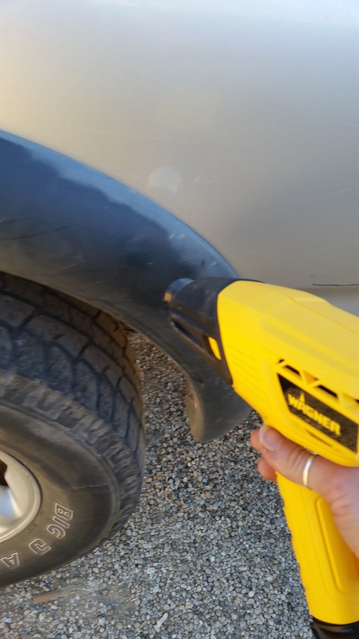

    Im not sure if this has already been disclosed, but in my past searches for a solution for my once black, turned oxidated (greyish/white!) trim, i never saw it~ so Im gonna share my great discovery all over (just in case someone else has been searching & wasting $"on bunk products all over the place, like I was!): Just today I was told about the brilliant move of using a Heat gun to lightly go over (& restore!) the black on wheel wells & front bumper area (whatever it's called) & mudflaps! Why isn't this info widely circulating? The first time you go over it, it turns a matte black, then if you go over it again- it becomes shiny! I'm sure I'm probably doing some irreversible future damage, but it is so gratifying now! I've longed for this result! Hahaha 20180217_164427.jpg

    That guy really went into detail! Bummer to see he concluded painting was the better choice, that's more time consuming! But the good thing is its actually a truck project I can do myself, without having to bother my friends, who I'm sure are sick of me & my issues! :p

    Honestly, the heat gun is way faster. No prep, no pealing overspray dip. You don't even need to clean the flares, even though it's probably a good idea.
    cruiserguy and Brie[OP] like this.

    I've heard that the heat gun works really well but it doesn't last very long and the more times you do it, the less effective it is...never tried it myself though, just what I remember reading on here. I ended up painting mine with black bedliner

    People said the bed liner paint and plastic dip both peel &/or get scratches & nicked easily. I didn't clean or prep at all (which I'm sure I should have), nor did I have any immediate adverse effects from going over dirt...

    Got this trick to work on my bumpers, couldn't get it to work on my flares though. :frusty:

    I've done both heat gun and plasti-dip.
    Heat gun trick sometimes can get tricky to get a consistent solid black and doesn't last very long before it fades again, since the plastic itself had already been degraded by UV.
    Plasti-dip is easier to get uniform finish and does stay black for a bit longer. However after 3 years under the sun it looked terrible, I could have just applied another dip but decided to go with a more permanent solution, which was paint with SEM trim black. While prepping for paint I really wished I didn't Plasti-dip, it had been so far degraded by the sun that it was almost impossible to get off, it wouldn't sand, peel, nor scrap so I ended up wasting hours and made a giant pile of mess dissolving it off using acetone.
