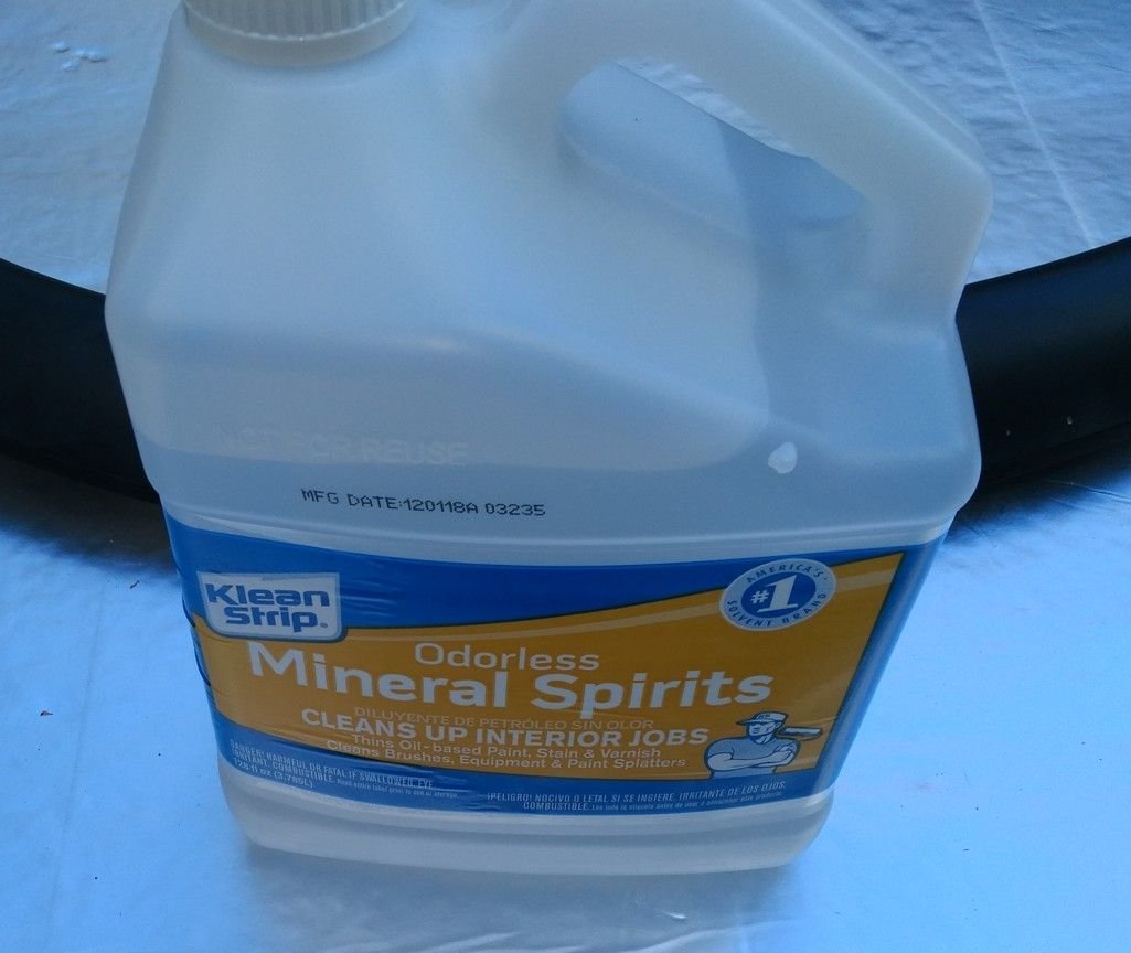

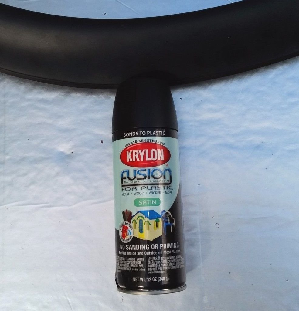

    The early 1st gen wheel trim moldings are white fiberglass. It takes a plastic paint to cover the white spots that come up from wheel chips.
    I used Krylon Fusion for Plastic on mine.
    URL=http://s286.photobucket.com/user/Ri...sh/06_Wheel_Trim_Krylon_Satin_Black.jpg.html]06_Wheel_Trim_Krylon_Satin_Black_a71c7890a4d015e851d132a6e8719f0252114641.jpg[/URL]

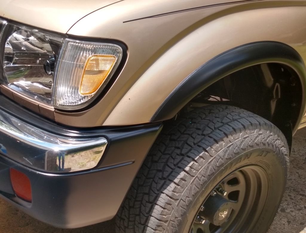

    It worked well for the wheel trim, so I used it on the front bumper.
    Since it bonds to plastic, no priming required.
    Use mineral spirits to clean before hand.
    I keep everything shining like new with 303 Protectant. Low maintenance from here on.
