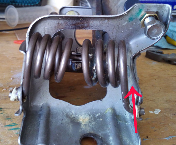

    This is exactly what mine did. After throwing money at new master and slave cylinders, flushing and bleeding the fluid I finally found the problem, and it was a five minute, six dollar fix! It was my clutch pedal return spring. It’s a goofy coil spring setup. It’s designed to help you hold the pedal down as well as pull it up. The plastic bushings on it wear out, and then the slot in the clutch pedal that it rides in wears deeper. Most people just pop the coil spring out and replace it with a brake pedal return spring. It’s a linear spring. Here is a thread about it https://www.tacomaworld.com/threads/clutch-pedal-truffle-shuffle.499079/ You can also use a clutch pedal return spring from a 4-cylinder Tacoma. There is a pin with a grove on the clutch pedal that you hook one end on, and a metal tab with a hole way up under the dash you hook the other end on. The connection points are already there because the 4-cylinder models use them.

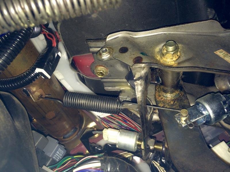

    Quit spending money on master cylinders. I can almost guarantee your problem is the return spring. This problem with the spring is common to these trucks, but not at all common in vehicles in general, so I would not expect many mechanics to know about it.
    This is something you can easily do yourself. The only hard part is laying on the floorboard and looking up under the dash. If that's going to be a problem for you, recruit someone smaller and more flexible. All you need is a screwdriver or something to pry with. Probably a flashlight too. Stick the screwdriver between the end of the spring and the bracket, and pry on it. It will come out fairly easily.
    Once the spring is out take it for a test drive. It's OK to drive it without a return spring, the clutch will push the pedal up. If the problem is gone, pick up a brake pedal return spring, or a clutch pedal return spring for a 4-cylinder Tacoma, and hook it on like this:
