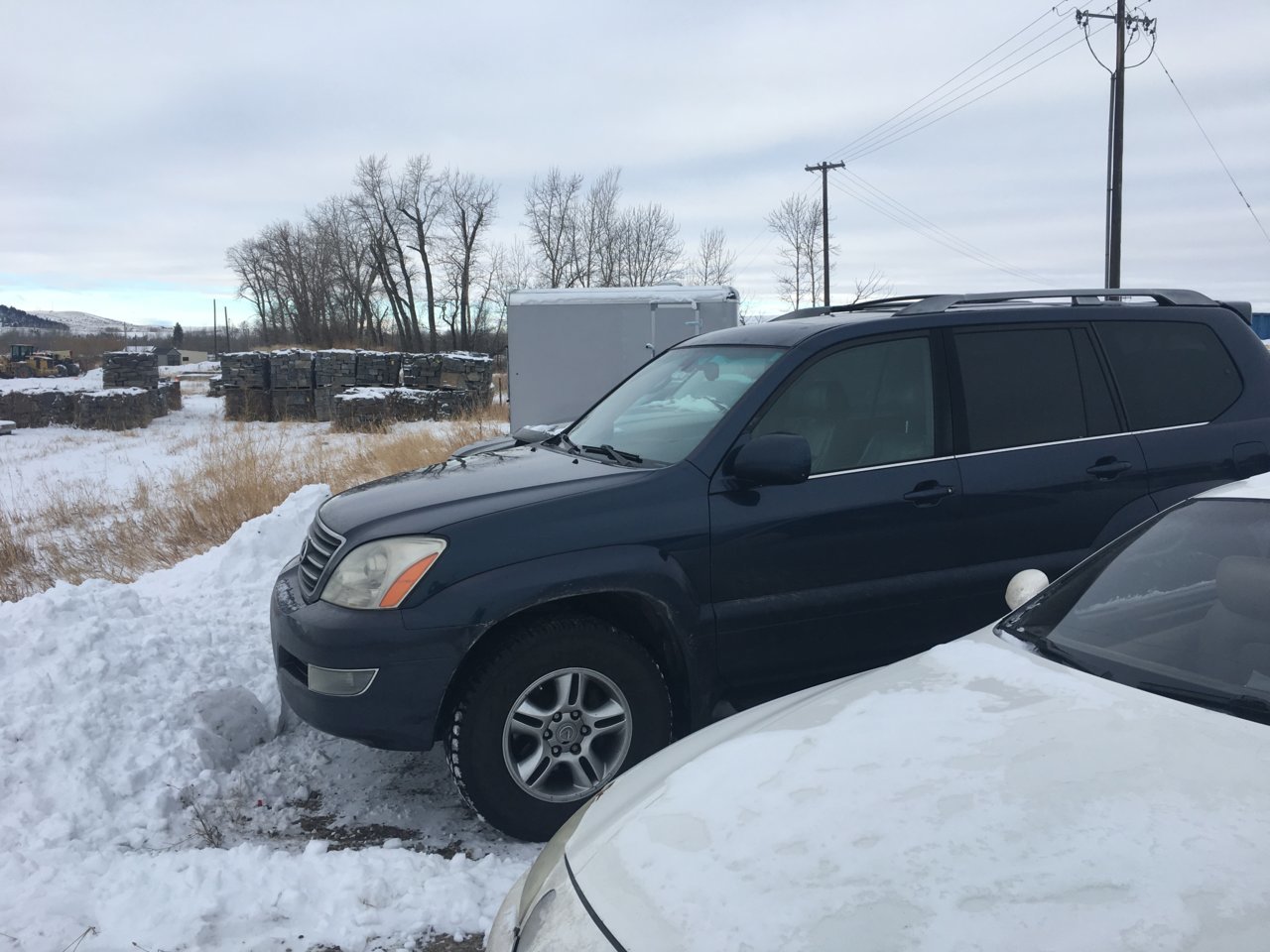

    Finally got it out to Montana. I bet it’s the first time it’s ever seen snow. Also ordered some icon delta joint UCA’s

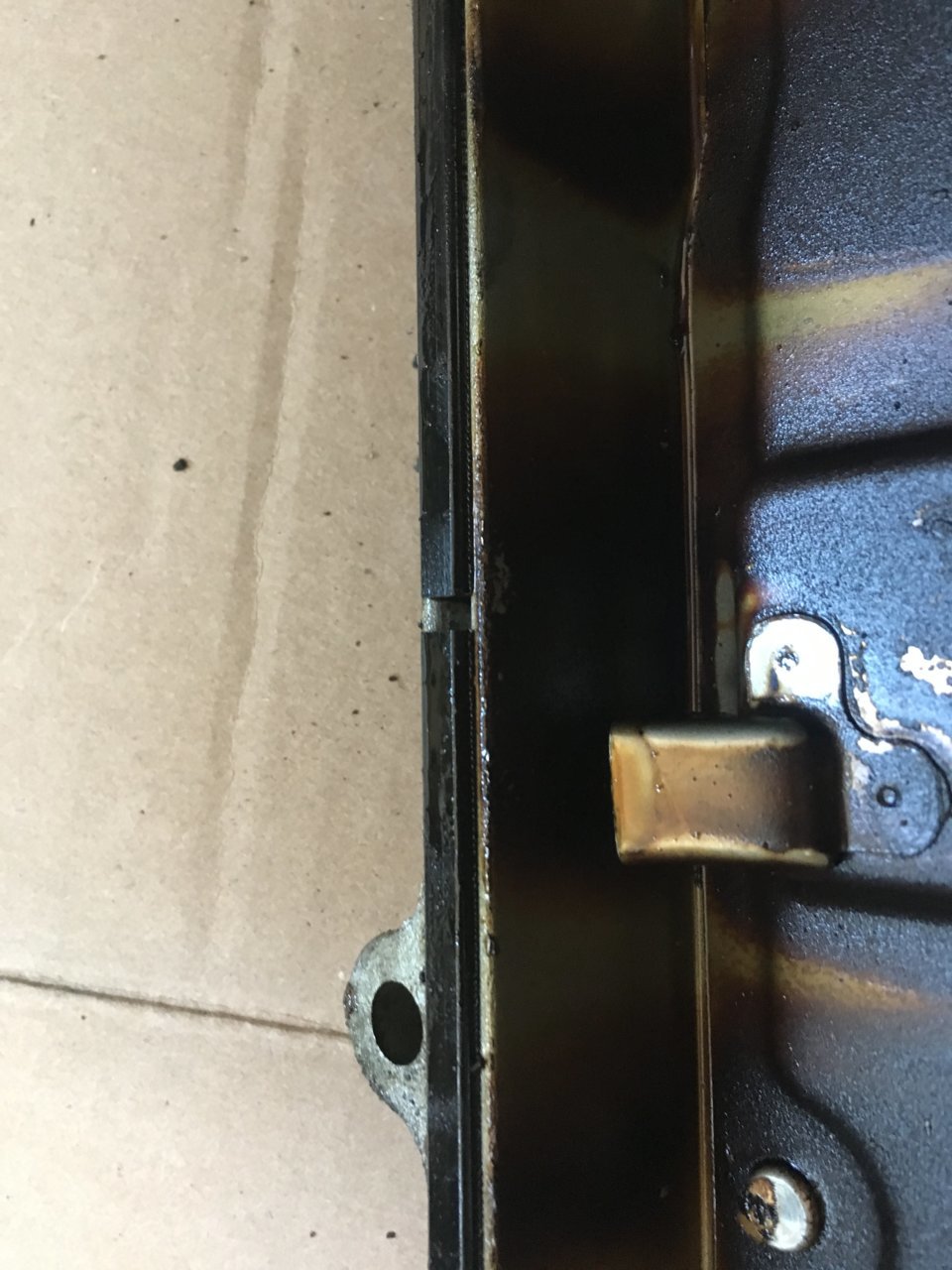

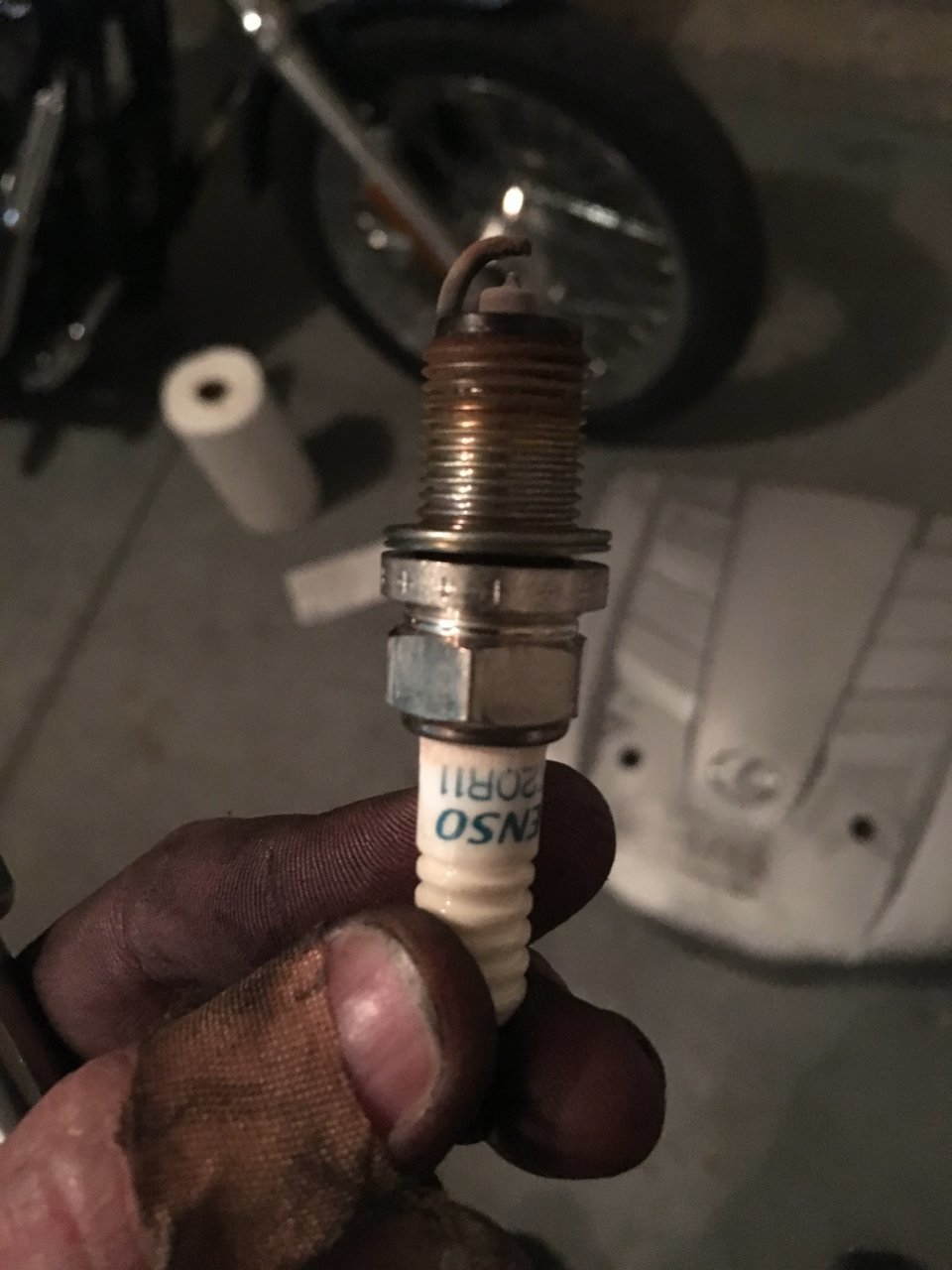

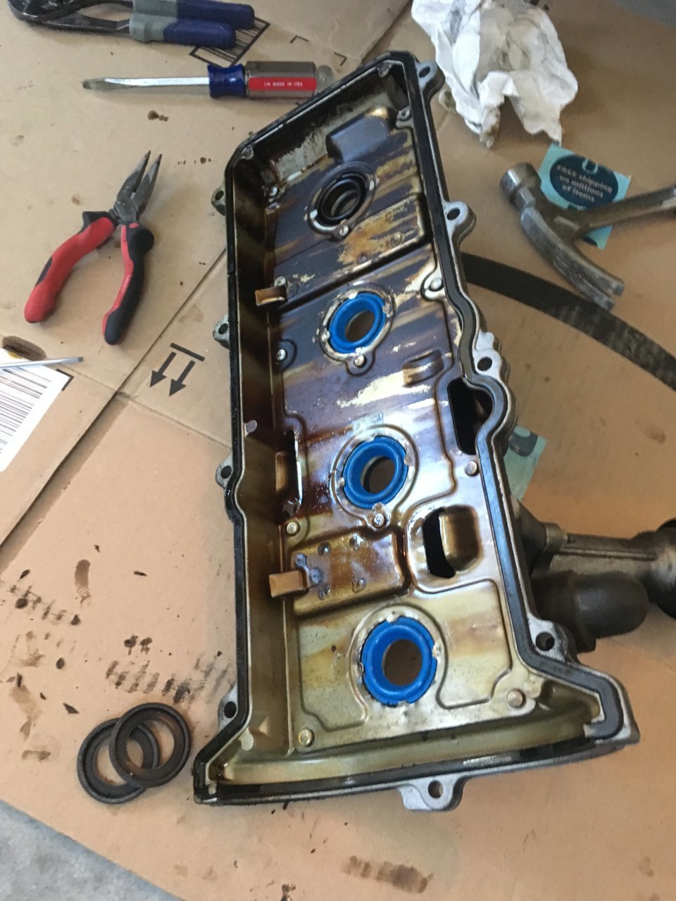

    It started leaking oil like crazy out of the valve covers once it got to cold Montana. Ordered up a fel-pro gasket kit off of Amazon and replaced the old gaskets and spark plugs today. The most time consuming part was replacing the spark plug gaskets. They were brittle like plastic. Found out why they were leaking so much oil. The gaskets actually split. Spark plugs didn’t look bad for having 145k miles on them.
