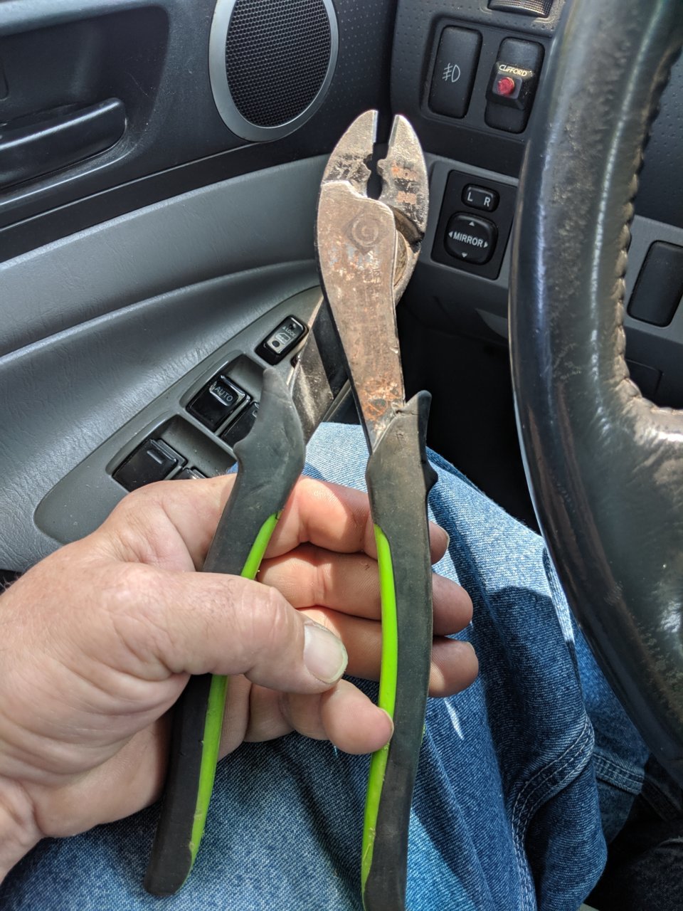

    If you look at the terminals on the connector to the resistor, mine had one wire that looked nasty. Look at it., If it's there, you'll see it.
    The fix is easy with wire strippers and a crimp tool. I got the kit at AutoZone that came with a new resistor, connector and insulated crimps.
    Use a crimp tool where the actual crimping happens happens on the other side of the pivot point. Use the not round die to crimp and put the seam of the metal of the connector under the die. Look inside it. It'll make a better crimp. Using the other will put a hole in the connector's insulation. You'll see what i mean....
