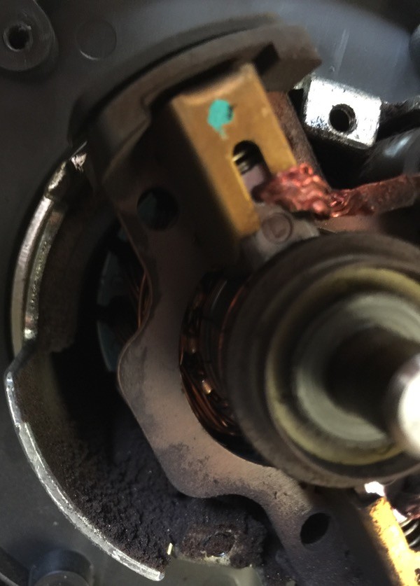

  20. Oct 18, 2015 at 2:29 PM
    #200
    lutafisk
    lutafisk New Member
    Jan 11, 2015
    #146128
    3
    Josh
    Idaho
    Tacoma TRD Sport
    Toytec Boss Suspension System, Nitto Trail Grappler 285/65/R18, Monster XD 18's, Pioneer AVIC-z140bh
    I have an '06 Tacoma, and I have been fighting a similar problem for about 2-3 years. The fan was intermittently working, and would always work if I turned it on high and pounded on the fan unit. This was fine until that stopped working, I looked through the posts, checked the resistor wires, resistor, checked the air filter, pulled the fan to make sure nothing was caught in it. Nothing seemed to work, as a last resort I pulled the fan out and took it apart, cleaned everything and re-assembled. When I put it back in the vehicle, not only did it work, but I have even more airflow than ever before. Here's a picture of the "dust."
