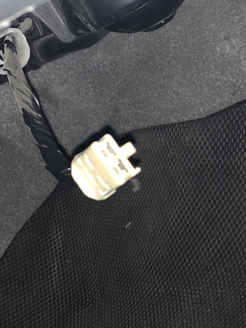

    Have you pull the white connector that plugs into the blower and looked for signs of overheating like this? It may not be your resistor.
    PapaBear[QUOTED] likes this.

    Nothing there
    But noticed the blue striped white wire coming from the resistor plug has overheated and burnt the plastic before.

    I bought both the new resistor and the replacement plug. If you read back far enough in this thread you’ll find that Toyota upgraded the resistor at some point. Turns out my truck already had the updated resistor and the plug was burned pretty bad. I went ahead and installed them both and have had no problems since.
