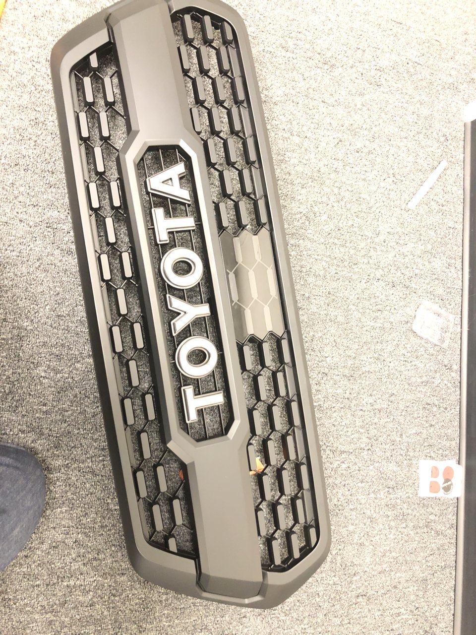

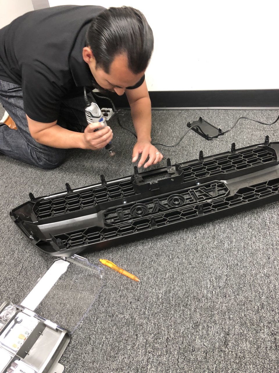

    My buddy bought a cheap one off eBay and we used a dremel to cut the part where the garnish goes into. We knew before hand it wasn’t going to be a straight forward install like the 18’ OEM grille that comes ready for garnish install...we just had to get creative
    here we were making the necessary adjustments for the garnish

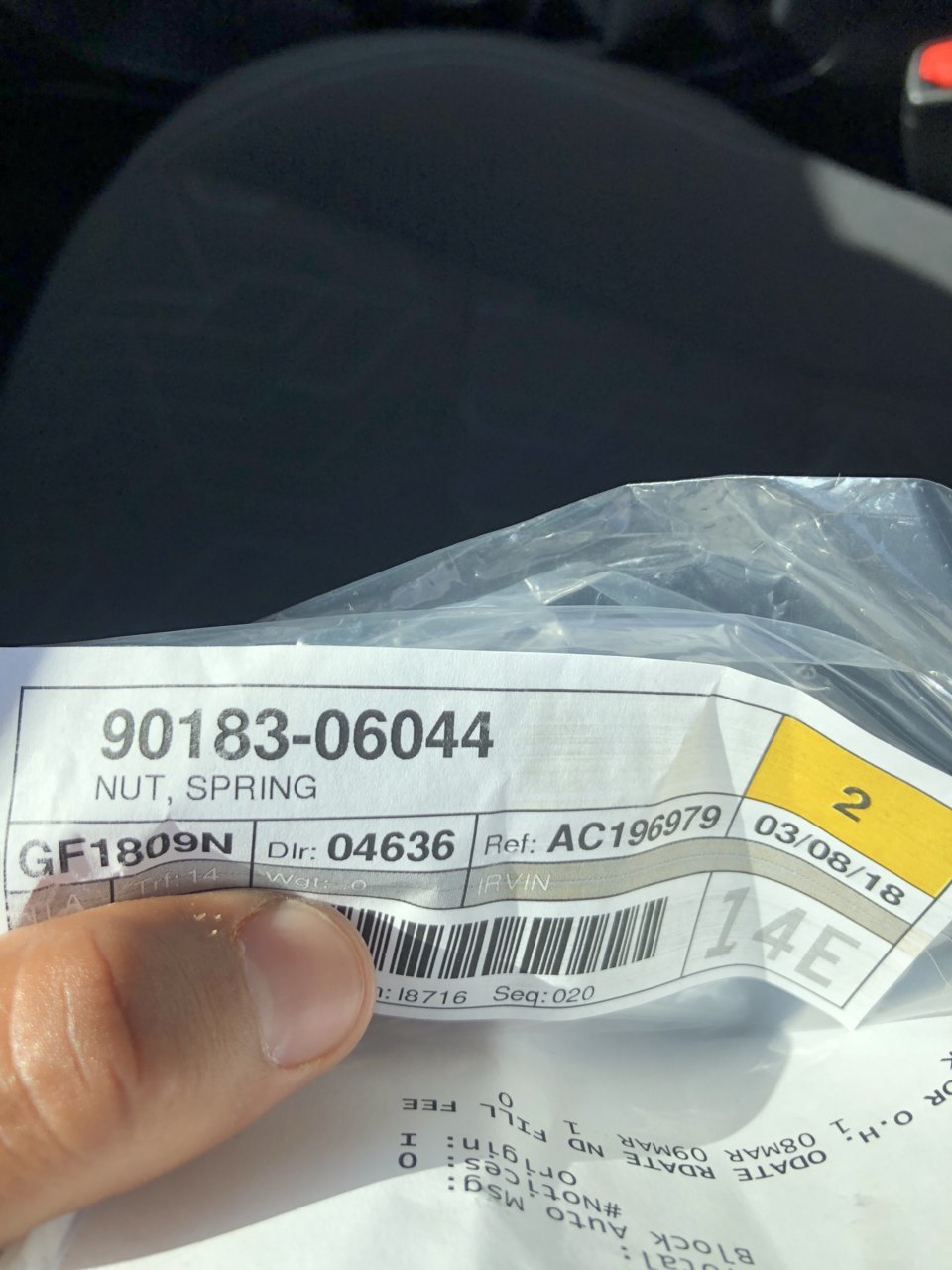

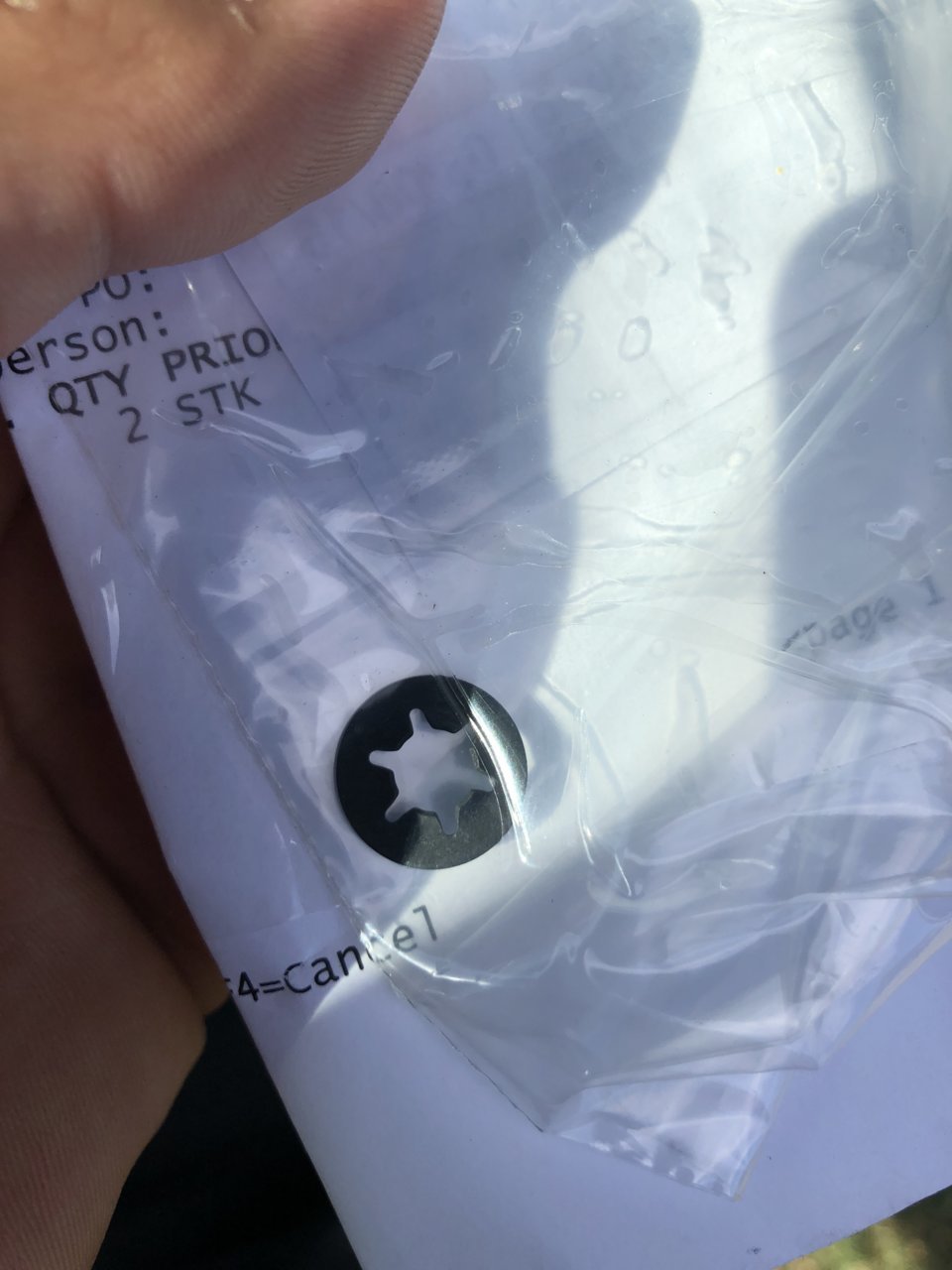

    we used theses oem fasteners for the top nubs of the garnish...I believe they were like $1 each(you need 2)

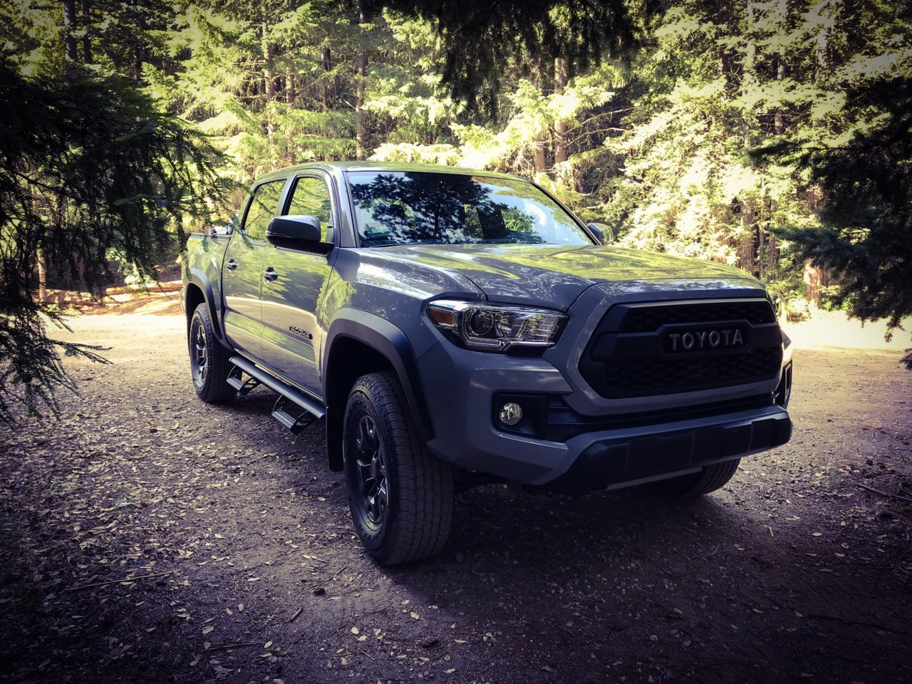

    here’s the finished product! Hoped this helped

    What size tires are those and are they the OEM wheels or aftermarket?

    Tires are 285/70/17 and they are aftermarket Fn fx pro wheels which to me are better than oem seeing as they are 17x8 0mm offset and 4.5 backspacing allowing you to mount a 285 tire safely

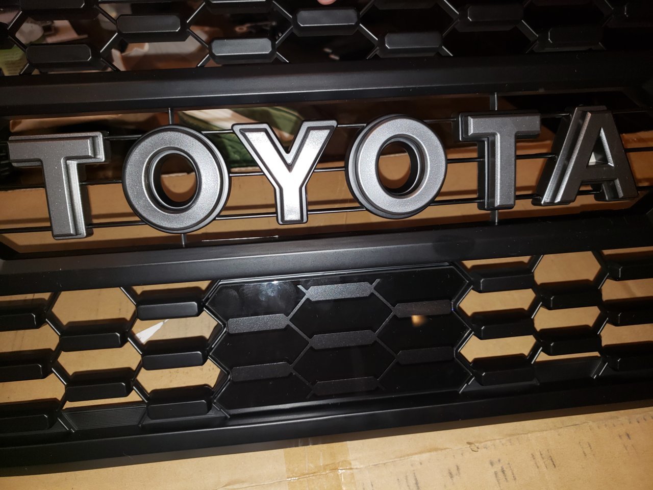

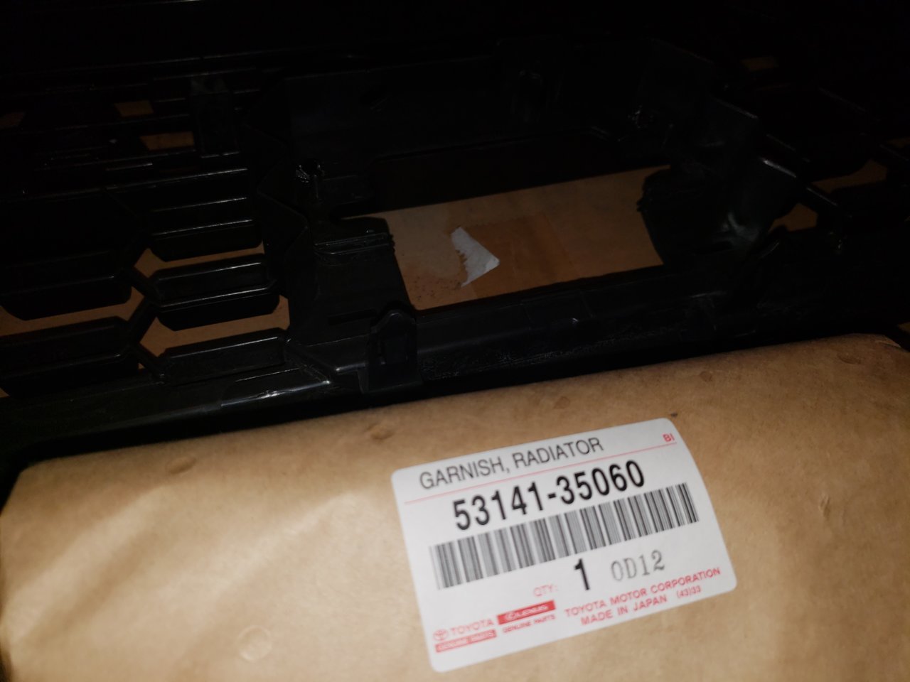

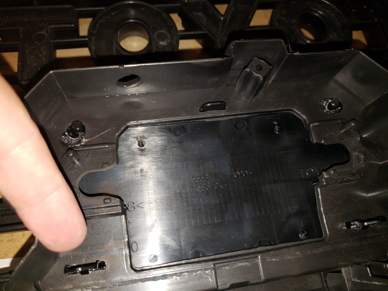

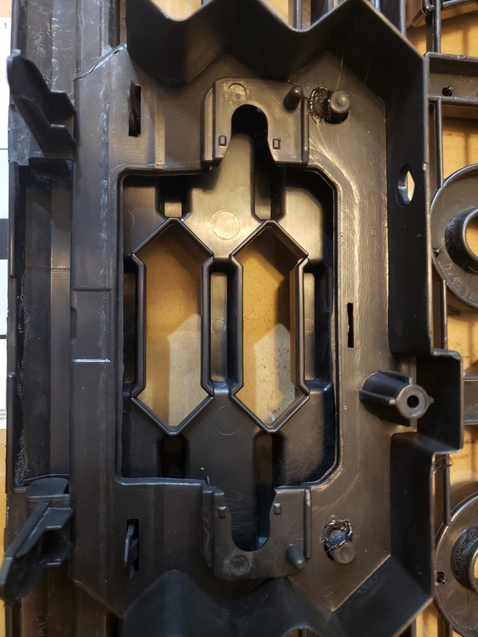

    I just received my CaliRaised TRD Pro Grill today. I purchased the factory garnish for the radar to pair with it. Before it arrived, I contacted CaliRaised to confirm the garnish would fit in their grill including the proper slots and they said it would. I can confirm it does have the proper slots and the garnish fits. I will say that the grill sensor cover came with the plastic cover pins is melted instead of secured with a fastener. I had to break them to get the cover out. The factory garnish is now only held with the slotted clips which seems fairly secure. I think they should not melt the pins and include fasteners to affix either the cover or the garnish for the TSS sensor (radar). Overall, nice replica. My dealer would not sell me one for my 2018 TRD OffRoad and if they did, it would be far more than the CaliRaised. I hope this recent experience is helpful...Grill with Garnish.jpg Garnish_Tabs.jpg Garnish.jpg Melt.jpg All,
