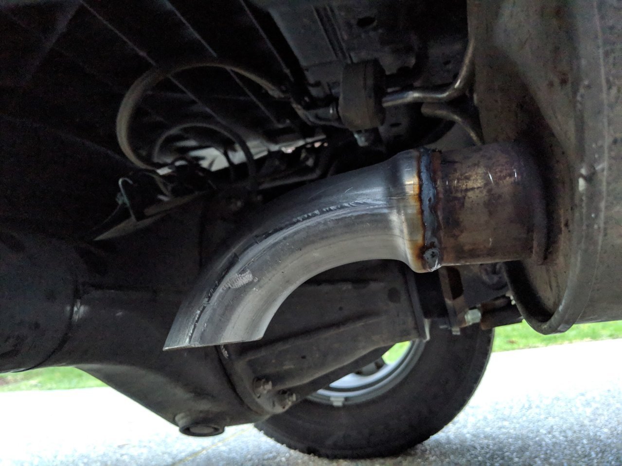

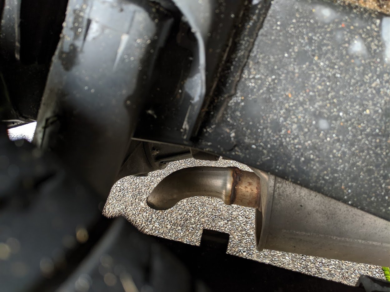

    Maybe mod your stock exhaust?
    Using a piece of the cut section or getting a nicer mandrel bend is recommended.
    This was temporary because trying to expand the heavy gauge at home was a fail.

    Spintech mufflers are super low profile and if you replace your OE unit you may get a bit more clearance. but if you want to get real clearance you'll need to reroute. then a low pro muffler can be something.
