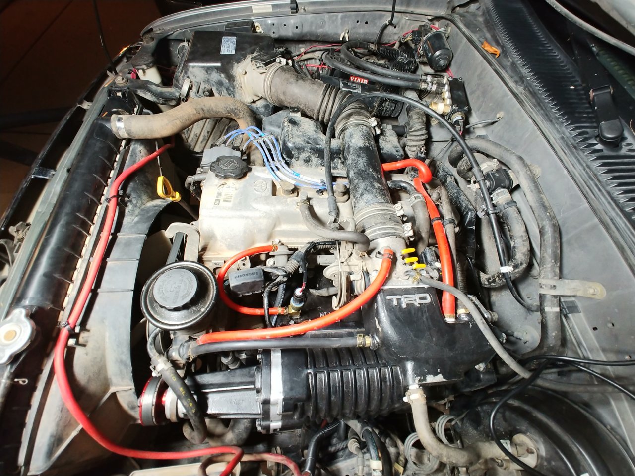

    I'm running two Viair 444C under my hood for OBA purposes... They're hiding at the top of the pic in my passenger fender with a manifold mounted to the firewall.
