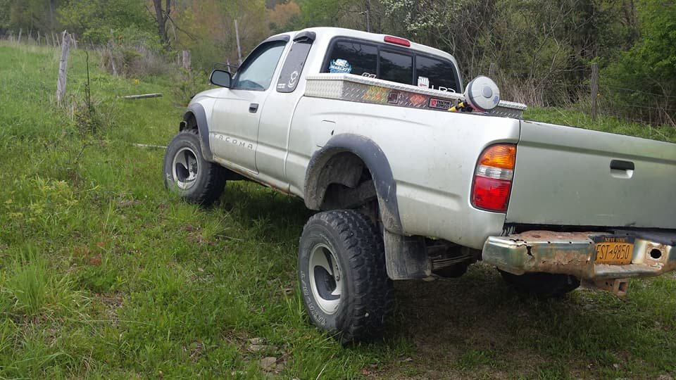

    I'm curious what everyone runs for shocks. I currently have sky jackers ans i haven't had much luck with them. The first set blew out in a year and they replaced them. Its about time for some new ones so I was looking for some suggestions. I have the OME Dakar rear leafs so about 2" of lift in the rear. I don't do any serious offloading. I do like to play but I also drive 60 miles round trip every day.

    I'd check the frame for structural damage from rust before I invested in shocks for it.

    X2 Your bumper is wasted... Tell-Tail sign of possible frame rust damage...

    You mean my brand new (5 year old) frame that Toyota was so kind to replace? Not a spot of rust on it anywhere.

    The rear bumper is my next project though. I built a front one for it, almost have my custom skid pan done. Not sure what i'm going to do for the rear bumper yet. Might do a pipe one.
