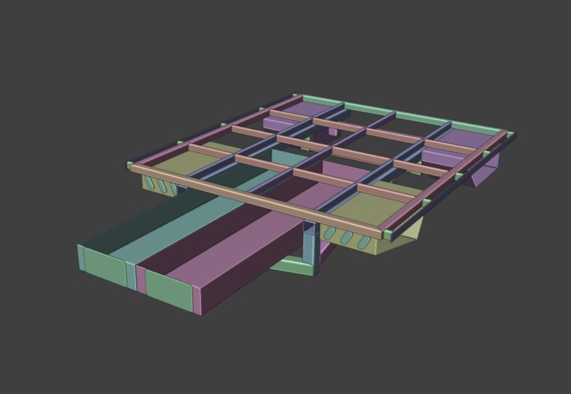

    Have you considered any diagonal bracing or gusseting? Not sure how much you plan to wheel where you might smack the side of the bed, but a little bit of diagonal bracing/gusseting can strengthen a structure like this significantly without a whole lot of additional material.
    Additionally, have you considered mounting points? Do you plan to use fasteners or weld straight to the frame? Make sure you have decent load paths for any forces you expect (from the structural weight itself, items you'll put on the bed, wheeling, etc.). You may want to shore up the frame in certain locations as well. Do you have access to any FEA tools (and someone proficient in FEA to do the analysis)? Would be good to validate the design against anticipated forces as well.
    Another concern would be weight, as others have mentioned.
    Overall, looks like you're headed in the right direction.

    you bring up a good point. this might not be what you mean, but I might try replacing the standard cross section of the upper frame with diagonal supports, and this might also help to reduce weight a little, especially if I try experimenting with C channel.
    I have vertical 3x3 tubing that I plan to weld to the chassis, across around 4 points on each side. im not sure if this is be best method. I was also considering two long beams than connect directly to the chassis, but I'm not sure how good that will be, and it will be adding more weight.

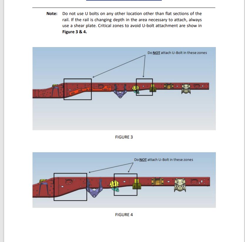

    I dont see any reason not to use the oem mounting points...

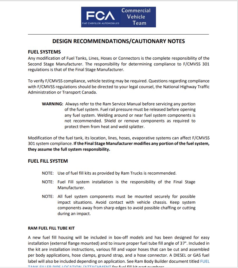

    I wouldnt do this with a tacoma. The frame is flimsy as it is. Cab and chassis trucks actually come with specific directions on how to mount stuff to the frame and how to load it.

    Nice find.

    glad you sent this. I might not have thought about covering the fuel tank, yikes.
    and do you know if I will need a new fuel filler neck? or could I re-orient the old one?

    Oh, that wasnt the point of sending that... I just meant cab/chasis trucks are alot different then even 3500 duallies and even more different than a tacoma.
    Filler neck will need some tinkering from what i have read. No details cause I havent done it yet.

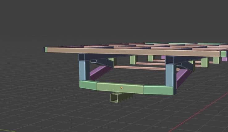

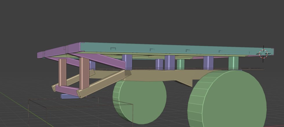

    Hello, tis been a while life has been busy, and I'm lazy :/.
    I have tried to re-design the main structure and bumper, putting in thoughts of removing some weight and making bumper good, still iffy on the bumper.

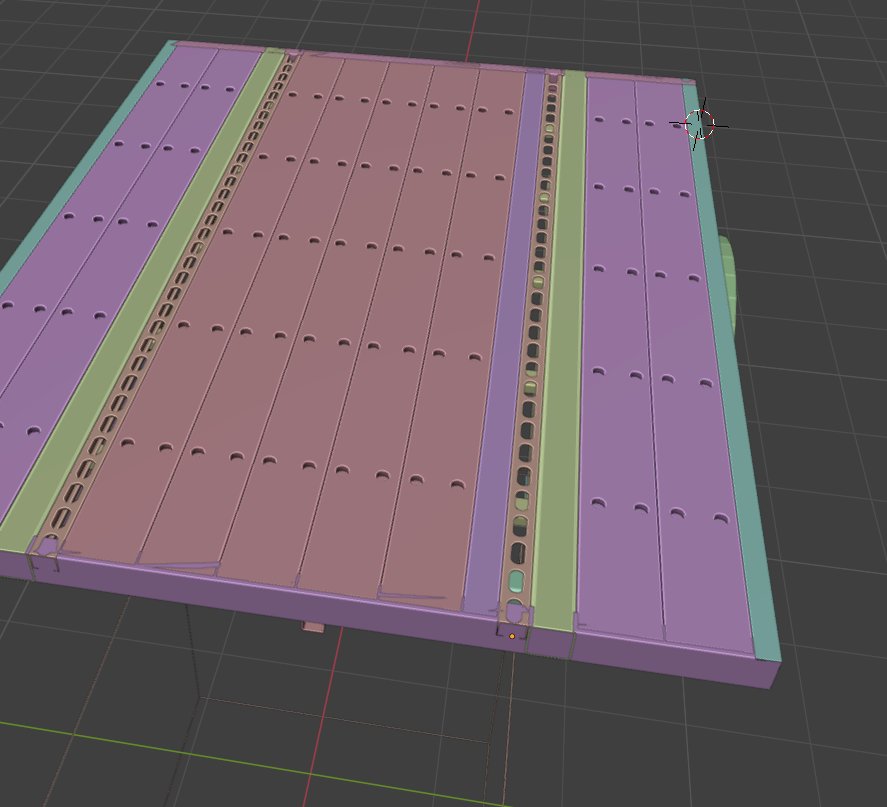

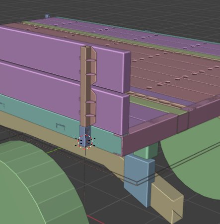

    I switched from using a big sheet of whatever, to using 2x6's resting on 2" c channel and bolted on. I also added the strut channel for more tie down opportunity. I will add D clips in the corners potentially and on the outer 3" c channel.

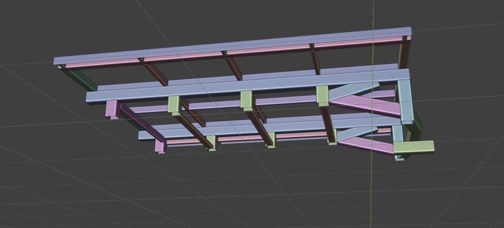

    this is the main frame under the boards, the two central bars are 3x3 tubing, the outer are 3" channel, and the cross channel is 2".

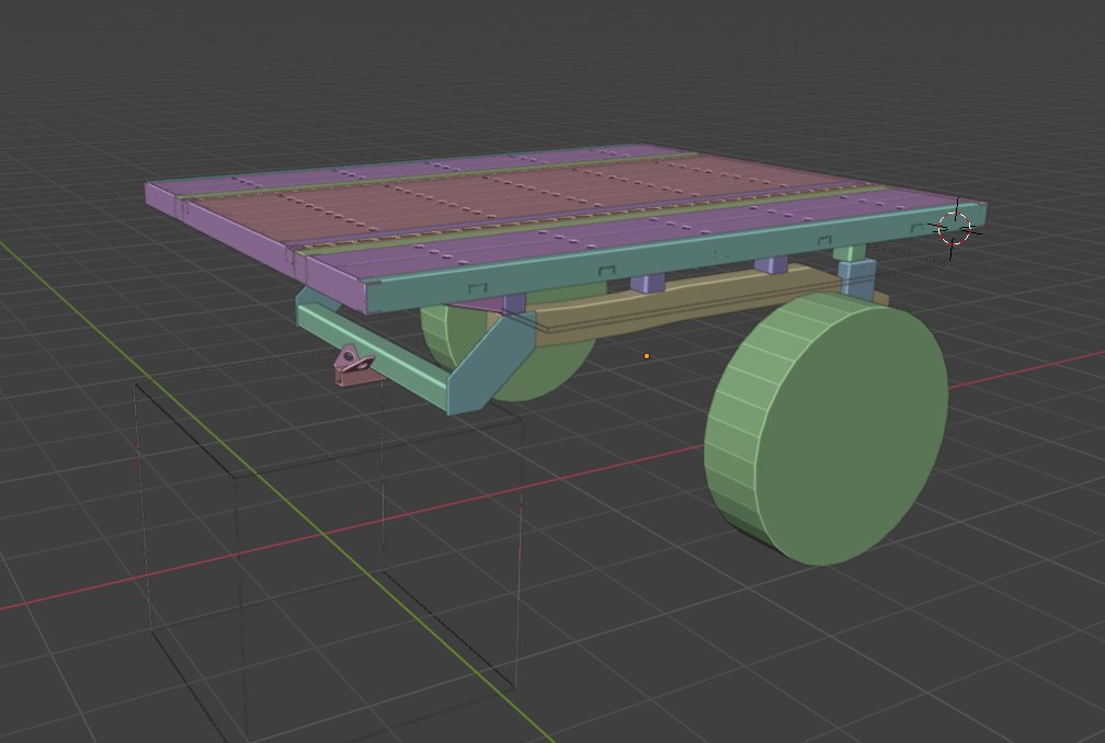

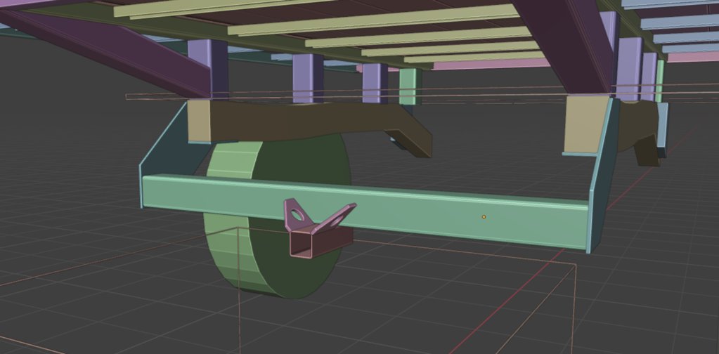

    I connected the bumper directly to the chassis this time, and will used 1/4" plate to connect it to the chassis. I added some some 1/4" plate to additionally hold the hitch and provide support, as well as to provide some shackle points. its currently pretty far under the bed considering I extended it a lot:
    I've seen some long hitch extensions, but I don't know how much I trust that/how much they can take. I've experimented a little bit with using 3x3 to extend the bumper and hitch out more so that its right under the edge of the bed, but it looks sketchy:

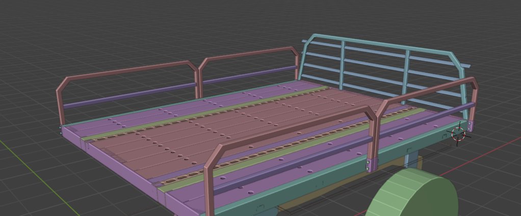

    I plan on adding a headache board and some side railing, still not sure about how i want to design that though. I will also add a license plate spot and some rear lights. I might still do the long middle drawer, and I do want to put some other storage under the sides.
    here are some of my ideas:
