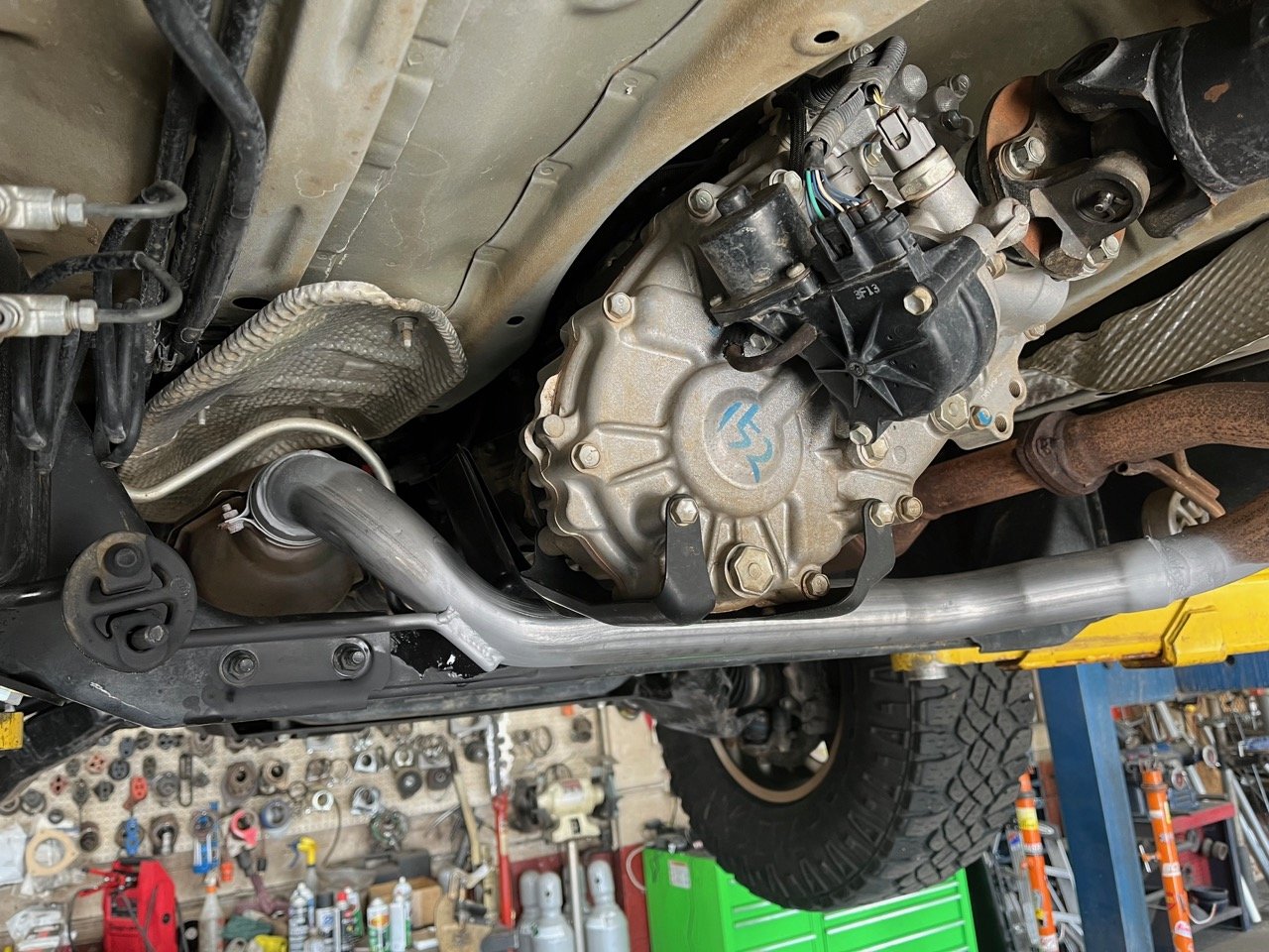

    Got mine done at an exhaust shop that had done a lot of the re-routes (AA performance muffler, Englewood Colorado). He had this process so dialed I was only there for 30-40 minutes from the moment I walked in the door, to the moment I was driving away.
    1. Had some noise against the heat shield when I left, no issues after 100 miles
    2. No interference issues, it was plenty of clearance for the flat skids. (probably about 1"
    3. Skids are too new to tell if there are issues (powdercoated RCI skids)
    4. no enough miles on mine to tell yet
    Having your corner Meinieke do this level of re-route is probably not a good idea.

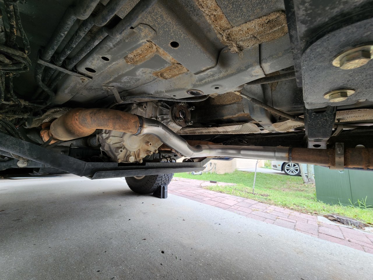

    I had mine routed just under the tcase output flange. Big mistake. I've gone through 2 u-joints and flange and yoke replacement in the past 6 months due to exhaust heat. Since then I recently had rerouted a little lower to keep the heat away from it. Driveshaft is removed to have a new flange and yoke installed. 20220521_121506.jpg
