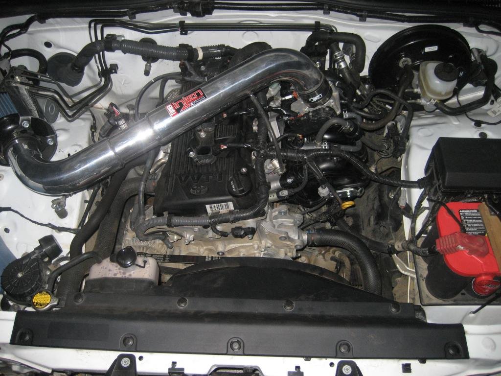

    The first production run of the tooter II.VII intake manifold spacers began today! [​IMG]
    Driving home from the shop, I did a little spontaneous video of a 2nd gear/3rd gear run from 25mph to 70mph, before having to slow for a sharp curve in the canyon road.
    http://www.youtube.com/watch?v=UFTl75q49e4
    The only sound you are hearing is from the 3 foot long Injen intake. There's no exhaust sound because I'm running the super quiet stock muffler.
    I also have a bunch of pics and video of the CNC machining of the first spacer, and will post them as soon as they are uploaded.
