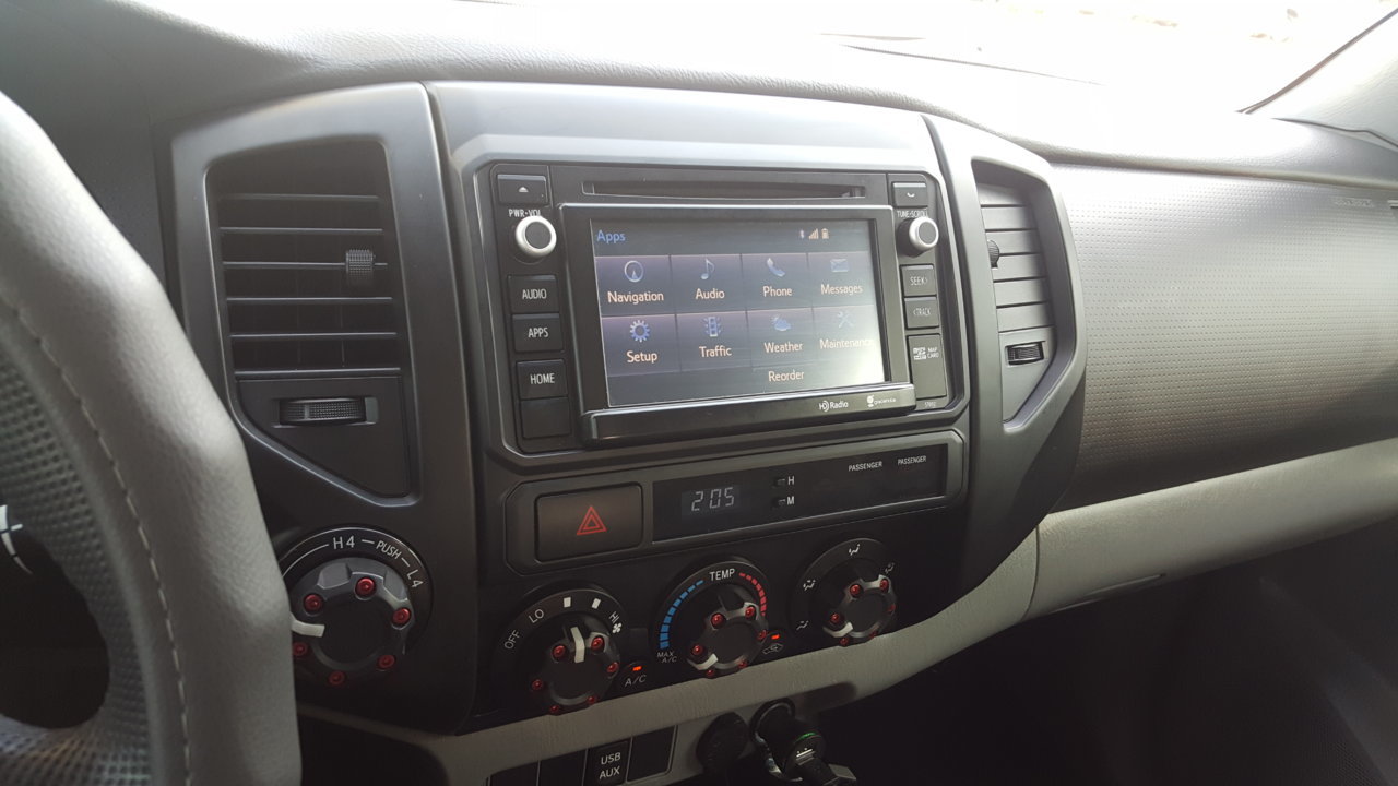

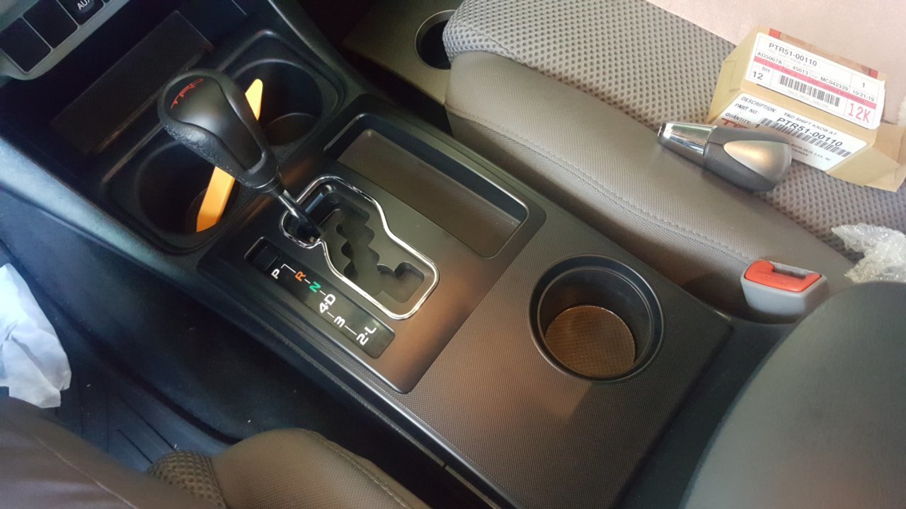

    Just finished installing these on my '14, definitely prefer the black over silver trim pieces.
    To clear up a couple things I saw throughout these 64 pages for anyone else that does this:
    • 55421-04050 is the correct part # for the matte black head unit bezel
    • I don't think the steps linked in https://www.tacomaworld.com/threads...t-interior-parts.449999/page-39#post-13569275 are necessary for the AC vents/head unit bezel.
      • I did follow steps 9-12 and 14-17 myself, but after getting the head unit out, I saw no panel overlap that made it seem like the speedometer had to come out at all. I think it may be possible to simply remove the A/C control panel, unscrew the 4x headunit bolts and pop it out.
    • Don't be a dumbass like me and forget to swap your A/C vents to the new trim piece before installing it.
    • https://toyotaparts.mcgeorgetoyota.com/ had the cheapest OEM parts I could find
