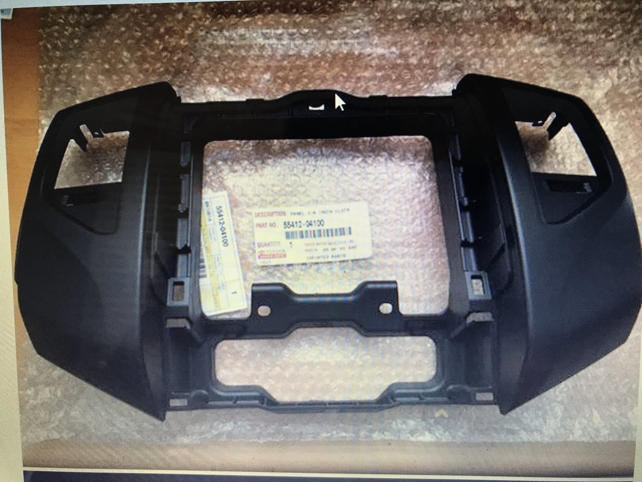

  6. Nov 17, 2021 at 2:22 PM
    #1526
    gotoman1969
    gotoman1969 Well-Known Member
    May 30, 2018
    #254966
    7,009
    Steve
    San Antonio, TX United States
    2015 Silver Tacoma PreRunner
    3" ToyTec coilovers, JBA UCA's, Bilstein 5100's
    Pn# 55412-04100image.jpg@Drupiano
    Dark505 and Tac11 like this.
