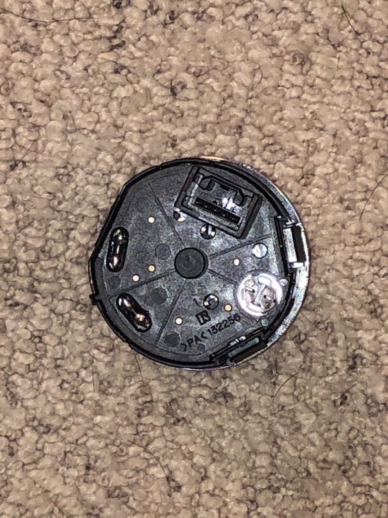

    My unmodified black switch 84724-04030 does not light up. A little hard to tell but you can see the HVAC fan dial is lit.

    No need for the ring? Literally plug & play?
  10. Jan 28, 2025 at 7:02 PM
    #1590
    Dogota
    Dogota 2015 DCLB
    Feb 10, 2019
    #282592
    133
    Mark
    Seattle, WA
    Whole thing pops out, plug n play.

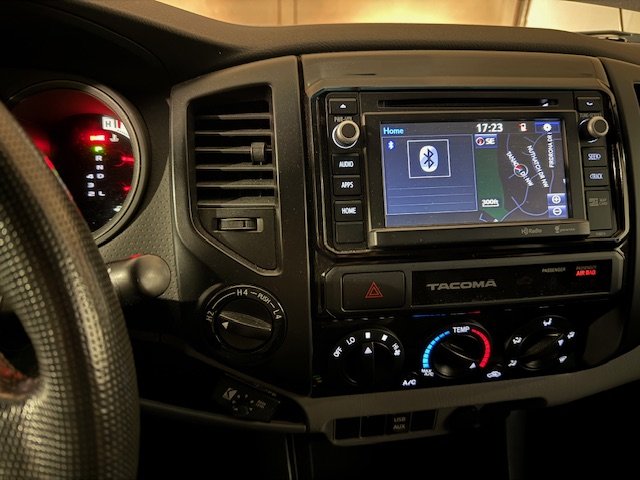

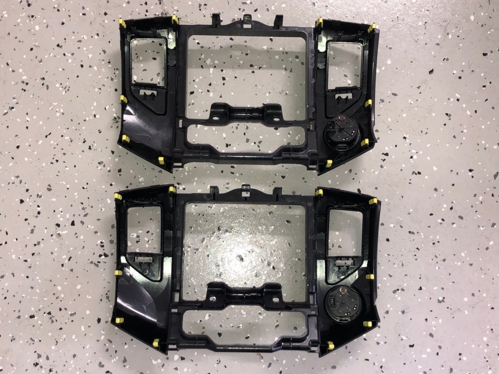

    The Thanks for all the info, and numbers! I got mine all done last summer, and just got around to posting my finished inside!IMG_3655.jpg IMG_4592.jpg
    Robb_R, Dogota and herecomesace like this.

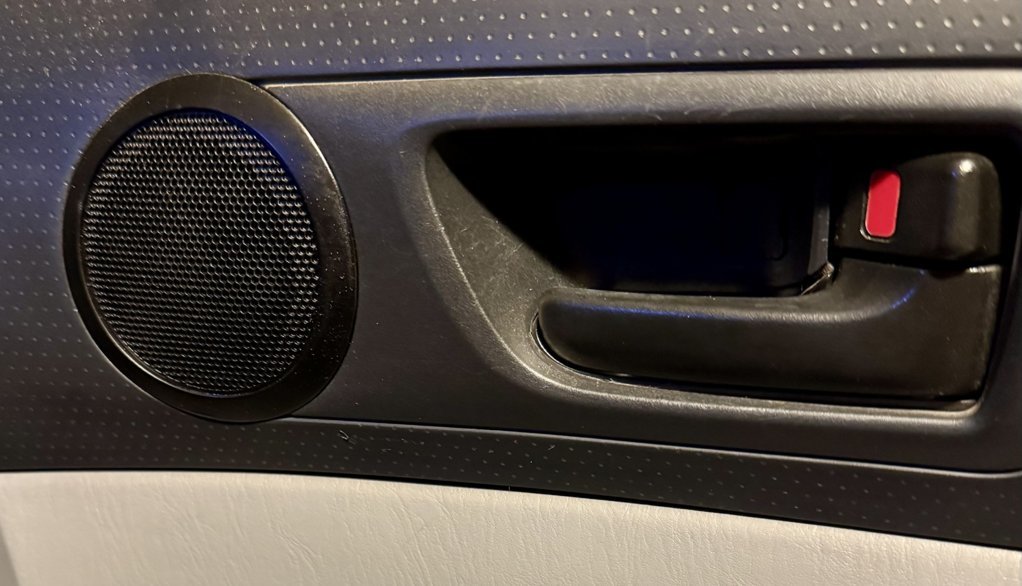

    The Tweeter bezel do you have the part number or did you paint it?

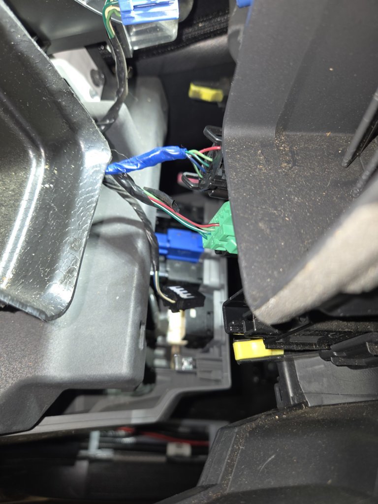

    20250314_121839.jpg Whats good fellow modders? Need some assistance on unplugging the rear diff lock and power inverter plugs to remove my instrument panel trim. I've tried every which way to unplug them but to no avail so far. I was getting hangry and decided to take a break before I go full hulk mode and break something. What's the trick? Or am I just being a Sally?
  19. Mar 14, 2025 at 10:51 AM
    #1599
    nihil
    nihil Well-Known Member
    Jul 25, 2019
    #300220
    89
    Push the plug inward, then depress the tab, then pull out.

    Has to be painted unfortunately
