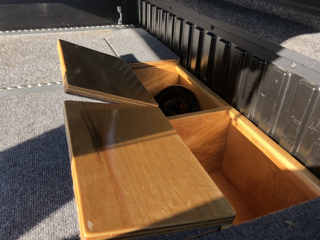

    For the 12" and 15" options I can definitely incorporate small cubbys above the wheel wells however they would only be approximately 3" and 6" deep respectively.​
    • In the design, I don't see any access to the wheel well dead spaces like in the decked system (the four corner cubbys)...as the system is currently, does it allow access to the bed outlet and/or stock bed compartments? Any way that would be possible or useful here to have access to the four corner dead spaces?
    The system does allow access to the the 4 corners however at the end of the bed you currently must reach into the space. I have not currently worked out a way to incorporate top access doors for the rear of the bed however it's coming!
    For long bed owners, top access cubbys will standard on all systems to allow use of space for the void at the front of the wheel wells.​

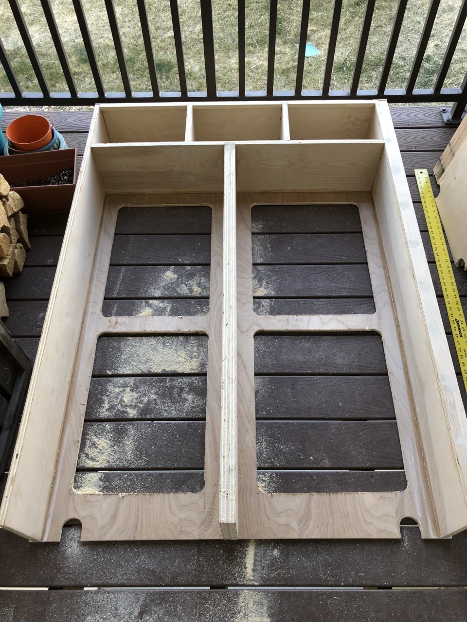

    1/2" Birch Base:
    2 - 48" long drawers with 3 - 13" cubbys:

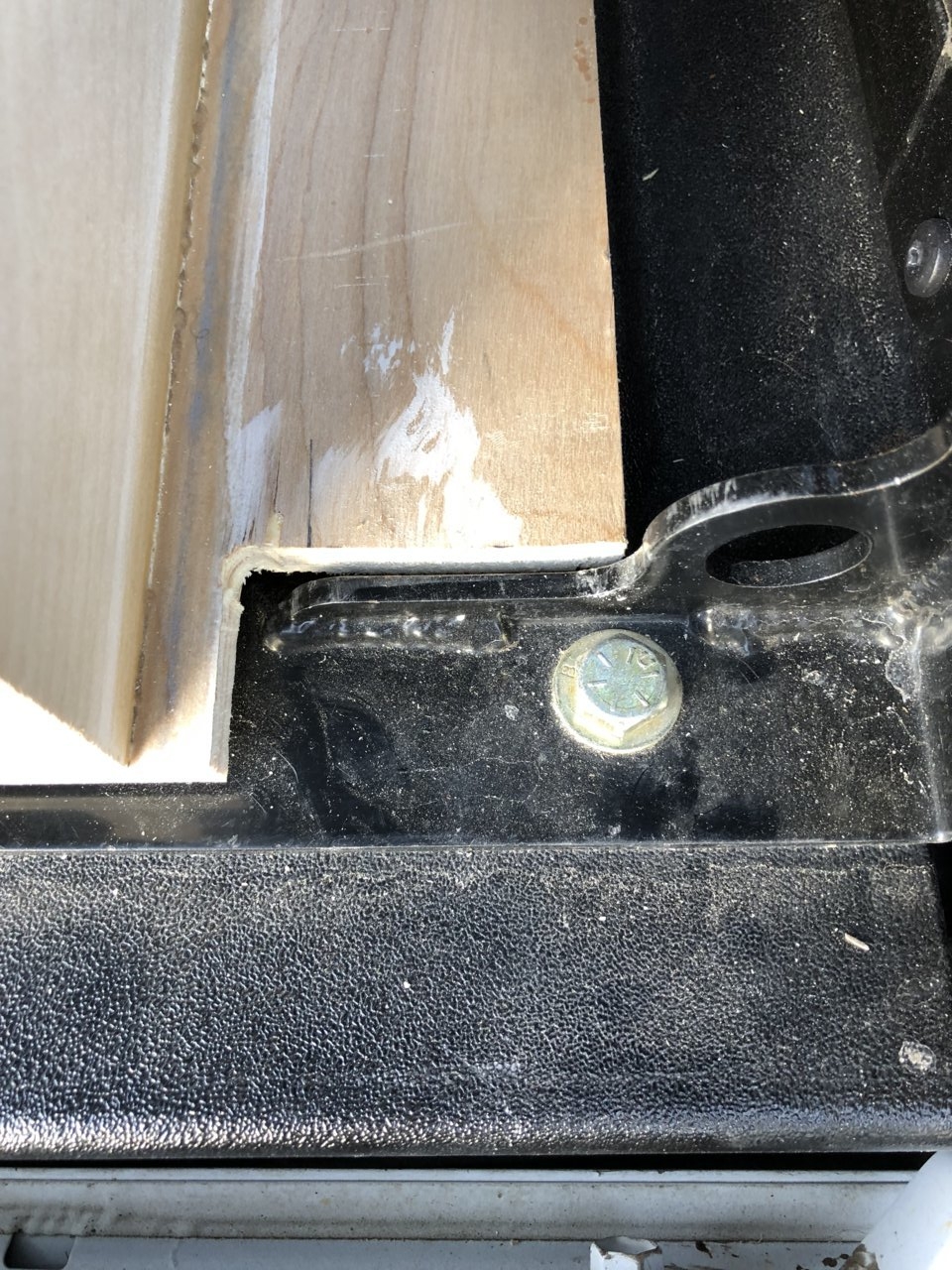

    Custom cuts to account for bed bolts and bed stiffeners:
    Milling out the base for weight reduction:

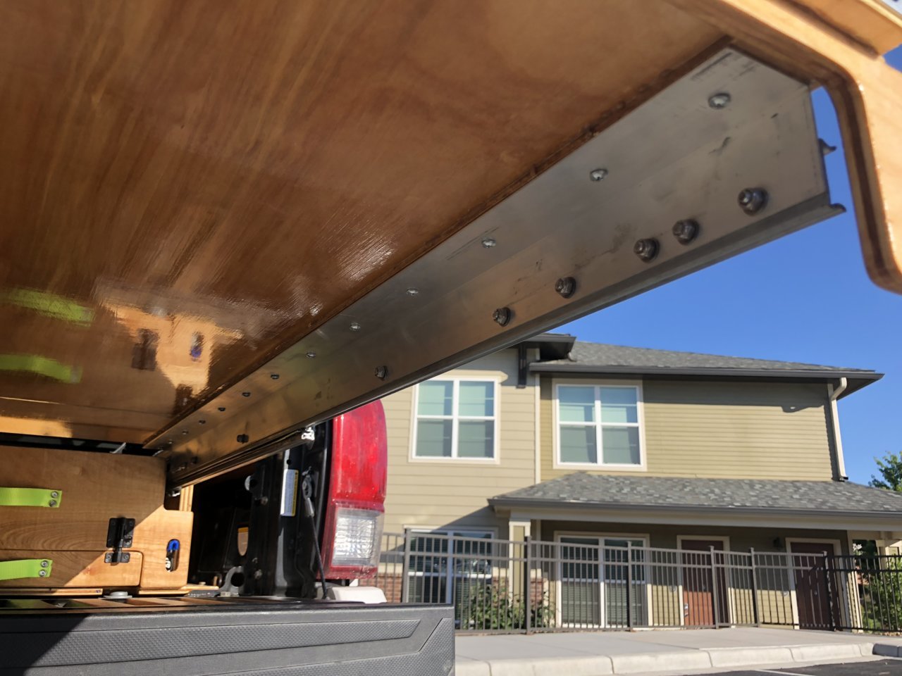

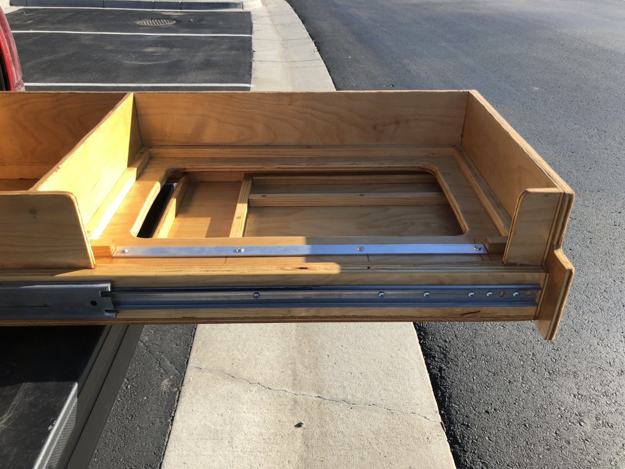

    500 lb slides to support bedslide and kitchen drawer:
    Aluminum angle to allow maximum depth of kitchen drawer:
