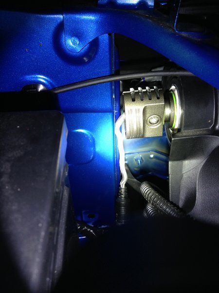

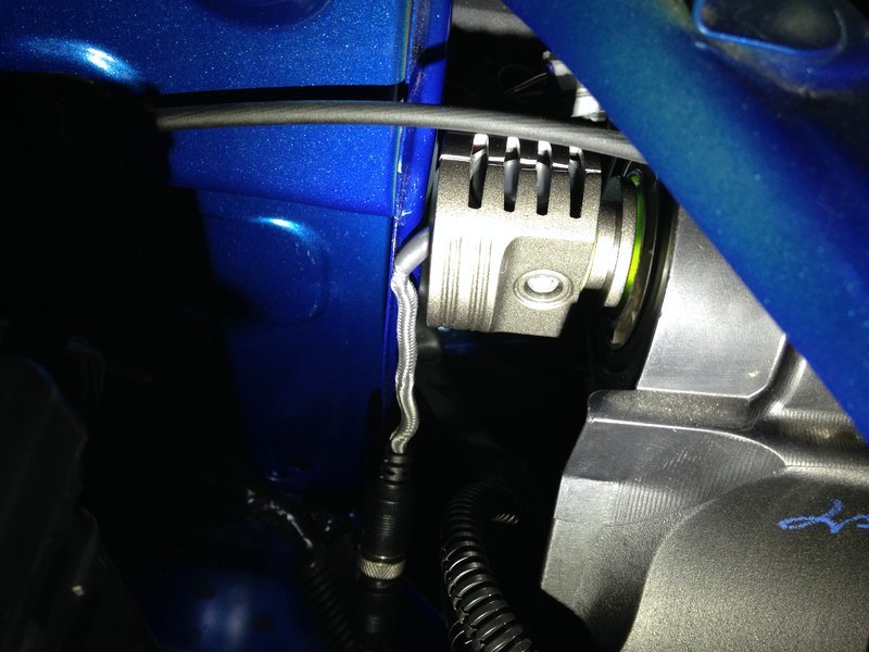

    Hey guys just installed my 2 stroke bulbs. Took me about 30 mins. Blazing Taco is right, you have to loosen and remove the two screws on top of the head light and slightly move the headlight forward. It is a tight fit. Start with the passenger side first. As you insert the bulb, slowly rotate until it falls into place. The driver side is a little harder so take your time, same concept as the passenger side just a little tighter. The only future problem I see is the wire comes out the center of the back of the bulb and rubs directly on the frame of the truck. I used to have the OPT 7 bulbs installed and returned them because the beam pattern faded to soon in front of the truck. 2 Stroke bulbs are a huge improvement with keeping usable light in front of the truck. I also have the Morimoto XB LED fog lights installed. Excellent upgrade, I am happy with this purchase. Both low beam and fog lights are quality products.image.jpgimage.jpg

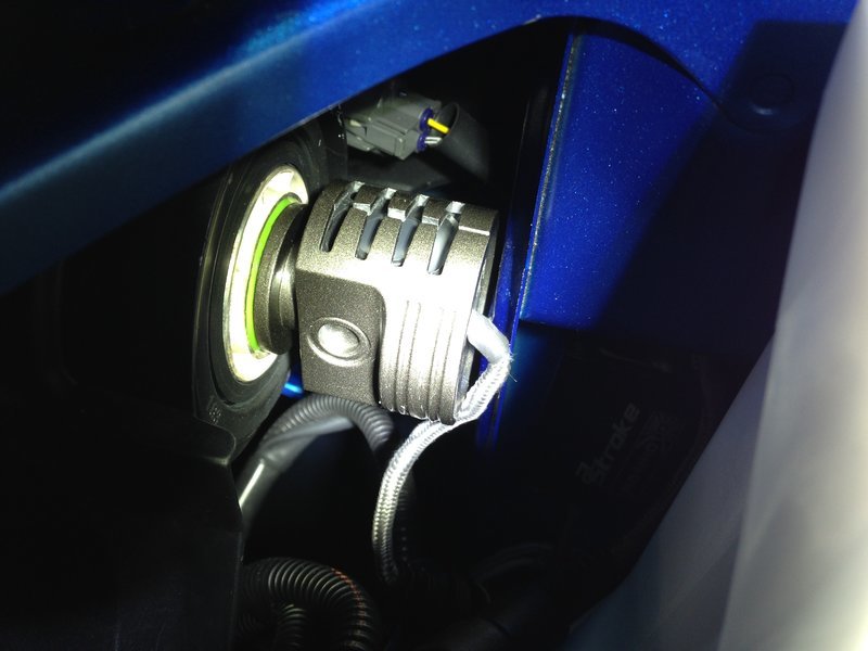

    Nice! I would put something between the wire and fender area. Any output shots?

    Millimeter or two to spare. Daamnnnn! Yeah, looks like I need to break out the split loom to jacket those leads when I install mine.

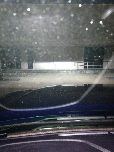

  15. Jul 14, 2016 at 7:44 PM

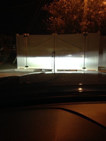

    Brent

    I live in a big city so it's hard to find total darkness, hope these help. I am satisfied with the output.
