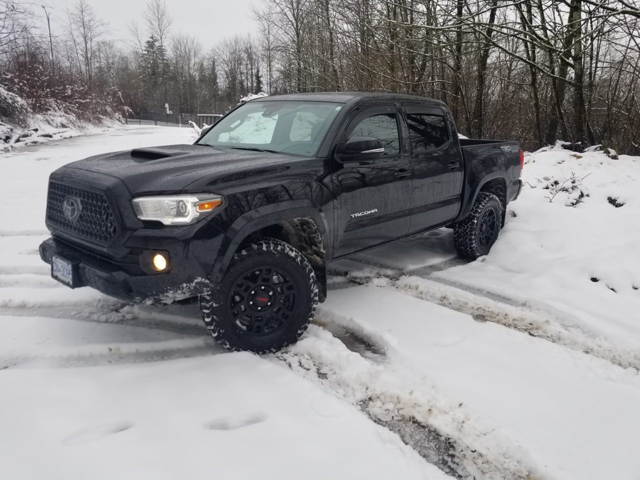

  16. Jan 15, 2020 at 3:06 PM
    #76
    Junkhead
    Junkhead TRDude
    Feb 27, 2019
    #284671
    15,685
    Serge
    Prince George, BC
    Black 4x4 Sport MT 2018
    Some Serious Tires
    Stock size. 265/65/17

  19. Jan 15, 2020 at 6:53 PM
    #79
    J'sBeasTRD
    J'sBeasTRD Well-Known Member
    Jul 20, 2015
    #159922
    331
    Salinas California
    15TACOMATRDOR 4X4DCSB6SPD...
    Truck looks good tho

  20. Jan 15, 2020 at 6:54 PM
    #80
    Junkhead
    Junkhead TRDude
    Feb 27, 2019
    #284671
    15,685
    Serge
    Prince George, BC
    Some Serious Tires
    Thank you sir, i love it.
