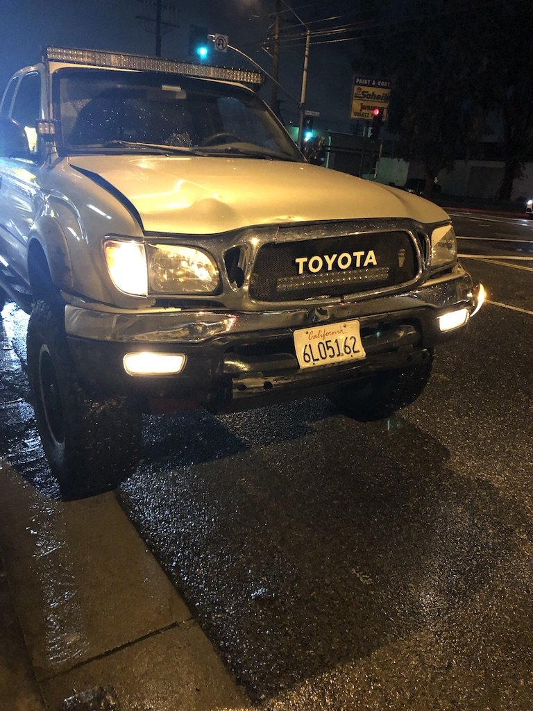

    My condenser broke when I crashed so I had to get a new one and have the refrigerant recharged. I did weld the core and apron back on. I did head of someone Bolting it back together but I preferred to just reweld all of the appt weeds.

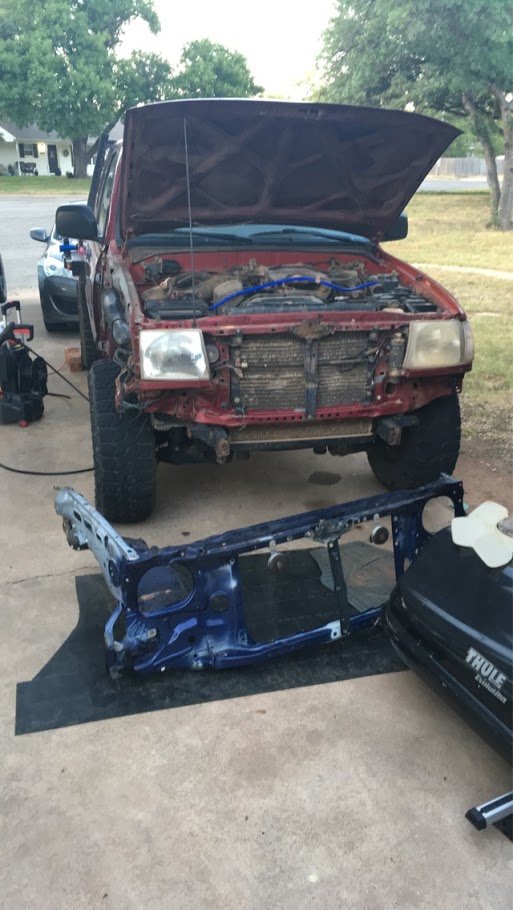

    Hate to bump this older thread but this is one of the most informative threads on the subject. I'm repairing a truck that hasn't really been in a bad collision. It's core support and passenger body mount have just taken animal after animal hits under the previous owner. Running no front bumper tends to do that.
    My main question is about the spot weld removal on the fender apron. If I center my cutter well I should be able to just drill out the fender apron and not into the body. Then when I go pull a apron/core support from a yard this weekend I should be able to get the apron out without pulling the dash right? Like pulling the dash is just necessary when welding everything back? And to access most of those fender apron spot welds I'll need to wire wheel some seam sealer it looks like.

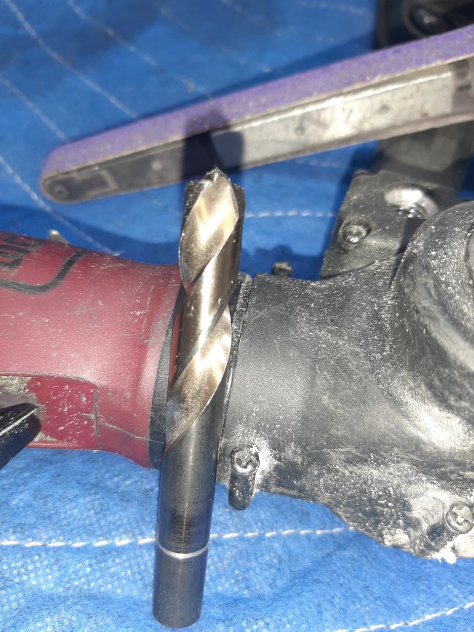

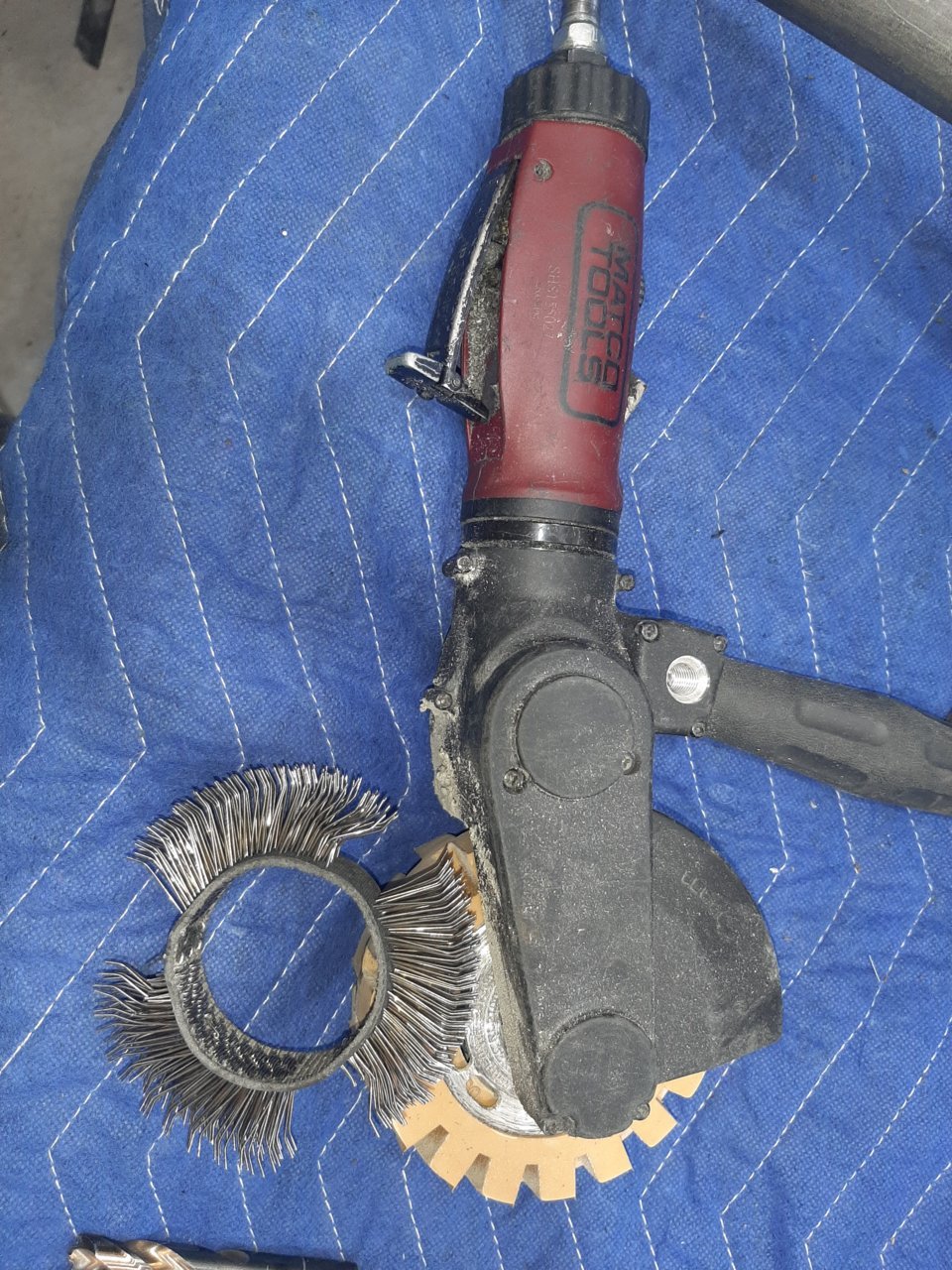

    As far as tools, they are more expensive but make the job much easier. I'll show you what I'd use to do that job. I've been in the industry since 05 and done quite a few aprons on Tacoma's.
    The wire wheel interchanges with an eraser wheel, Kent Automotive makes a decent spot weld bit, you wont need a boron or any specialty bit. Regular spot weld bit, I'd avoid the cheap hole saw style. They are terrible. The belt sander is good for hard to reach areas, I tend to grind most of my welds rather than drilling.
    Another piece of advice is to make a scribe mark around the pieces you are cutting off. It will help you line up the new part faster. Then screw it all together with self tappers and fit your parts before welding.
