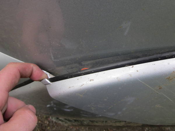

    does anyone know how to fix this clip thing for the fender???

    Is the area on the fender flare broken or is it the clip? I slid into a pole this winter and snapped some clips and ruined the fender flare side also.

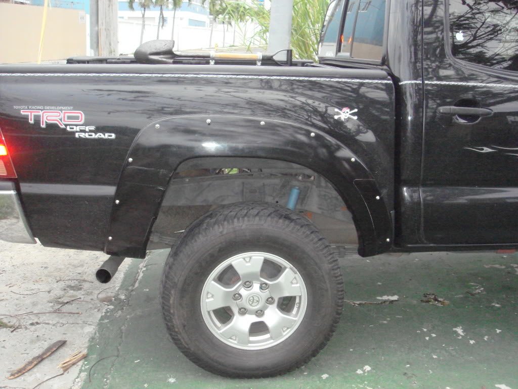

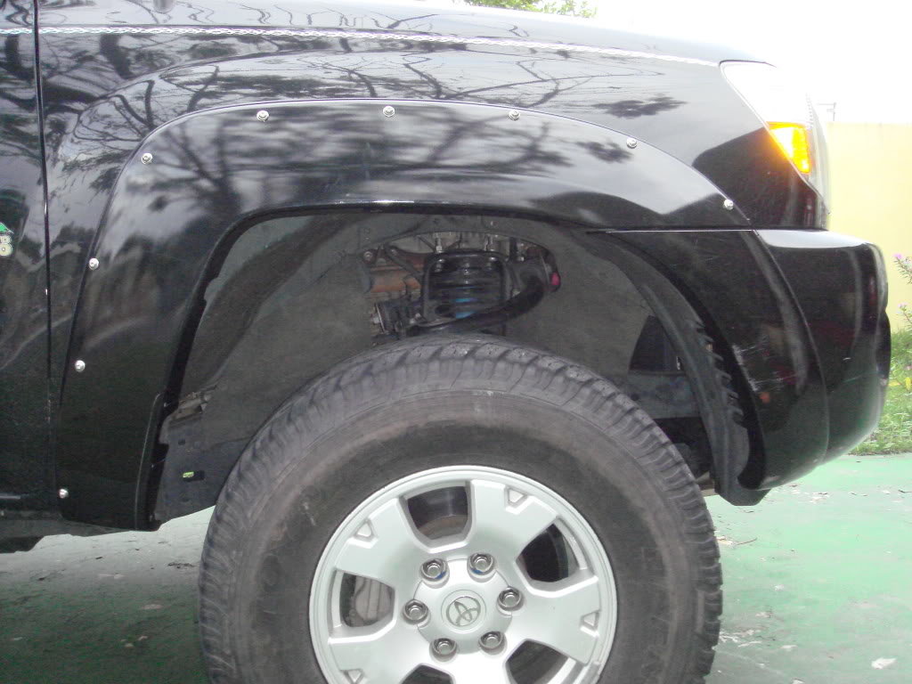

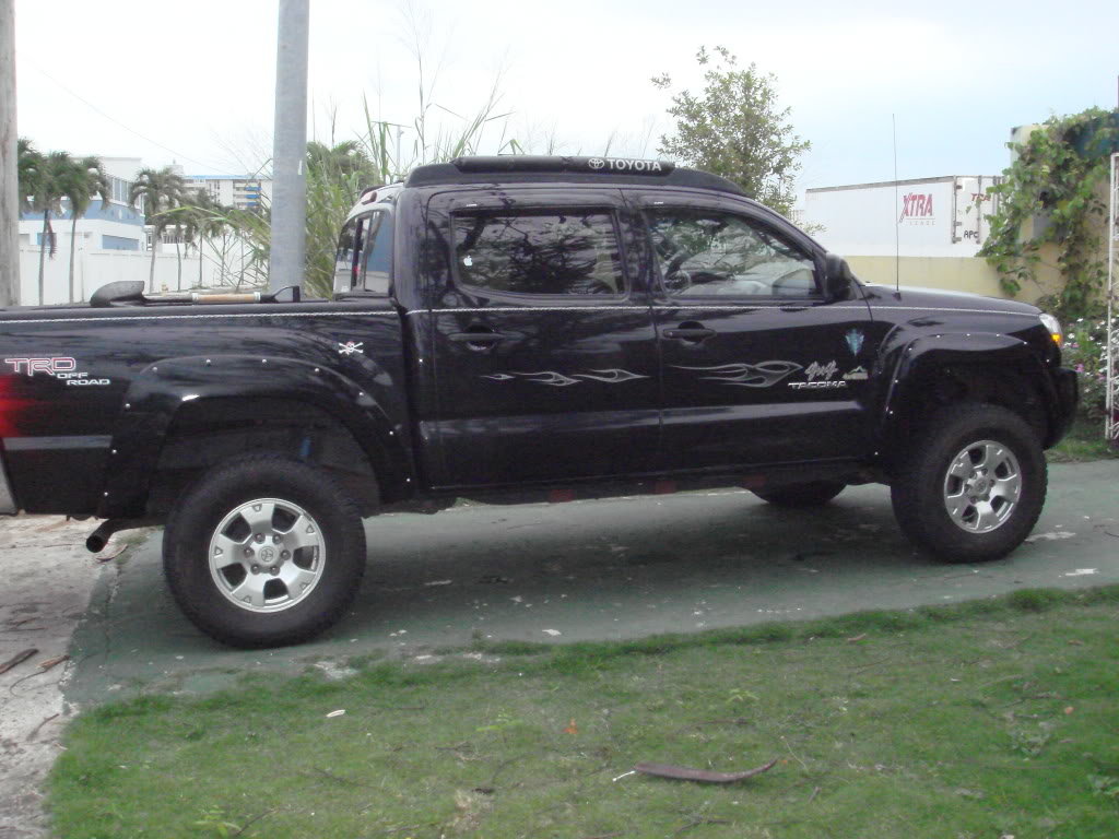

    Ditch the clips and bolt the flare to the fender with SS hardware, guaranteed to hold to the fender for good, if you rip the flare off, the fender will need replacement for sure:D:D
    These has been replaced with bigger washers, since the ones shown here were plated an rusted bad, new ones are SS.
    Pics of the new ones later

    Make sure you get the right one.
    Right one meaning if its a blue clip get blue, orange gets orange. There is 2 different ones and they go in different spots.
    real easy to replace tho.
    i will see if i can find the paper i have that states which clip goes where, then try to scan it and post it here later.
