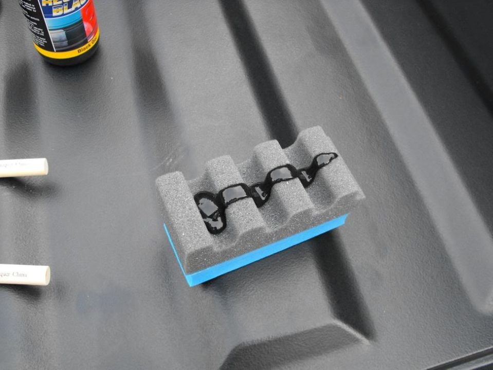

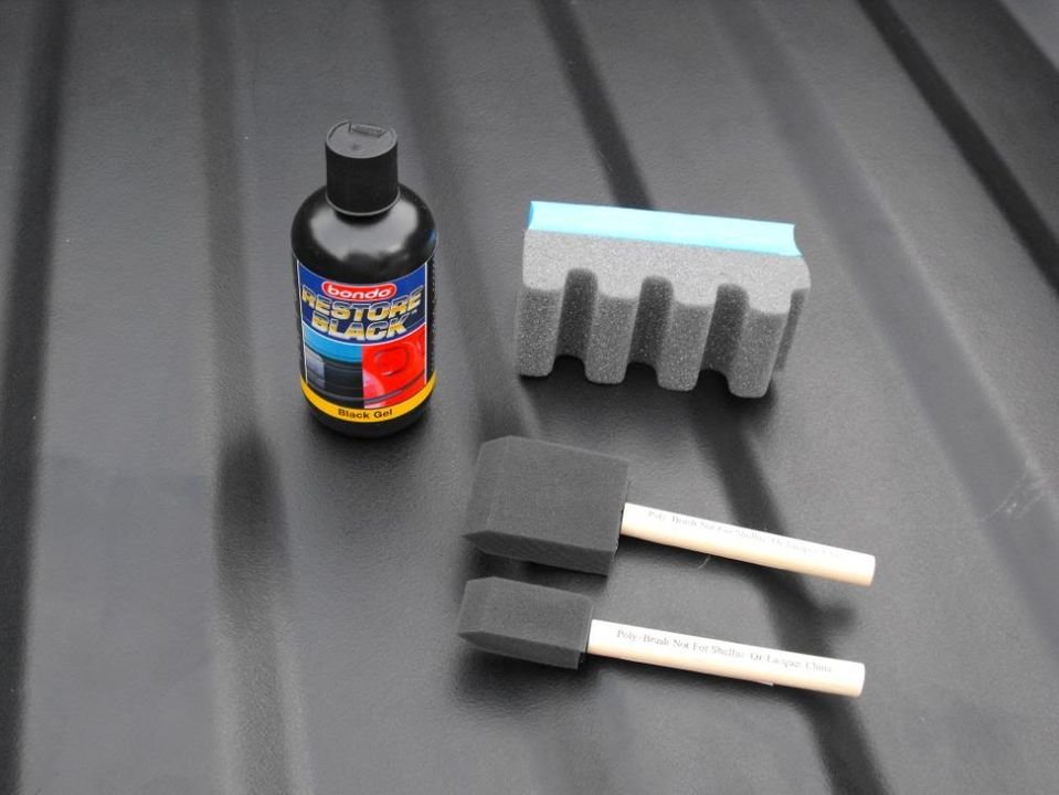

    Looks like a product that I've used on composite beds now named 3M Restore Black with a bottle of cleaner. It works like gel shoe polish. Relatively easy to apply with a foam paddle. Lasts about 6 months. I think auto parts stores still sell Restore Black. The packaging is different from the bottle in the picture.
    While it worked well for a composite bed, I would be disappointed with a product that requires reapplication for wheel flares and bumper. I expect a treatment to last 10 years with periodic detailing using a product like 303.

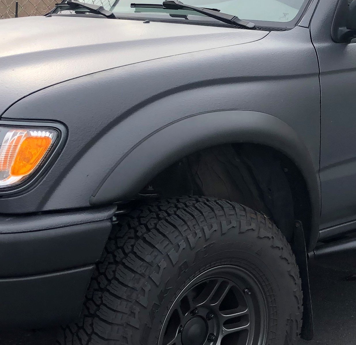

    If you want a permanent solution remove them and take them to your local Line-X or Rhyno Liner dealer and for around $100 it's done and done. Wont chip or peal, doesn't fade, UV-X built in and comes with a lifetime warranty.

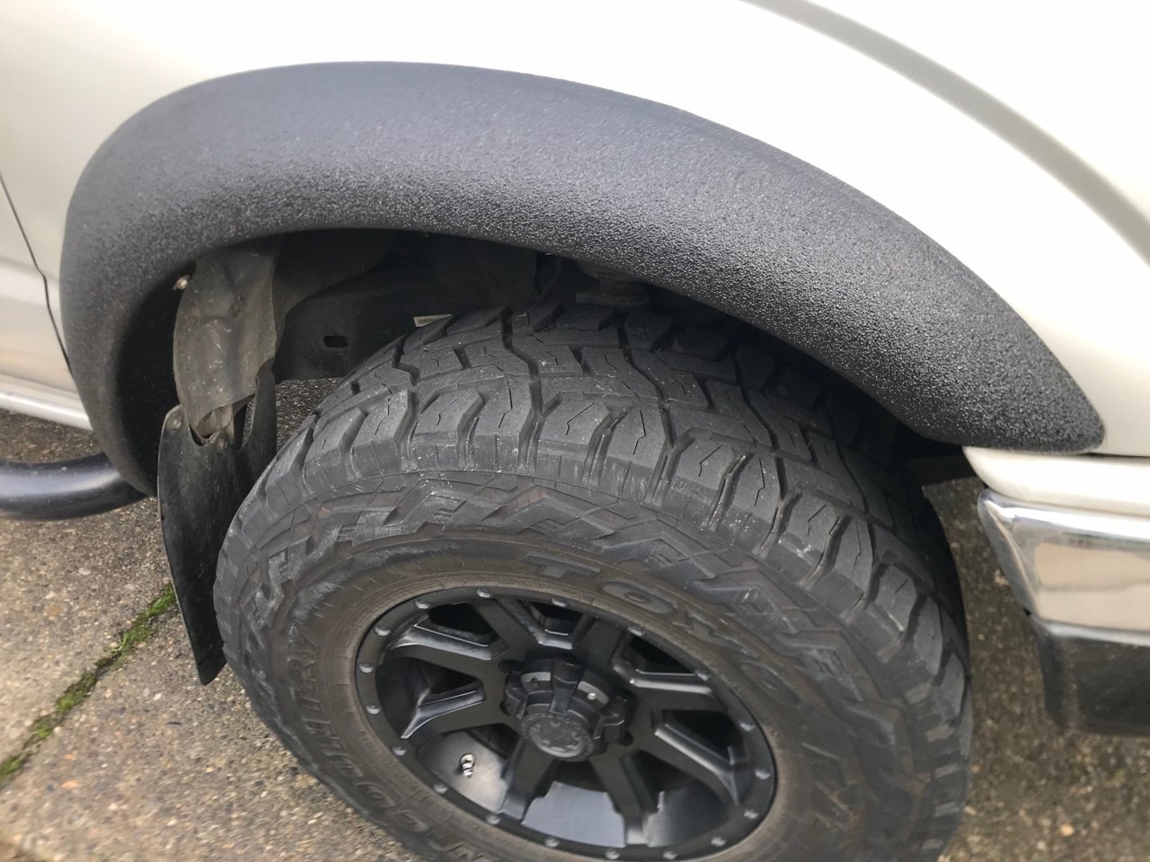

    Like others, I tried the heat gun, but it didn’t last. I finally just pulled them, sanded, and re-sprayed them truck bed coating. Huge (YUUUGE) improvement.

    I just got a quote from Rhino, $250 for the four flares. I'm considering pulling the trigger and getting it done.

    I don't wax, and have had a Rhino bed liner in since ... geez getting old, probably 2004?, but thanks for the heads up. On the bed itself I use the Rhino Shine when it starts to fade, this is only after years of wear and tear on the bed, I don't expect do be doing this anytime soon on the flares.
    This was Rhino Lining Vancouver Washington, $250. The finish is just about perfect. The guy suggested he spray the fender rubber molding gasket too. This looks great, but resulted in very minor imperfections on the fit. I'll post another picture when it's not raining. I did have to purchase new fender clips from Amazon. Overall very happy with the result.
