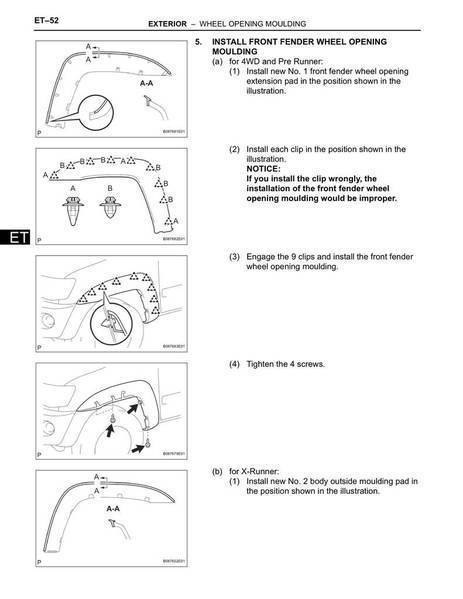

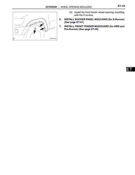

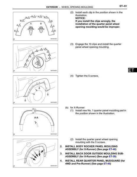

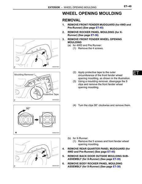

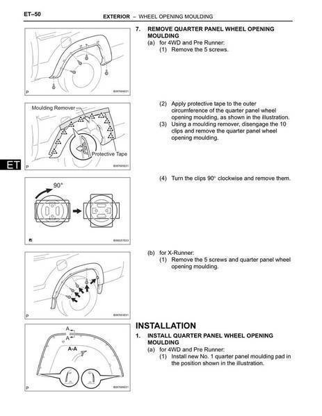

    Are the flares held on by clips through the body(fender/bedside) or are they held on by bolts through the under lip by the fender liner?....I noticed that the reg cag non prerunner doesn't have flares...just wondering...

    It looks to me like they are just clipped on by plastic clips...
    Take a look at this...

    Yep just had one replaced 5 clips on each of the rear ones, dont know about the fronts

    Clips. Click my "how to wire bed lamps" link in my sig, look at the 11th picture down on the first page... i cant get the pic to copy over for some reason.

    front flares: 7 blue clips
    2 orange clips
    rear flares: 8 blue clips
    2 orange clips
