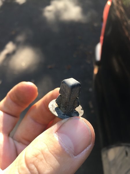

    ***UPDATED*** Original post below, but here's what i found out:
    To remove the liners, you don't have to pull the flares. In fact, if you are going to remove the flares you really should pull the liner out first so you don't have to struggle to pop the little clips that hold the flare in place.
    1. remove 6 (i think there's 6) bolts that sandwich the liner between the flare and the fender. (and hold the flare on) Two are at the very bottom - one each side - and may be unnecessary, the rest are in the arch.
    2. pop out the two barbed fasteners in the top of the liner. If you break them, I found these work: https://www.amazon.com/gp/product/B01BA7T296
    3. remove the 6 or 8 square-bodied round-headed grommets shown below. Good luck, they're stubborn. Like I said, i resorted to just cutting them off. You can get them from Amazon for about $.50/ea. (i was able to get about 1/2 out without damage, but what a pain!) https://www.amazon.com/gp/product/B0040CX5I8/ It turns out there is a tool for doing this, it's a pry bar with a round head... i used something similar and the head often just deformed. I wouldn't get the tool. I'd make sure you have nippers.
    4. At this point the liner should be easy to pull out.
    If you do have to pull on the flares a bit to get the grommets out, be careful! I snapped two of the parts of the flare that the little retention clips mount to. Glue holding great (also, see below)

    I'm trying to mount some stuff in the bed... Need to remove the fender liners. Lots of searching hasn't resulted in much help... There are these damn Toyota Fender Grommets holding the fender liner in place:
    Might have been misguided, but i thought the flare needed to come off too, popped two of the little features that capture the body clips, so those are now curing... hope the epoxy holds.
    /grrrrr/
    Now i realize i can probably get the liner out without taking off the flare, but anyone have a tip for popping off those things? I tried using pliers and a 10mm box wrench to hold the barbs in while prying, pushing, wiggling, and swearing, but ended up resorting to just clipping them with dikes. Best thing i found searching was "those things made me curse and throw tools." Har. Hoping if someone has the silver bullet they'll share, otherwise, join the bitch-fest...

    Having just done it, it's fresh in my mind. You don't have to pull the flares. In fact, if you are going to remove the flares you really should pull the liner out first so you don't have to struggle to pop the little clips that hold the flare in place.
    1. remove 6 (i think there's 6) bolts that sandwich the liner between the flare and the fender. (and hold the flare on) Two are at the very bottom and may be unnecessary, the rest are in the arch.
    2. pop out teh two barbed fasteners in the top of the liner.
    3. remove the 6 or 8 square-bodied round-headed grommets that look like the thing in the first post. Good luck, they're stubborn. Like I said, i resorted to just cutting them off. You can get them from Amazon for about $.50/ea. (i was able to get about 1/2 out without damage, but what a pain!)
    4. liner should be easy to pull out.

    Haven't tried the fronts yet but I removed the rear well grommets with a pair of channel locks to squeeze the side tabs and a small socket handle to push them through. On some awkwardly placed ones I used a flat blade screwdriver to push the tabs one at a time while prying out on the grommet with a piece of plastic or wood shim(anything that won't scratch the paint).
