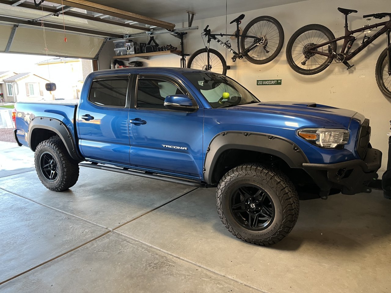

    I’ve searched the best I could but see very little information on this . So with cutting up the bumpers and putting aftermarket bumpers or viper cuts and fender trimming. There’s a lot of space for water and mud to get in the engine compartment. Does anybody know of a solution for this. Does anybody make aftermarket fender inserts? Apologies if there’s been a thread on this, I just couldn’t find it…

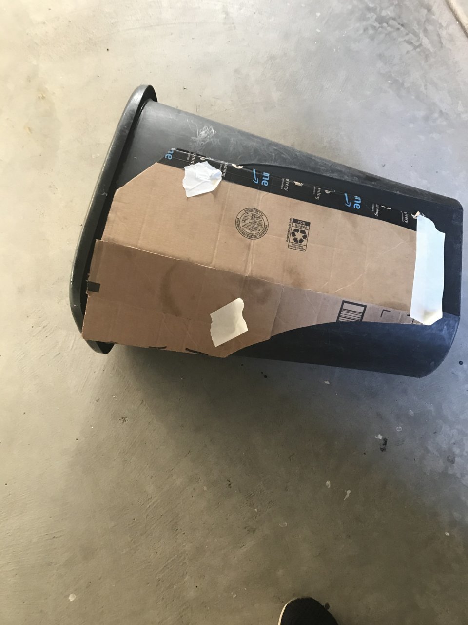

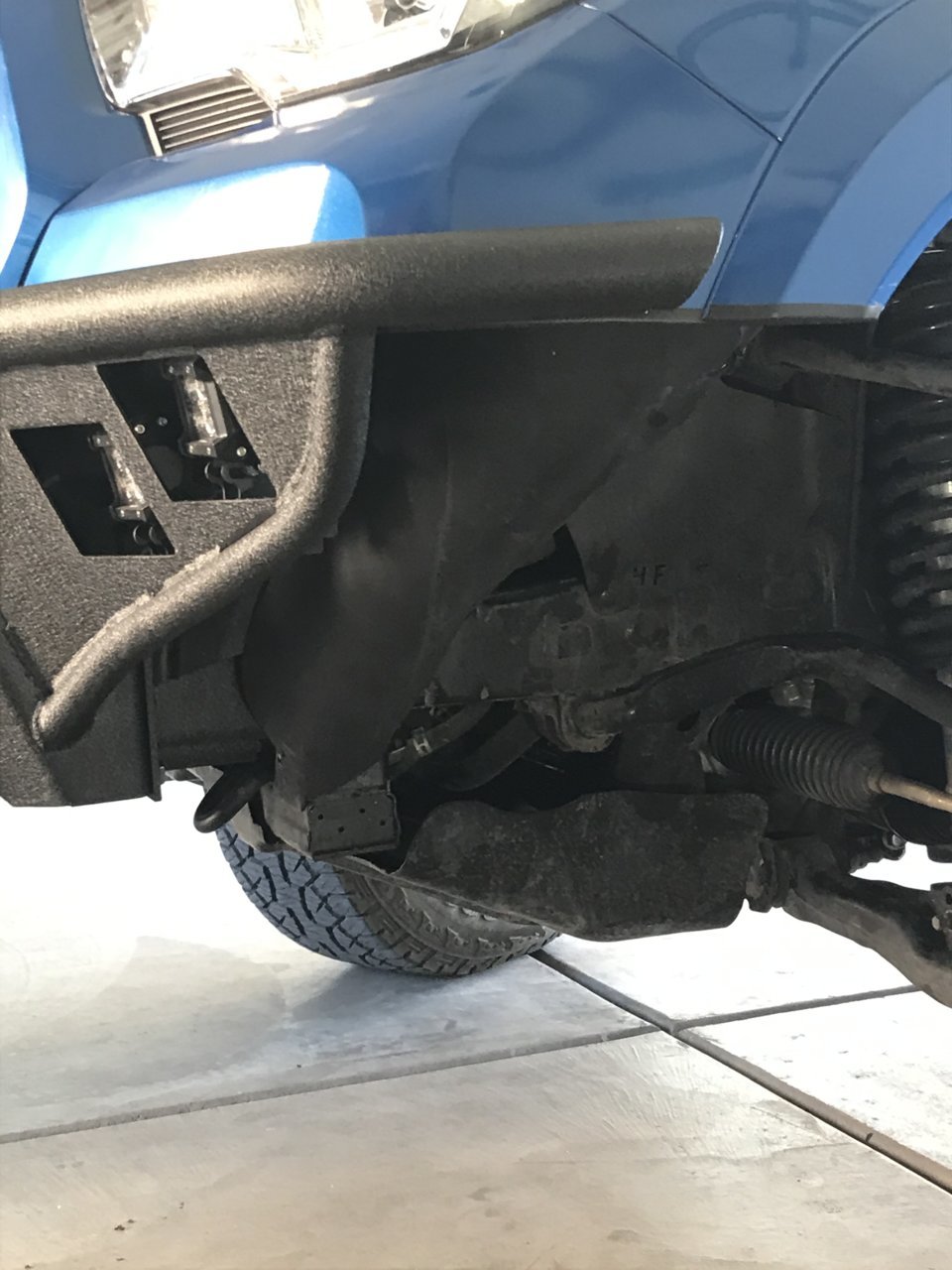

    I made mine out of an old plastic trash can. I used cardboard to make a template and I used a heat gun to help shape the plastic. They have been on there for a couple of years now and are still holding up. I attached them with zip ties through drilled holes here and there.

    Here's how they turned out.
