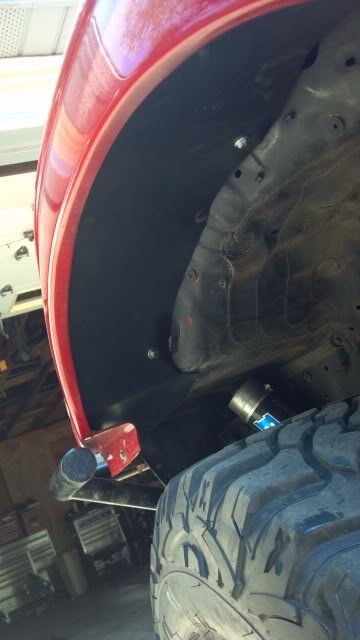

    heres a shot of mine that i just did a month or so ago... I used a sheet of uhmw plastic , bent some autofab tabs and pop rivited those where needed,i first made cardboard templates to get the right arch and fit.. there not bad to do maybe a couple hours on the first one then youll have it dialed

    Wow that looks great. How did you actually shape it?

    The product is only 1/8 th thick so it arches pretty easy, just takes some time to get the final fit before you put the fasteners on the sheetmetal... hope this helps!!!;)

    Huh interesting. Maybe I'll order some of that then

    Nice dude! That looks super clean
