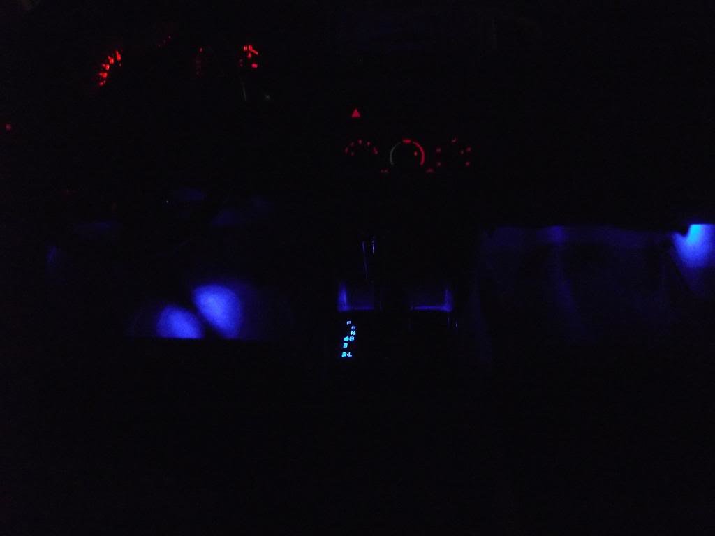

    Well, I finally got started on swapping my interior lights, and added some lighting where I didn't have any before.
    The Tacoma, like my 4Runner... had some details that were left out, during production. I felt like it could use some extra lighting, since the glove box and center console had none, which made things a little hard to see at night.

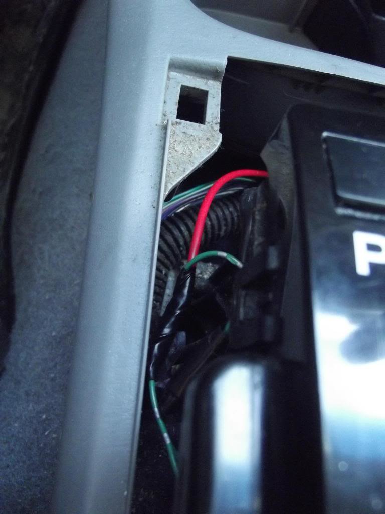

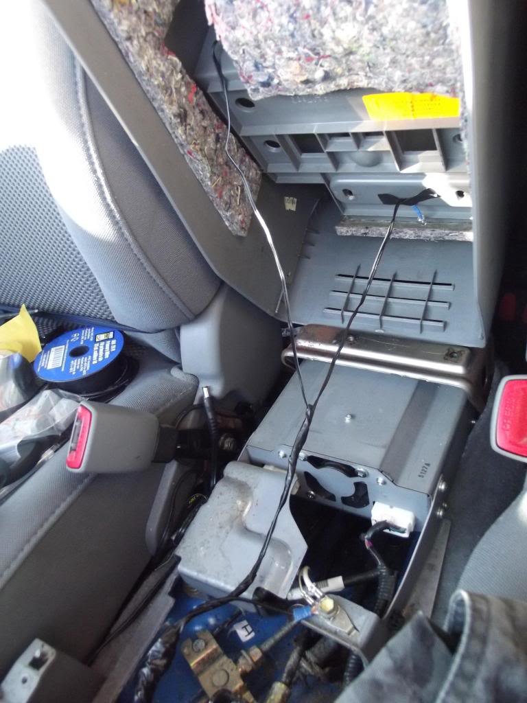

    First thing I did was run some power and ground wires in the center console, so I can splice into them, and add my 5mm LED lights.
    I ran power from the shift light, and grounded the entire project using the same ground already being utilized in that area. (a shot of the ground in the pic showing the vent LED location)

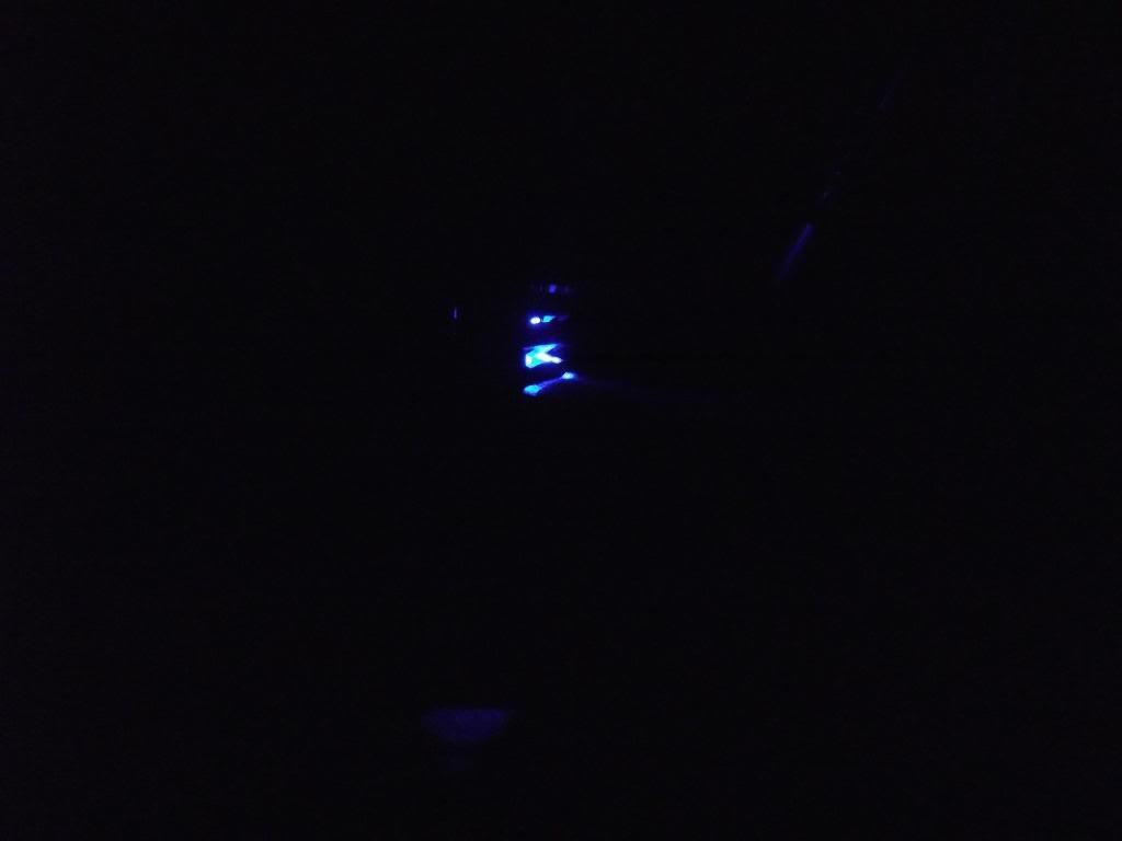

    Then I ran one LED to the back of the center console to the rear vent area, and another to the inside of the console:
    Here's a shot of the vent area at night:
    Here's a shot of the center console:

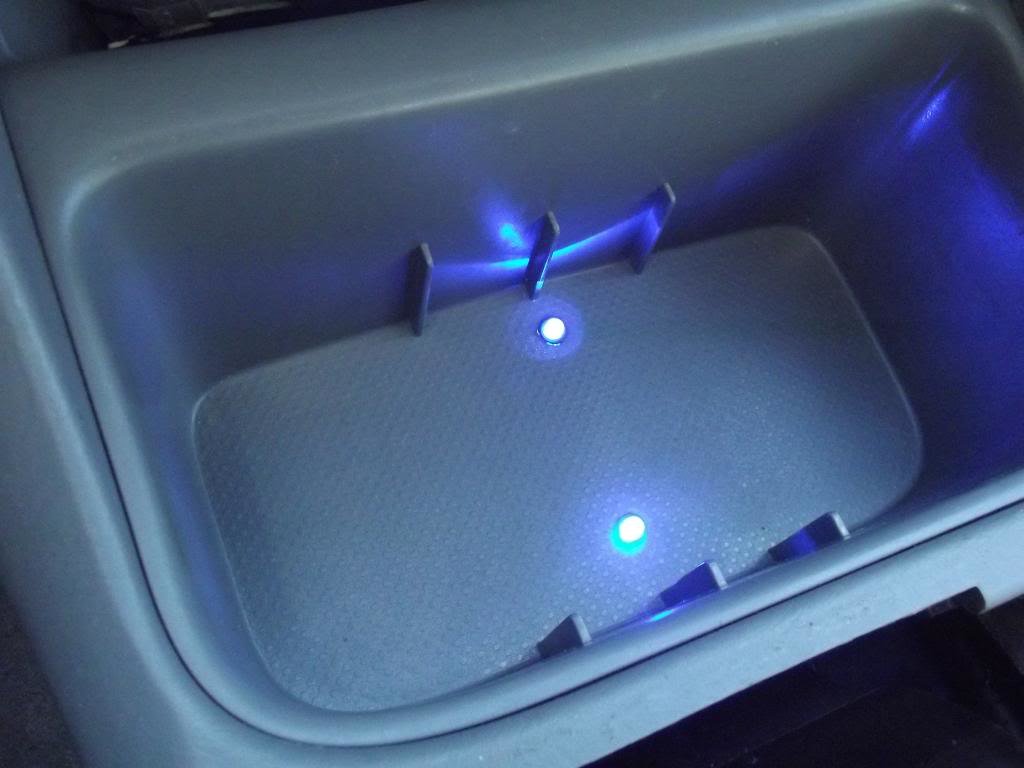

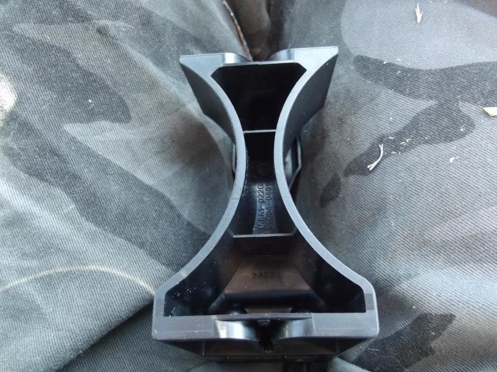

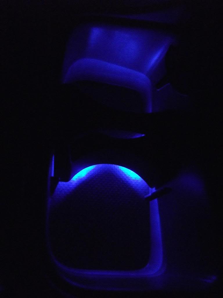

    Then I decided to run 2 LED's to the front cupholder area:
    (Note the little black grommets... they are actually called LED holders... I got 50 of them for around a dollar on E-bay).
    Here's a day shot of them installed:

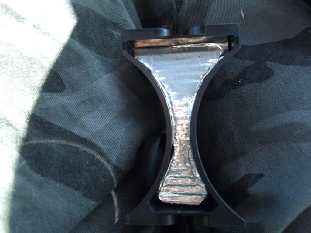

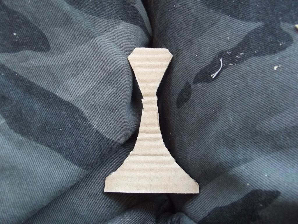

    I wanted them to be concealed, so I located them beneath the cupholder divider. The only problem with this, is the light output wasn't that great, so I modified the underside of the divider, so it would reflect the light a little more.
    I used some mirror tape and cardboard to make the reflector:
    Here's the finished product....

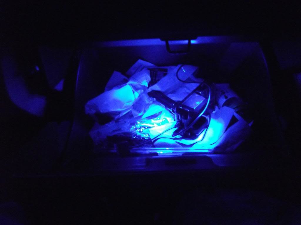

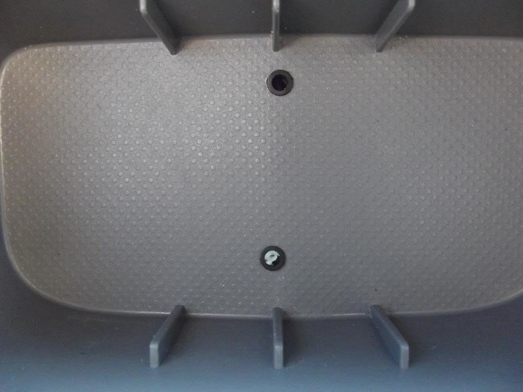

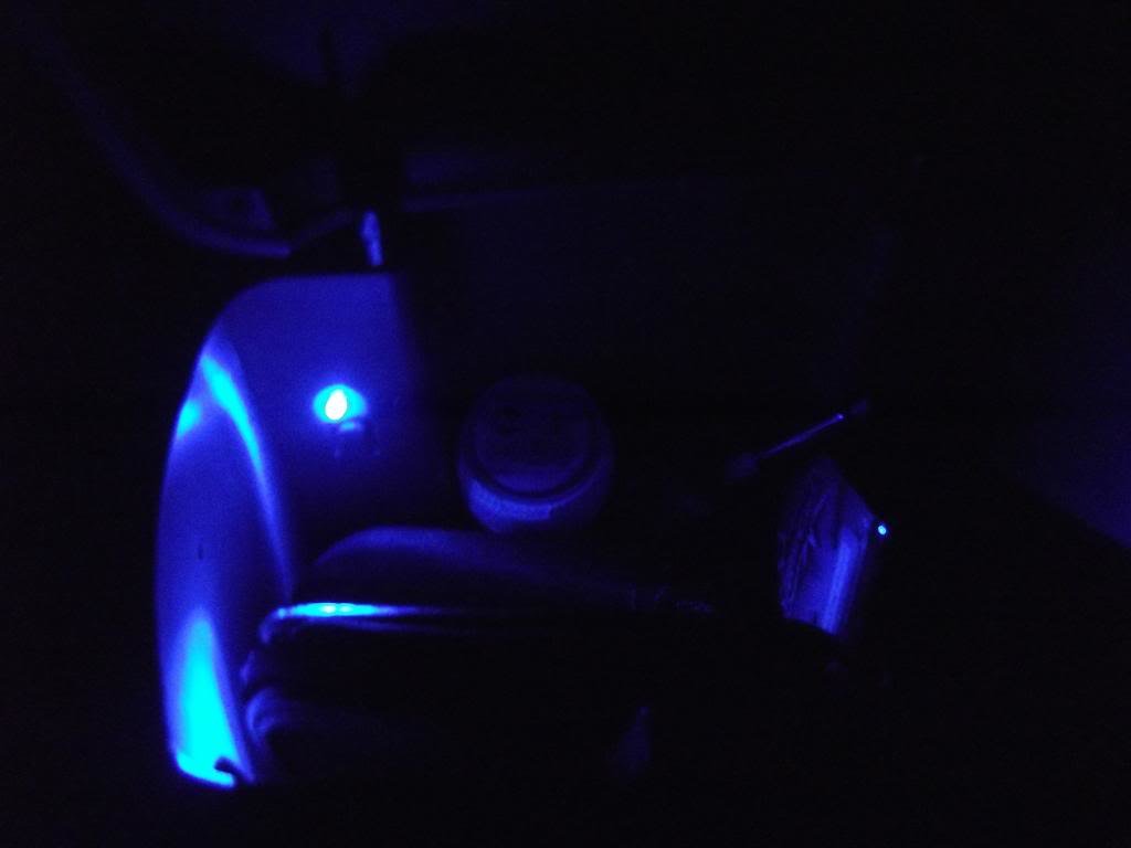

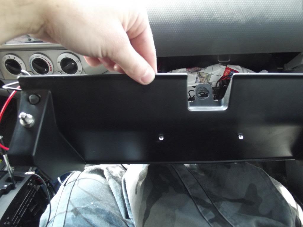

    Next, I ran 2 more to the glove box area.... really ticked me off that a $30,000 + pickup truck didn't have a glove box light! lol!
    First thing I did was drill out 2 holes for the LED's on both sides of the latch cut out and one for the contact switch.
    And a night shot:
    Next... I had 2 more LED's left from the pack I bought at Walmart... so I decided to add some foot well lights! :D
    You'll notice I swapped the shifter light too.... I simply used one of the spare LED's I had left over from the 4Runner's LED swap... same 74 Wedge as the 4Runner.

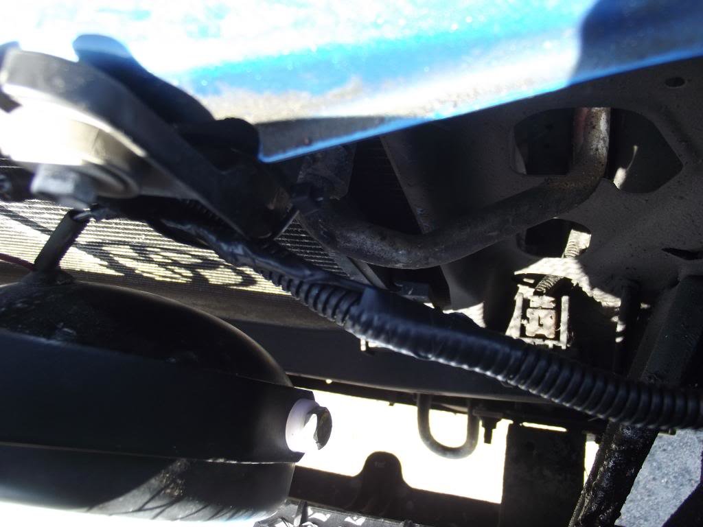

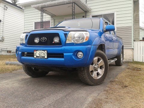

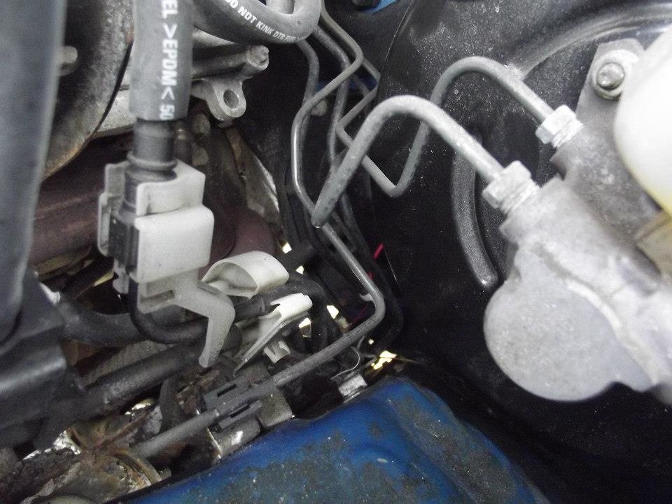

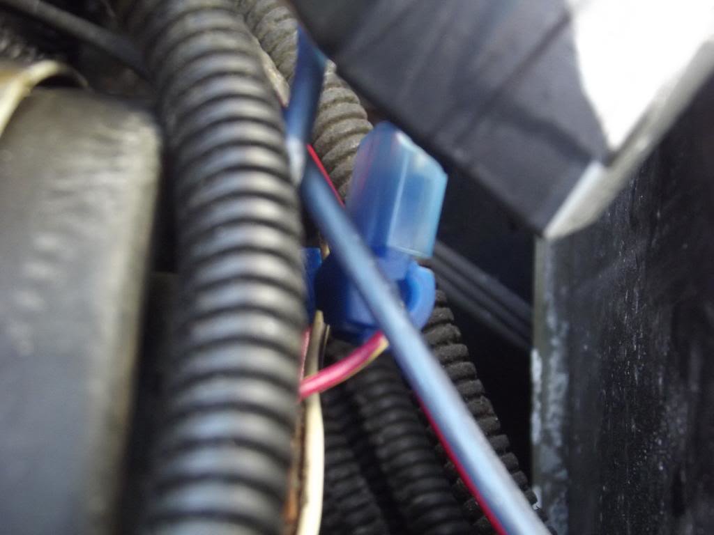

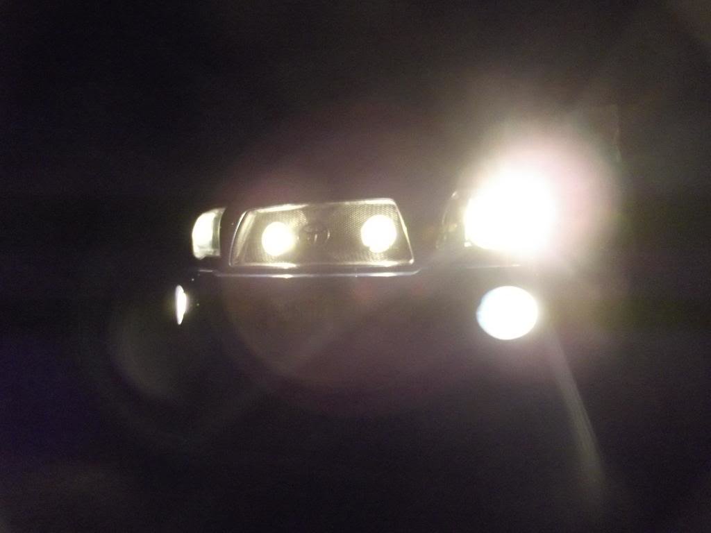

    Well, finally got around to wiring the grill lights, with the help of a friend. "The help of a friend"?? YUP!
    You see... I didn't want to run it to a toggle or rocker switch in the dash... so I had a friend of mine help me hook it up to my stock switch!
    The key to doing it, is to tap into the power wire on the back of the headlight housing plug and then running all the other wires to a relay with a fusible link for the constant power wire from the battery. Here's a shot of the T-tap into the power wire:
    I cleaned up all the wiring with some Wire loom...
    A night shot:
    I'd give more detail about this... but I'm no Electrical scientist... and my buddy Lee is the guy who really knows all the details for this one... lol!

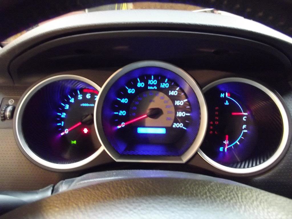

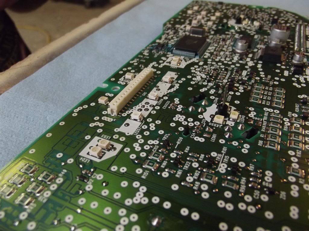

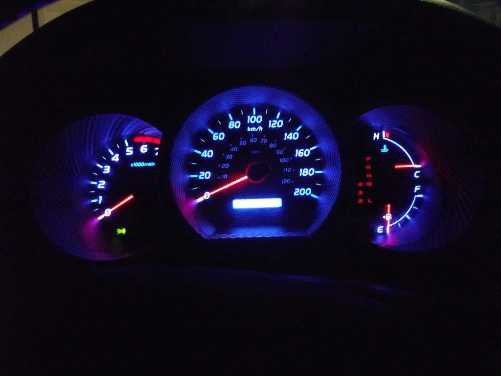

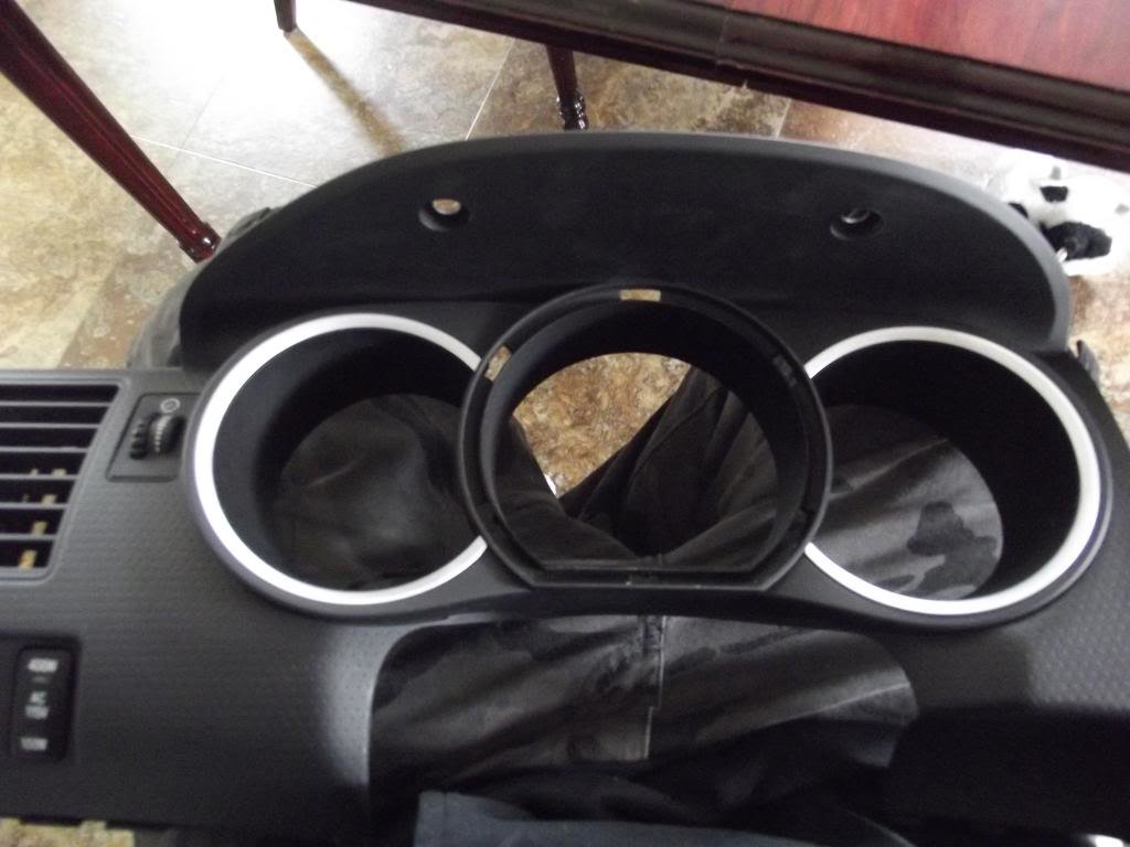

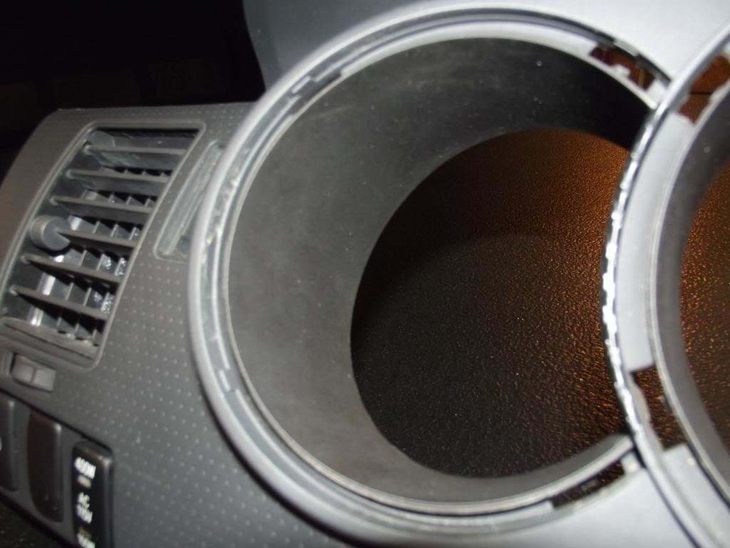

    Well, I got my order from Oznium.com the other day, and after canvasing some friends on Facebook, I got a volunteer to Solder the Surface Mount LED's into my gauge cluster! :)

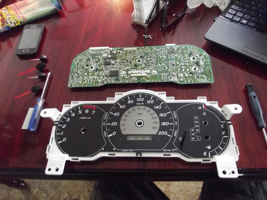

    First thing I did, was take the gauge cluster out, and take it all apart.

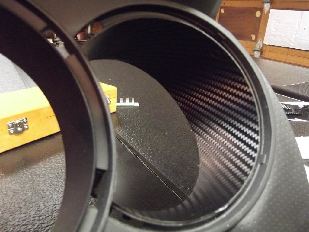

    Then decided, since I had the whole cluster apart, why not mod the pods with some Carbon Fibre Wrap! :D So I took the trim rings out....

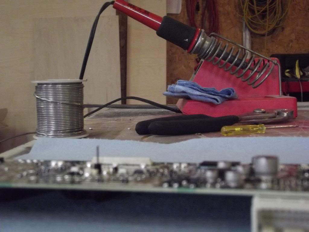

    Closeup of the Gauge Cluster Circuit Board, and the TINY LED's that were replaced!
    The master at work!
    Tools of the trade:
    Before shot, without the carbon fibre...
    After:
    Dayshot with the Carbon Fibre and Blue lighting:

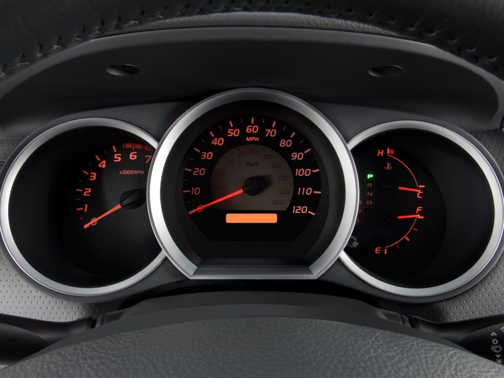

    Not my pic... but here's one of the stock setup:
    2010-toyota-tacoma-2wd-access-i4-mt-natl_9993f0793451c3542748606c94eae61ce6b96173.jpg
    Night shot!
    I freakin love it! Much nicer than the stock Orange lighting! :D

    Basically, the LED'S are super tiny surface mount lights, that have to be de-soldered from the board and replaced, and re-soldered into place. This is a skill, I do NOT possess, and was happy that I had someone who could do them for me. Jerez offers this service at a fee, and I believe he does a great job at doing so!
    Also, another point to mention, is when taking apart the cluster, the needles can be removed by simply pulling on them. Make note of their position when the truck is turned off, as it will be necessary to put them back in that position when your are ready to put it back together.
    When taking apart the cluster, you will need to remove the ODOMETER in order to separate the board from the white gauge surround. To do this, you will need to use a small flat screw driver, and GENTLY pry up on the odometer, from one side to the other, until the pins pull out of the board. This is a little scary, but is farely easy to do, once you know how to do it.

    Wait your gas and temp needles sit like that when off?
    They have to sit lower past the E and C
    But looks good!!!

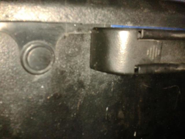

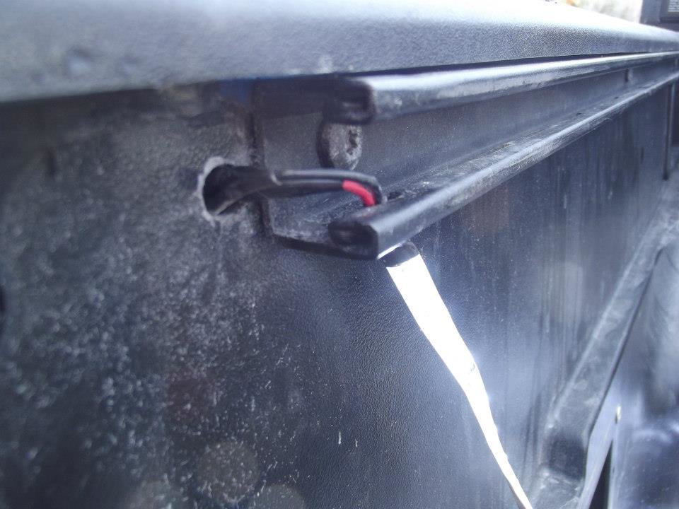

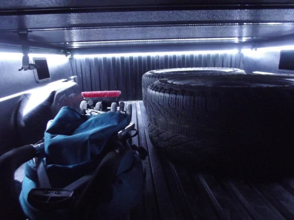

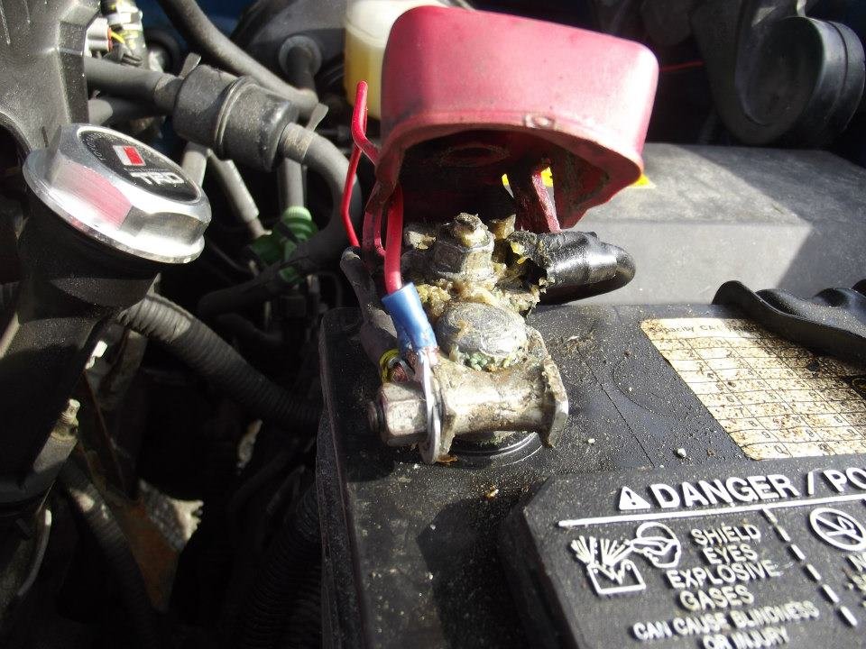

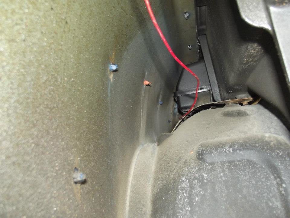

    Alright! So, after many months of procrastination, I decided to get my bed lights wired up!
    First thing I did, was research the crap out of this mod.... and decided to put my own twist on it. Most guys, have used a toggle, or some kind a water proof switch, which they mounted in the bed. I opted to go a different route, and went with a contact switch! :) This way, when the tail gate is down, the lights turn on!
    Here's some pics of today's work:

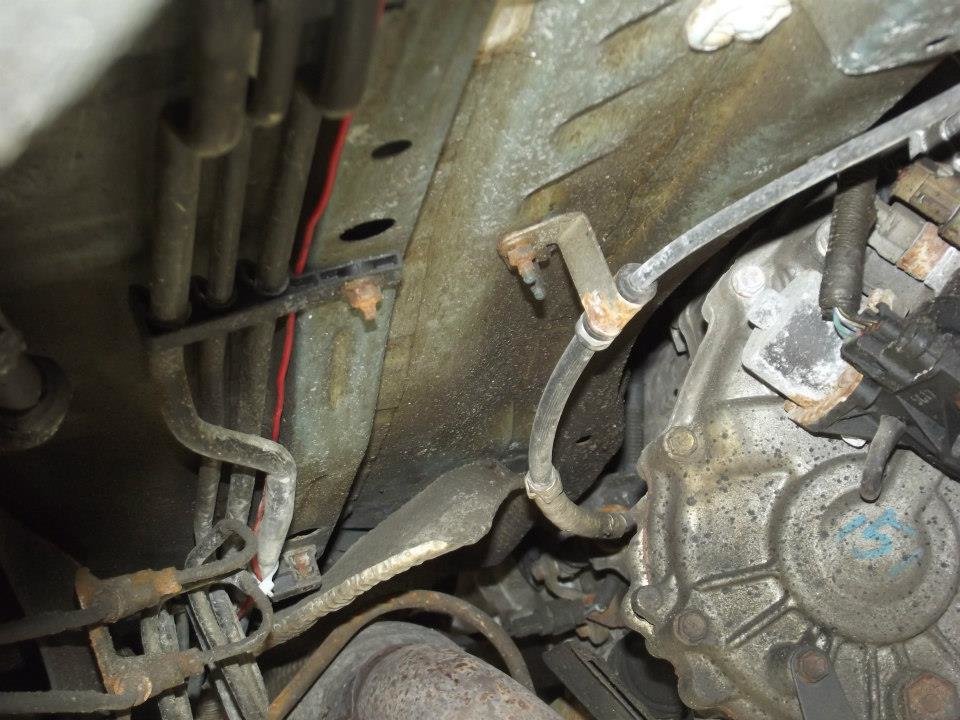

    Here's the power wire which runs from the battery to the rear of the truck:
    931174_10151568840035020_1330678909_n_zp_3d764583764cb7e0edbfe9b5f510c18397b24d76.jpg

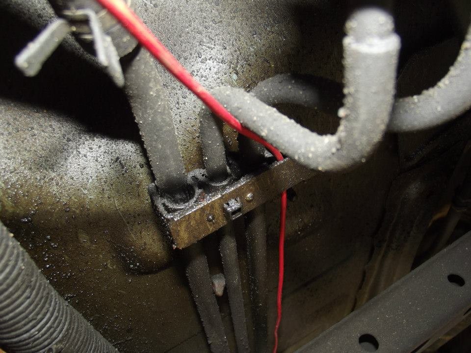

    I ran the wire along the inner fender, down the firewall, and along the frame rails, with the brake lines:
    68553_10151568839875020_1180769556_n_zps_12cb7513aa77bc76816a3fbb62293fc8f1116827.jpg
    63148_10151568839855020_181962463_n_zpsf_1653e1c7ca20ed33575249bb3ebe5cf583327579.jpg
    935322_10151568839635020_1112445292_n_zp_d5d9781ceac2a383e0e0f20c9f79e05c993689e3.jpg
    THen I ran the wire up the rear quarter panel, over the inner fender:
    388031_10151568839055020_1160039589_n_zp_189adc24433129f338715e5357e69c88b8494a41.jpg
    The power wire comes out of the box, next to the anchor system rail along with the ground wire, and wired up to the LED strip:
    417943_10151568838805020_927139805_n_zps_ed2ae41d21b991def8f228a2eb37eee977632922.jpg
    397896_10151572857105020_1863750396_n_zp_f3e2f904d161d7b4dd24216301bcf38df43e5aba.jpg

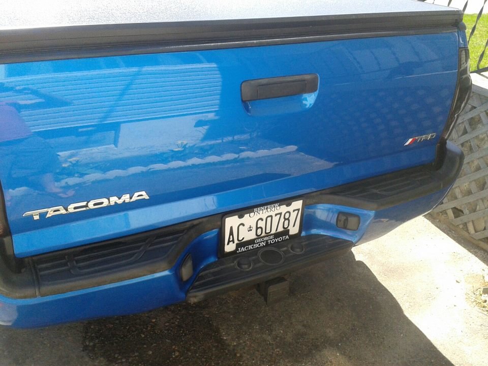

    The end of the ground wire, was run to the tail light recess of the rear quarter panel, through the latch post, to the back of the contact switch:
    11448_10151568838465020_670232077_n_zps7_ffd643dd6cd3228751af0184c6e24058e651ce41.jpg

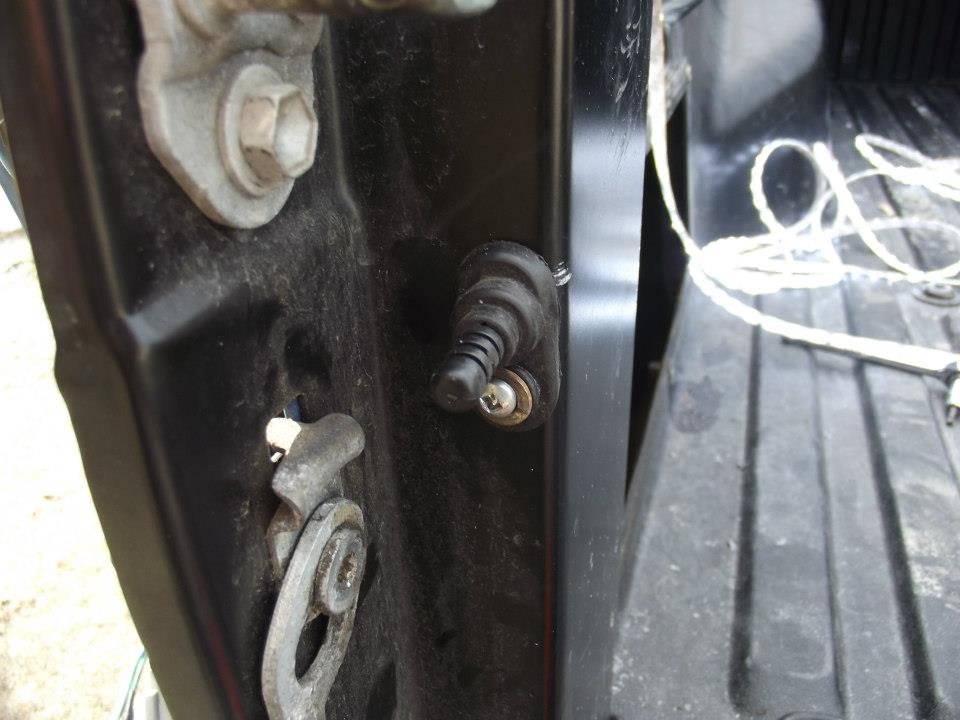

    I used an existing hole in the pillar, and just drilled it out, so the contact switch backing would go through.
    298061_10151568838740020_453648319_n_zps_122352f80130f32295ef79e1fc5581adeb63c067.jpg
    Basically, you get constant power from the battery, but the lights only go on, when the tail gate is down, and the ground makes contact with the switch.
    Here's a night shot....
    12387_10151568840140020_303981047_n_zps3_5d8d11e3b6eed8eb3ec6c59caf07bc5e63b08222.jpg
    I like how it turned out.... almost looks OEM! :) Let me know what you think??
