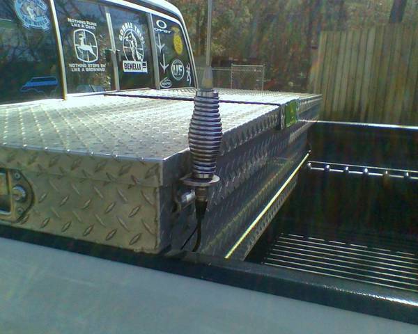

    Ok so in the picture of your mount. You are going to need to drill a hole on the tab where the mount is and than run a grounding wire from that hole you drilled in the tab and run it down to the frame. The mount needs to be grounded, not the stud.

    Ok my mount is kinda rusty right now and needs to be painted. But to give you an idea. Your bed bar will need to have the hole drilled in it and than sanded down around the hole so you can see bare metal.

    Really it can be anywhere on that bar. I would make it as close to the stud/ antenna as possible.

    Has anyone thought to check the radio, it could be a bad radio, and what is your standing wave?... that will tell you how good your putting out
  17. Apr 1, 2010 at 9:54 PM
    #37
    91Toyotabogger
    91Toyotabogger "Loud Tires Can Save Lives"
    Aug 29, 2008
    #8861
    475
    North Carolina
    91 4wd 5sp manual Pickup Standard cab white
    Mud Tires, CD player, CB radio with PA speaker, De-badged, window decals, Flow Master 40 series
    Thats my modified mirror mount on my toolbox i have it grounded to the bed bolt.
