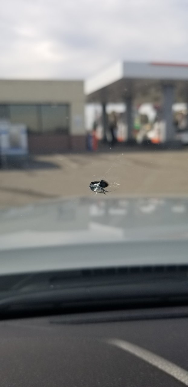

    I just got a chip in mine last week, saw it this weekend for the first time. I'm trying to figure out what I should do. Hope this gets some feedback.
