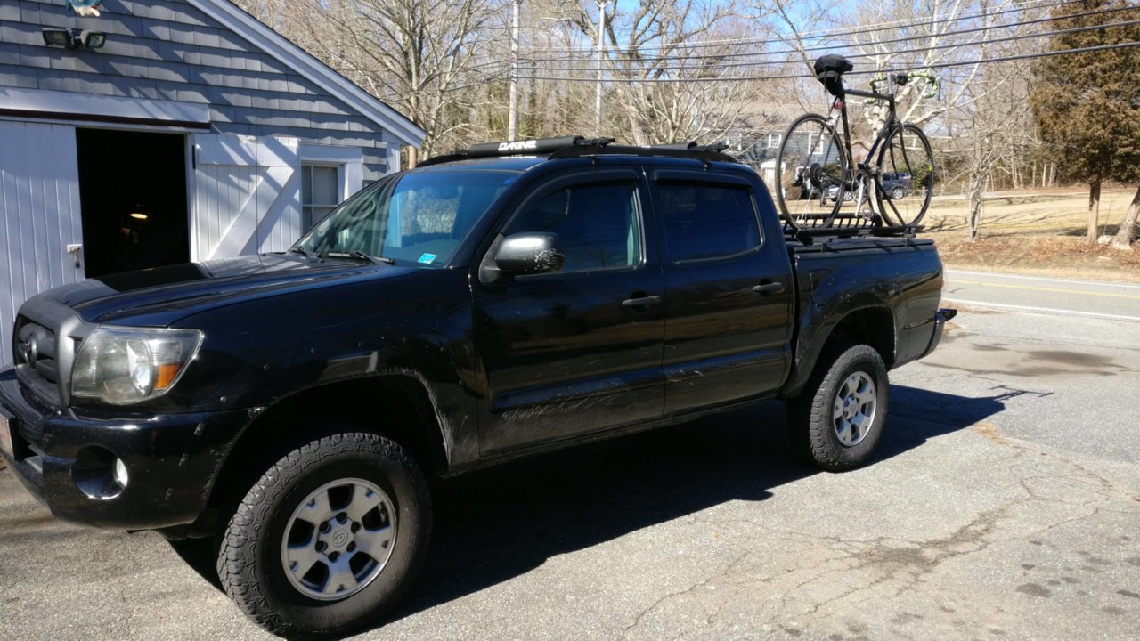

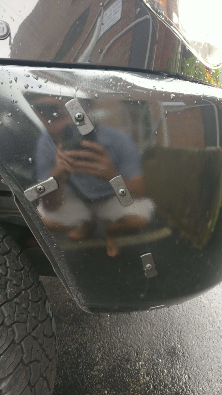

    i took some 1.5" fender washers and cut them to about 3/4" or so, painted them black and used a screw/washer/nut to hold them in place. not the most elegant, but it was the best i could come up with. for the bottommost one I just slapped some gorilla tape on it since its curved.
  13. Aug 6, 2019 at 9:39 AM
    #213
    seedy_tea
    seedy_tea Well-Known Member
    Dec 1, 2017
    #237398
    339
    chris
    Cape Cod
    2009 TRD-OR DC
    took a closer pic at lunch. I missed the one that would be in the top left of the pic. that one needs a custom cut to follow the bumper curve. again, i'm not saying this is the best solution, but its a cheap/easy one that worked well enough for me. having a black truck helps it blend it a little bit better.

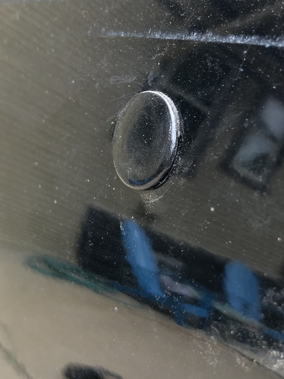

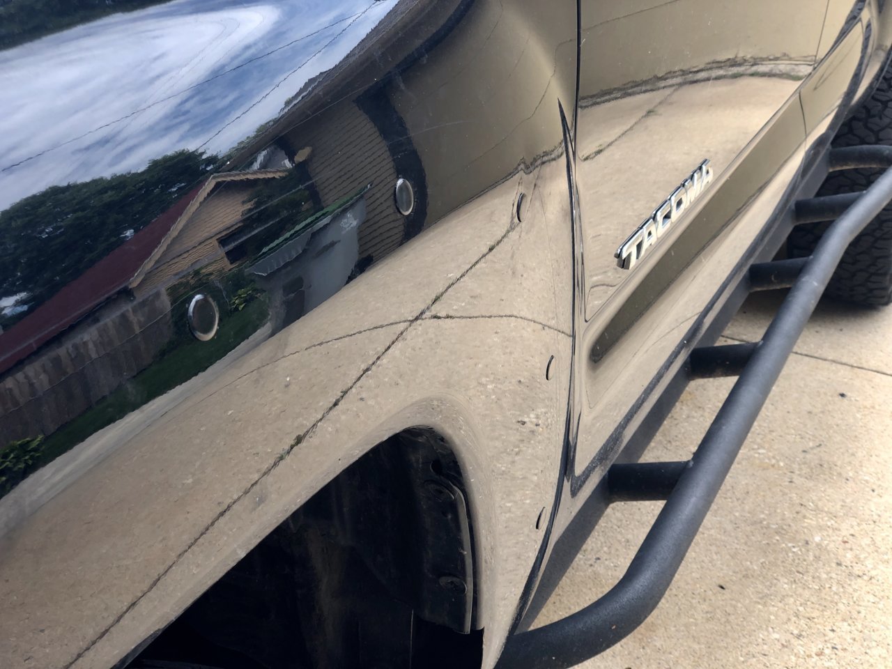

    So I bought these for less than the box of rubber washers I wasted my money on. The foam washers come right off the new clips and can reuse them for my already painted clips! Done and done.

    Short answer is that I eventually used these
    https://www.ebay.com/c/17018316210
    Actually I trimmed, sanded, primed, painted, clear coated my oem clips and stole the little foam washers from the eBay ones I just linked.
    Most other people used whatever clips (oem, eBay, etc) and then rubber washers from Home Depot or Amazon you can find my link above somewhere or others in this thread . My clips just didn’t allow for that, to tight of a space. I slightly prefer the larger washer look that eatsleepstacos has in this thread. But I could not get any washers I found to work. Even bought a rubber sheet to try to make my own washers and gave up. In the end I used those eBay ones above and they look great. CC5F416E-CE6D-4223-92CD-5B85DFE148C9.jpg
    Now to try to get rid of the line left by the rubber from the oem flares!

    Finally finished! :goingcrazy: Sure love the flare-less look!
