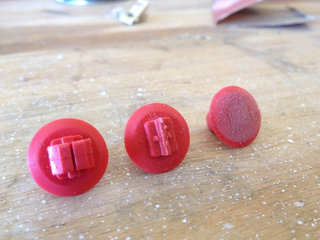

    Did you use the clips for the 1st gen?

    Sure did. I actually have put my modified flares back on with the 35's. Trimmed the shit out of them. If you need clips go on ebay and order them. Save some money!

    Pulled one flare of today. Do you have another link for the clips? Your original one does not work

    The part numbers you need are in the hyperlinks on the first page. Stick with all red clips.

    all finished up finally. the clips i bought were not OEM, but they were OEM quality. i got them off ebay. i did not need bondo because as i sanded mine down, they did not have the two little slits like OP did.

    Looks good. Finding clips that don't have holes in them after sanding really saves a lot of time.

    That sucks. Yea I noticed your fronts don't have any lines, but the rears still do. Thinking of eventually doing this for the rears, maybe with a combination of cutting a little for more clearance. Or maybe even just trimming a lot off, even the mounting holes

    I don't know about everyone else, but I took the fender skirts out and didn't put them back in.

    Quick question for the op. How did you get them to clip in with the neoprene on them? can't get mine to lock in to save my life

    The blue ones go in with a twist. The red ones just push in till they pop. Maybe your washers are thicker than the ones I used?
