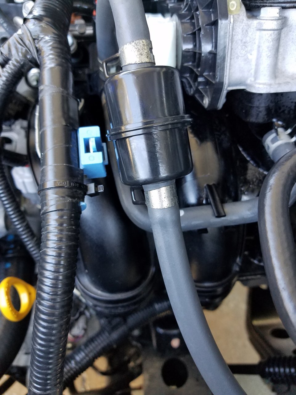

    what is that filter behind the power steering resavoir looks like old type fuel filter

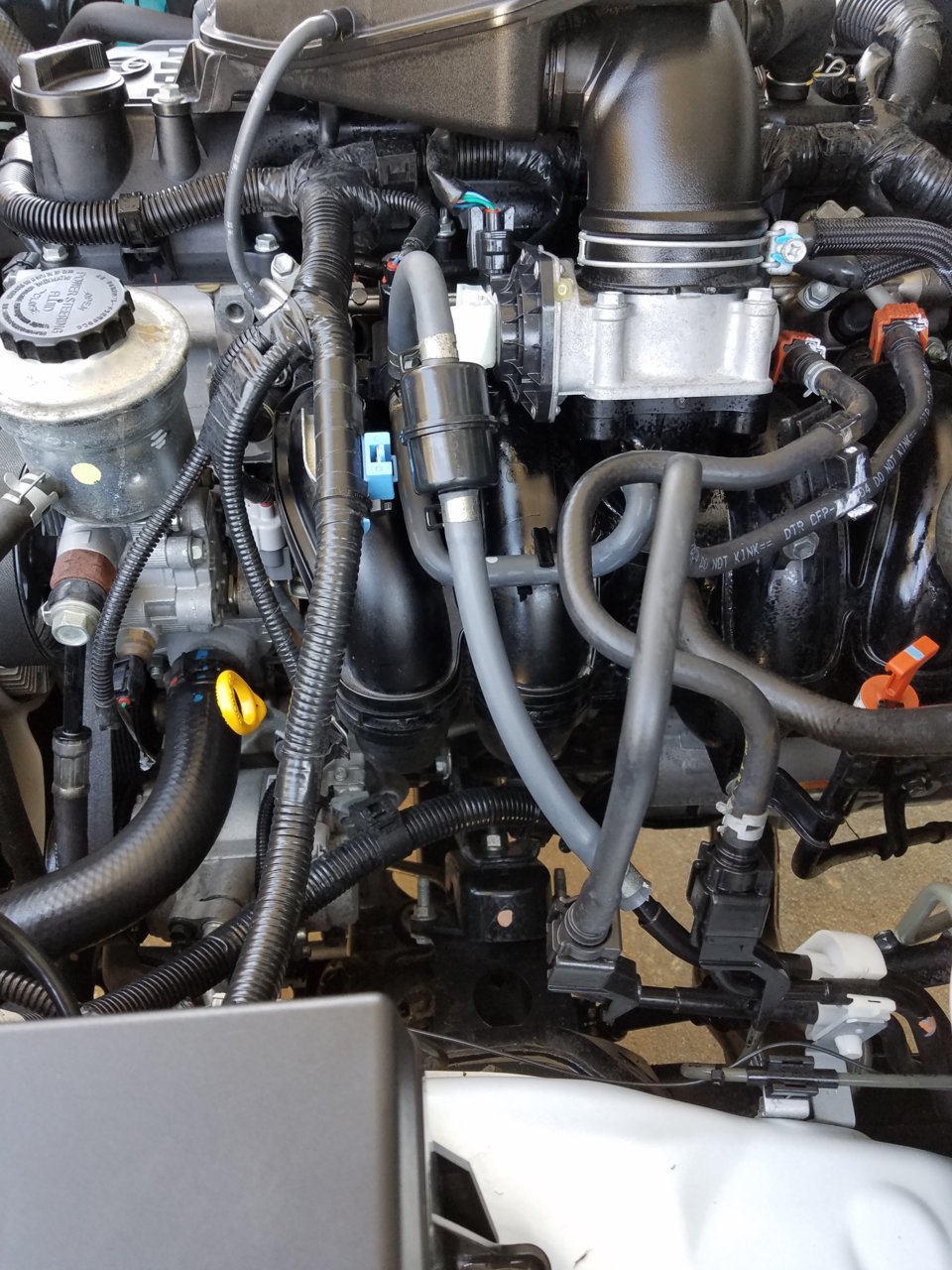

    Are you speaking of the small black canister to the immediate right of the blue plug in the pic?

    yes i been told it is a return fuel purg cannister is this correct

    It is in the return system, but i don't know what it is/does.
    I do not think it is the purge cannister.
    I'm sure someone will be along to help now that there is a photo.
    @Jimmyh, what does the FSM show here?

    I'm not clear as to its exact purpose, but I was curious as I moved it out of the way doing a 4.0L spark plug change and when opening the drivers side engine block drain plug from above vs. pulling the tire off. Using google I found it to be:
    Vacuum Surge Tank
    Part # 25719-50040
    Used on many different makes of Toyota
    Google the part name/number and you'll get all kinds of hits.
    I was not able to find this part on the 2005-2006 FSM from customtacos.com or the waybacktimemachine - I believe that a lot of Emission control function was not included by the person(s) who put that together.
    On page EC-2 in the following URL - you will see the Vacuum Surge Tank - you can simply do a FIND for "vacuum surge tank" from the top of the document:
    http://maxim.int.ru/prado/1gr-fe/1GR-FE Emission.pdf

    I believe it is like a check valve for fuel vapors
