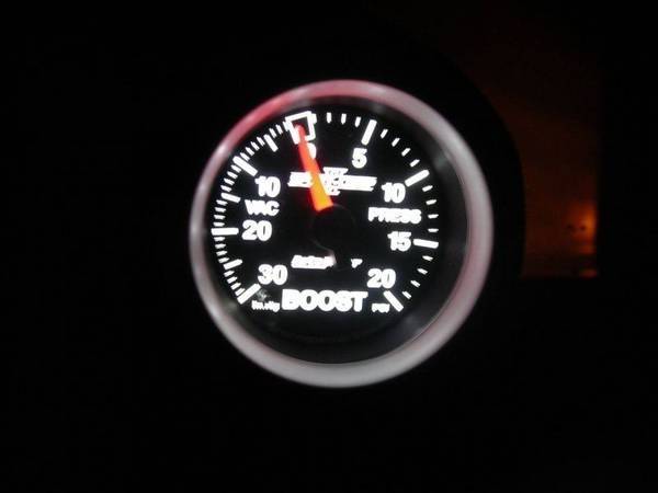

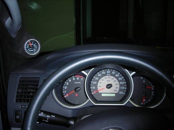

    Well, I got my sweet gauge pod from 07SWB today. This is a top notch piece to say the least. ALOT nicer than any other gauge pillar Ive had in previous vehicles.
    Put my Autometer Sport Comp II boost gauge in it to match my white/red gauges.
    Came out super nice
    Great work man [​IMG]
    As I have stated many many times before, I really suck at taking pics. And for some reason my needles show up orange, and they are super dark red[​IMG]

    Looks sick! What material is it made out of?

    Its a stock pillar, with a custom fiberglass pod glassed over it. It covered in black suede

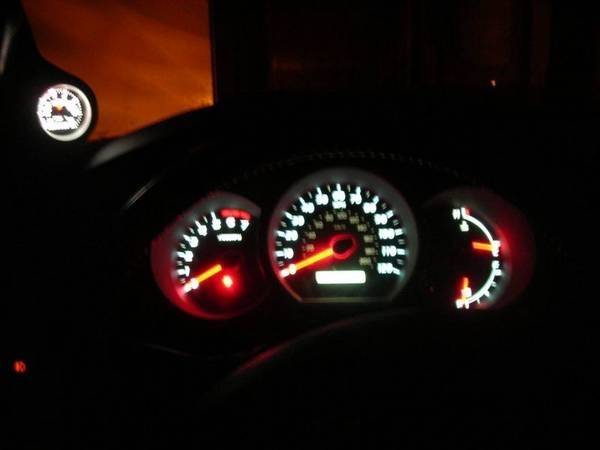

    Looks like you're about out of gas Justin :) The gaugue looks sharp dude, i like it. did you swap out the led's in your dash yourself or did you have someone else do it?

    I had some help, but its really not hard at all. I could do it again If I wanted to change to something different. I just love the white

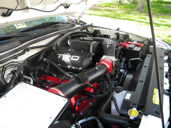

    there is a boost port on top of the plenum towards the firewall. its a pretty easy connection
    wow this is an old thread :)
    you can kind of see it here ( it has a plug on it in the pic). its right next to the back coolant hose
    when I made this thread, it was hooked to the URD S/C and it was just a T between the intake and bypass valve

    I saw this thread for the vac/boost port location, might be easier to see;
    http://www.tacomaworld.com/forum/performance-tuning/74154-installing-boost-gauge-05-trd-sc.html
    I have the TRD boost gauge in my truck and have the hose run through the firewall.
    I haven't installed the TRD S/C yet but I have looked at the unit and found the port from the above thread. Is there a hose that connects to this port when the S/C is installed or is it just capped? I'm wondering if I need to tap into whatever hose goes here with a t-connector for the boost gauge.
    Is this port where you would connect the MAP sensor hose from the URD MAF calibrator w/ MAP option? I'll be installing that after the S/C is on and I get a laptop.

    That port is capped when you get it. I got an elbow from Advanced Auto that fit right on it and help the hard line from the gauge on the other end.
    you would pick up MAP from there too, but I dont know many people running that calibrator with the S/C
