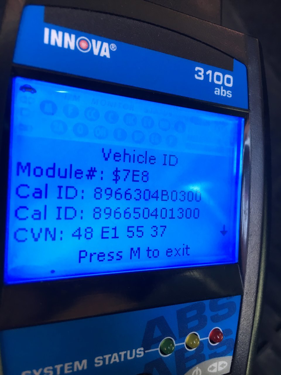

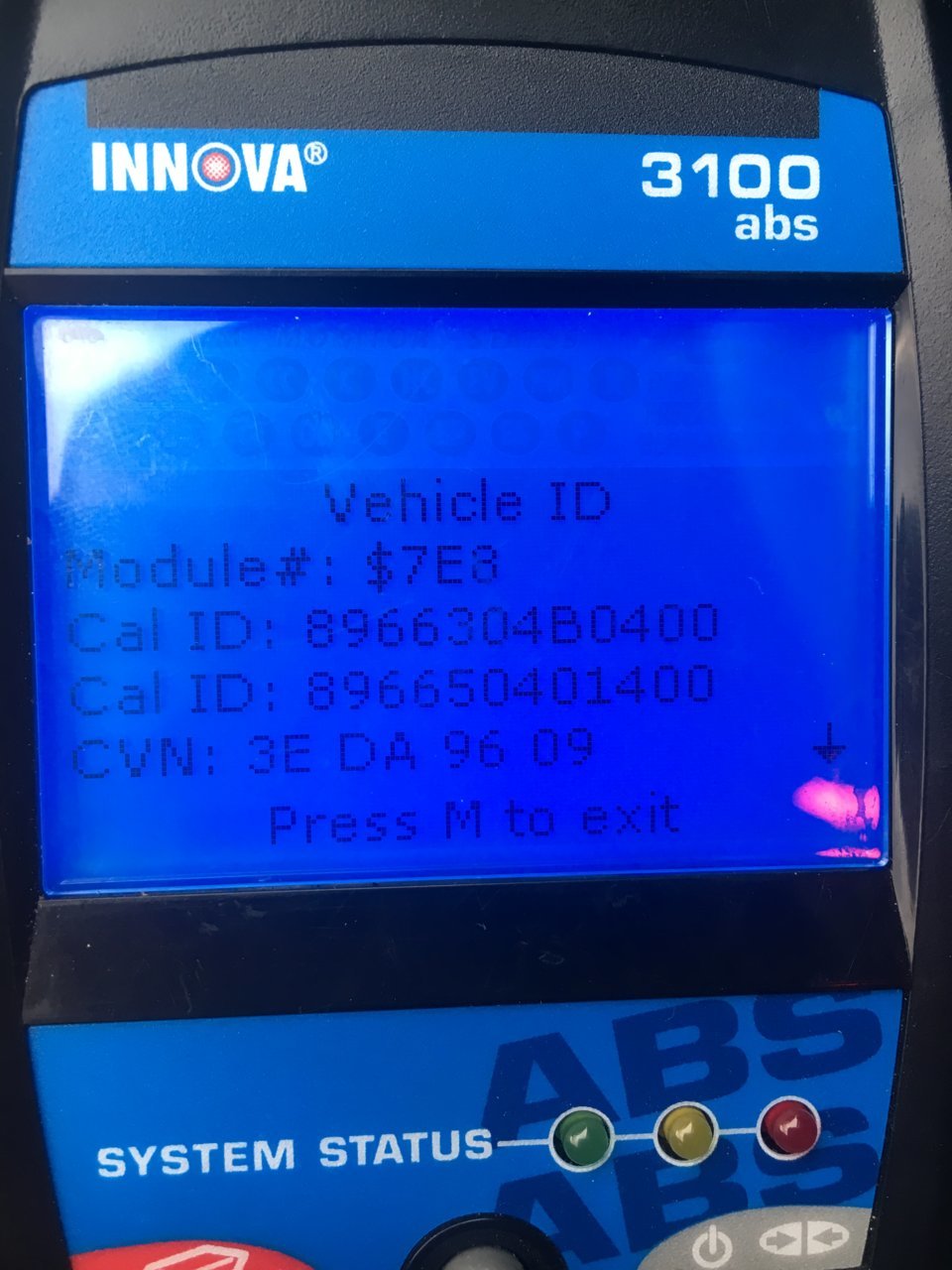

    It appears not. I’m going to put a code reader to my vehicle and check it. I have what it looks like before and post them. If you have a code reader you can match it and see if yours matches. Give me a few.

    There's the proof :thumbsup:
    I noticed there's a second Cal ID number that changed as well.. hey auto trans guys, is that for the TCU or a sub-Cal ID???!!!
    Still no ECM update for us M/T guys (engine) :pout:

    Well, it looks like the new cal ID (04B04 for MY 16/17) is the same for both TSBs. You can see it in the PDFs. :notsure:
