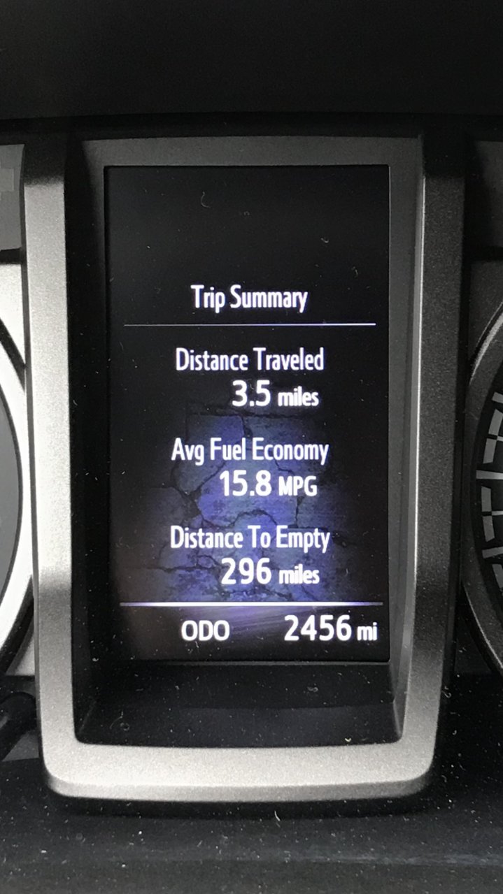

    I've customized my screens so it might not look exactly like yours... but can anyone tell me exactly what the "Avg Fuel Economy" is?
    Is it all around average for the life of the truck?? If so, I'm really surprised. 2500 miles and I'm not a heavy footed driver. My "per tank" average always hovers right around 17.9. And obviously, the per trip is self explanatory. That one is usually 16-17.
    So why is this Ave Fuel Economy one so low?

    Avg fuel economy is what you get per tank if you clear it to zero everytime you get gas. Otherwise it is the avg for every tank since it was cleared last.

    I've never cleared mine... so, my overall average since I got the truck is 15.8mpg!?

    No 15.8mpg was for that 3.5 mile trip.
    There is also "average fuel econ" which is overall, and "tank average" which resets each time you fill up.
    Beware, if your truck loses power they will reset!
