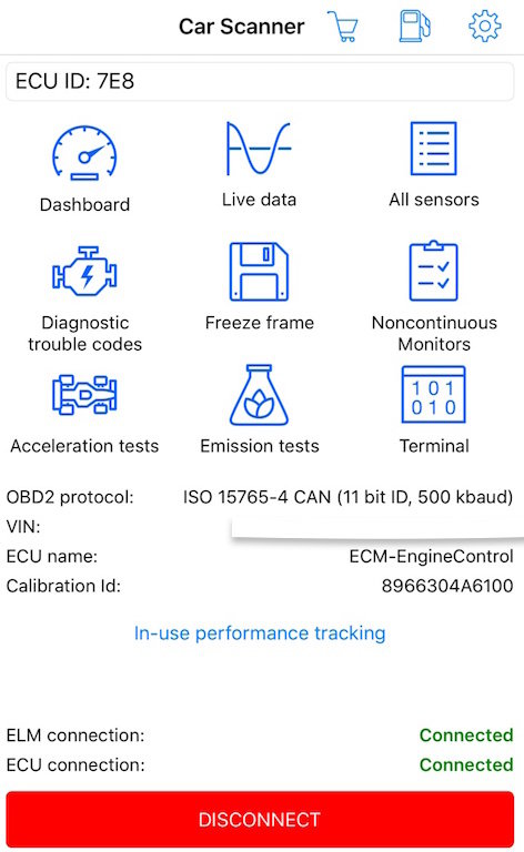

    Thanks! So when I take it in to have the ECU flashed my new calibration ID should be 896630A6100 and that will have included the TSB fix?

    Yep, once they do the tsb you should see your cal as the 6100.

    Yep B0400 for 16 and 17s and A6100 for 18s.
