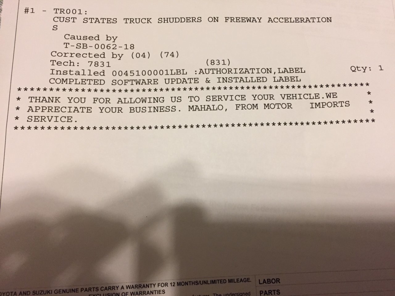

    TUNED 2.0 Beta 87 Eibach Pro Truck Lift Kit Stage 1 Wheelers 1.5” Progressive AAL Level 8 MK6 17x8 Falken Wildpeaks 265/70/17” Redline Tuning Hood struts Matt Gecko LED Bed lights OEM Roof racks GoRhino RB20 Running boards A/C drain Mod Kicker speaker upgrade w/kicker key amp. MESO Stage 1 Tail light upgrade OEM Bed Mat
    Got mine today. Brought the TSB print out. Gave it to my service advisor and he said great see you in an hour. It was done and I have the sticker on the inside of the hood to boot! Drive home I could tell the difference. A lot smoother shifting.
