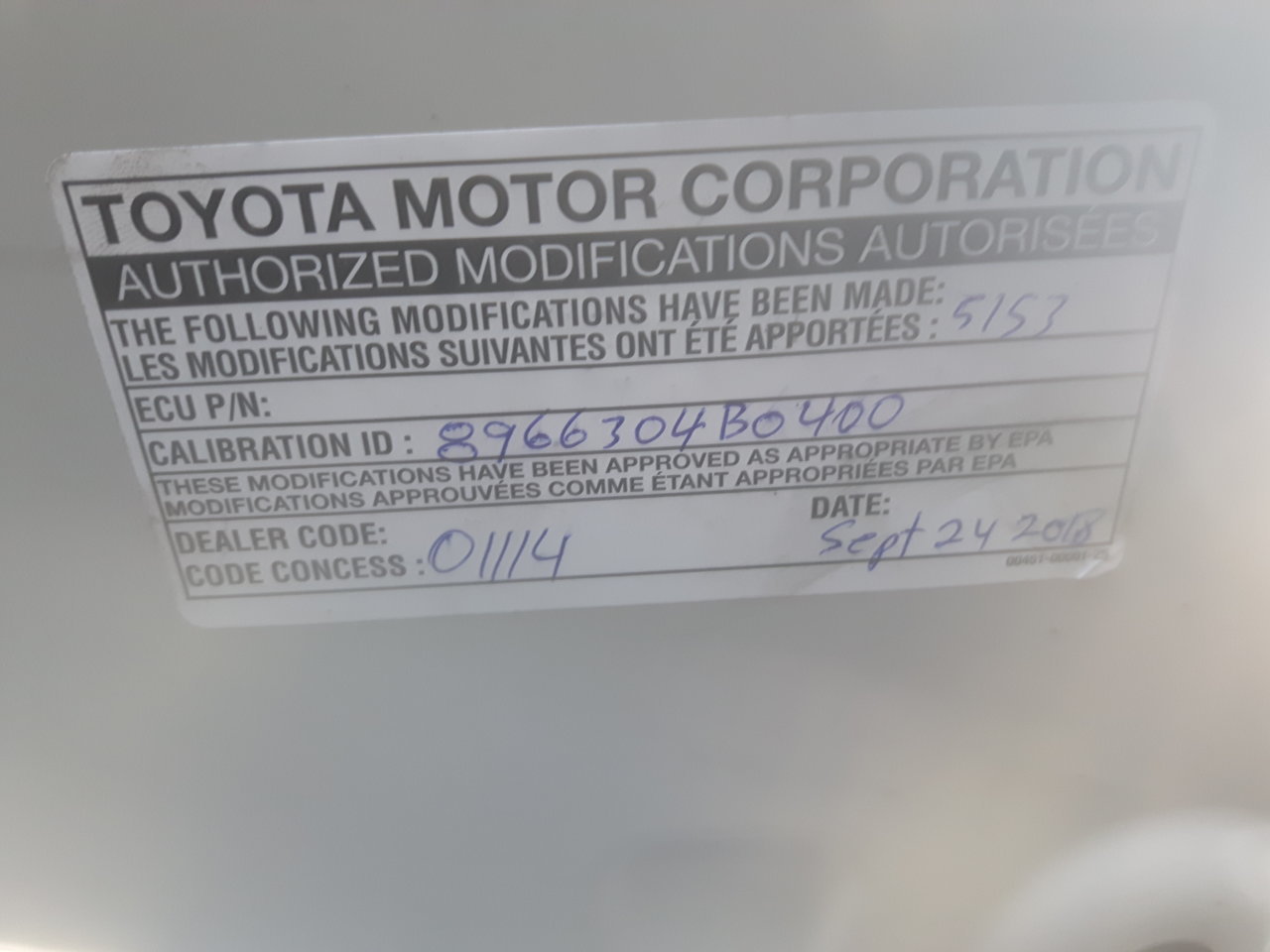

    Where is this tag located? I had mine done a month or so ago and I have no tag...

    As part of the TSB and probably to meet some EPA regulation they are supposed to put that on the underside of the hood or under the appearance cover. Most techs are skipping it. That's why the only real way to make sure the update was done is to read the calibration code with a scantool. I have had all 3 flashes and never got a sticker but I don't care because I checked the code and I am content with the way my truck drives. YMMV

    They put mine under the hood, driver side closer to the windshield. I checked for it to make sure they did the update.

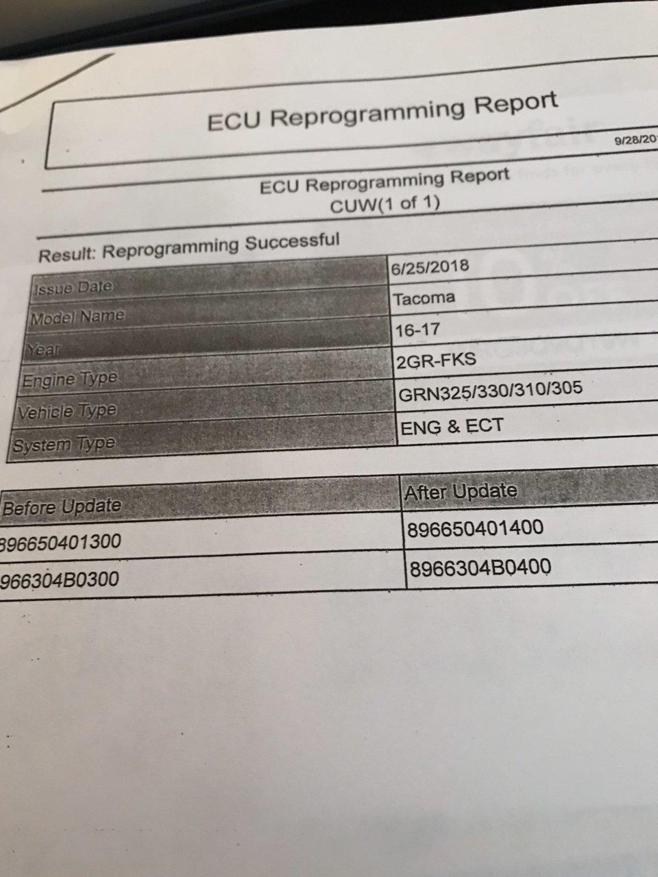

    Watt the prosses for the scan tool? Where do u get it?

    Much better! The stumble/lugging is gone! They did 0062-18! Dealer did the update without question! Really wondering about gas mileage, was getting 20 to 23 on my 30 mike trip to work each day! Will be interesting to see what happens now!203D12C0-0E1E-4BA4-A06C-5C0CBE4D764C.jpg
