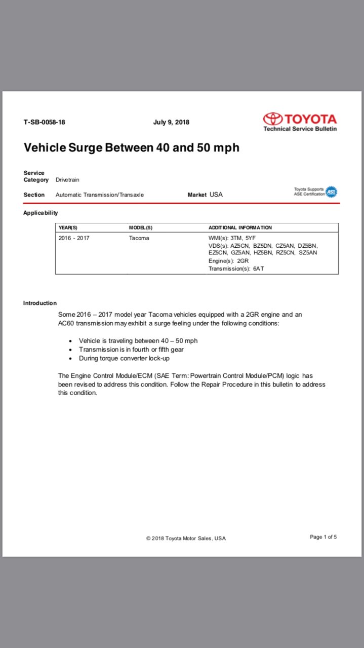

    So TSB 62-18 is the latest? From all the TSB ECU updates I have had I was always told that the newest ECU update had every change from the prior ECU versions. From what a few have said there are two ECU TSBs that need to be done? High altitude and WOT surge?
    I am in Utah so if I need to get the high altitude along with the WOT surge im sure ill have no problem getting them both.....

    WOT is the high altitude. The 40-50 mph surge is the other one.

    Update: I got my truck back from the dealership today as it was in to get a clear coat and tint. I had service take a look into updating 0062-18.
    They said they could not replicate the issue, but also said they believe my truck was built after the update. I ordered and received my truck about three weeks ago.
    I am hoping they are being truthful about this...is there any way to check my VIN vs the TSB date? I still feel like the AT shifts so early and seems to be "searching" for a gear a lot. Perhaps its just because I only have 500 miles and the ECU is still learning my drive patterns...

    They do not have to replicate it if you don't want them to. The update came out July 17th, about 2 weeks ago, a few days after you got your truck. I would take it back and get a print out of service preformed. tsb0062-18 or (eg1181)

    Update for Canadians: There is a TSB for 2016-2017 trucks specifically for Canadian market, called T-TCI-5133. Please read the pdf. (2018 no TSB)
