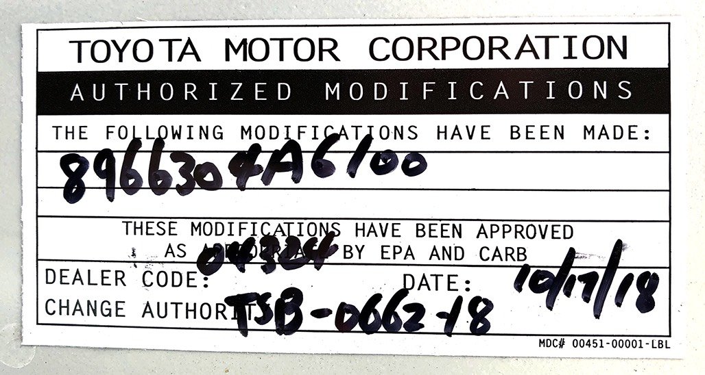

    Finally got the ECU updated on my truck - 2018 TRD Pro DCSB (delivery June 2018) having 1,800 miles on it.
    I ended up going to where I purchased the Truck, Toyota Town in Stockton, CA, even though it was an hour away, they took care of me and treated me with awesome customer service. It was straight forward as me telling them the issue and them knowing that it can't be replicated in our altitude. They said, ok, let's see if the TSB is applicable to your truck and we'll get you updated. No lame excuses and holding on to my truck for a few days. One hour later, I was done and very thankful! I even got a sticker! :D
    A huge thanks to everyone on this thread and the forum!
    Anyway, here's the info I got from my scans...
    Calibration ID (ECU 7E1)
    Before: 896650404000
    After: 896650404100
    Calibration ID (ECU 7E0)
    Before: 8966304A60000
    After: 8966304A6100
    Immediate observations
    Have driven it approximately 200 miles (75% highway)
    • Shifting is smoother
    • Better pedal throttle control
    • Lower RPMs while at constant speed at 70-75MPH
      • Less noise from the exhaust drone (lower RPM)
    • Dare I say better gas mileage
      • I used to just get 19MPG max on mostly highway
      • I actually reached 22.5MPG!
    Will keep an eye on performance over time and report back.
    Sticker is located on the underside of the hood, the corner closest to the driver
