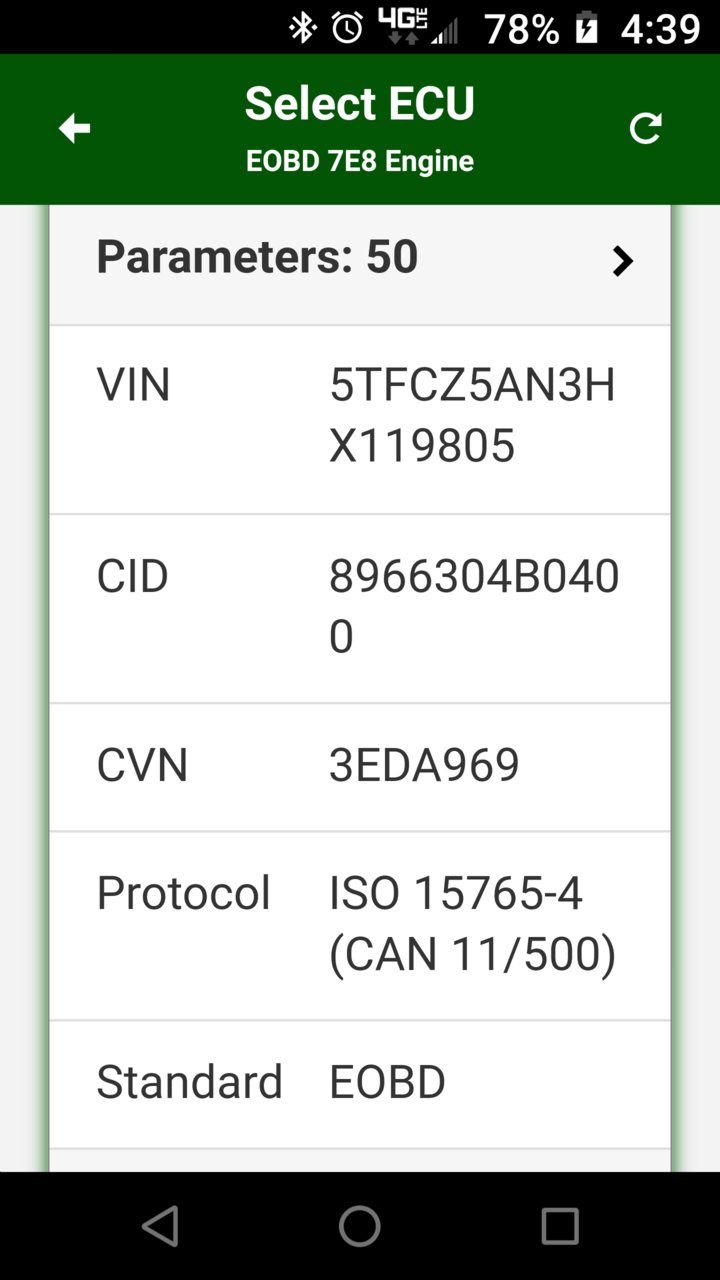

    Received the tsb update from dealer and paperwork showed TSB 007716. Truck drives much better now and after hooking up OBD II scanner it shows CID 0400 which is the desired update!Screenshot_20181027-163914.jpg
