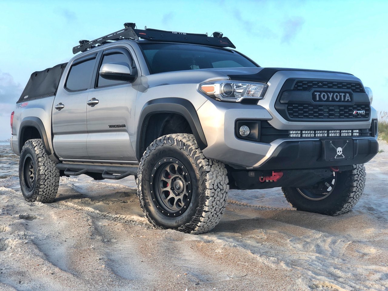

    I can’t believe this thread is 140 pages and not a single picture. Time to fix that.

    Nice truck

    It isn’t mine, but I grabbed the pic because it has the color and some mods I want.

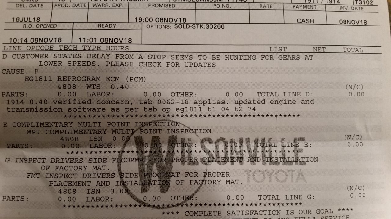

    I just had the TSB 0062-18 done yesterday. I told my service writer that the truck has a noticeable pause when I hit the gas pedal hard off the line. I also notified him that the truck seems to me hunting for the proper gear always shifting up and down. I also informed him I was aware of the TSB update. He's said no problem I was the third one for him this month and they did it on the spot. The newest TSB 0062-18 is supposed to fix both the stumble and the eratic shifting. I was told it will take around 300 miles to fully retrain the transmission. We will see
