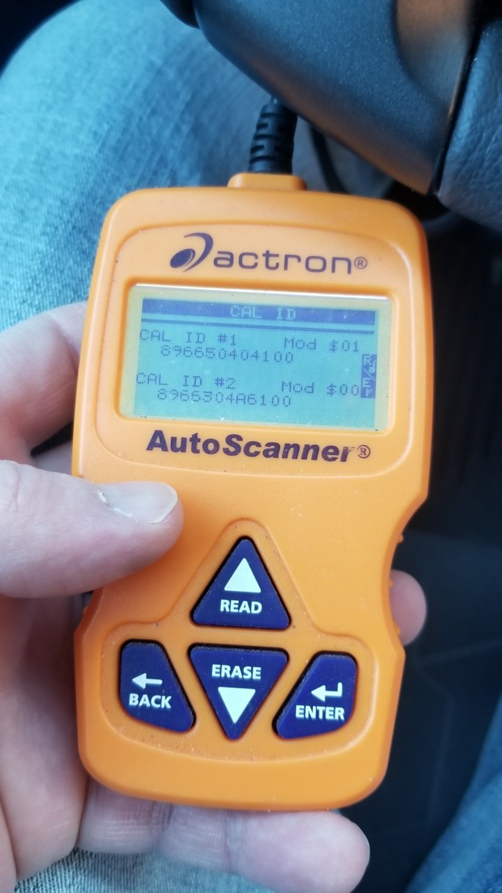

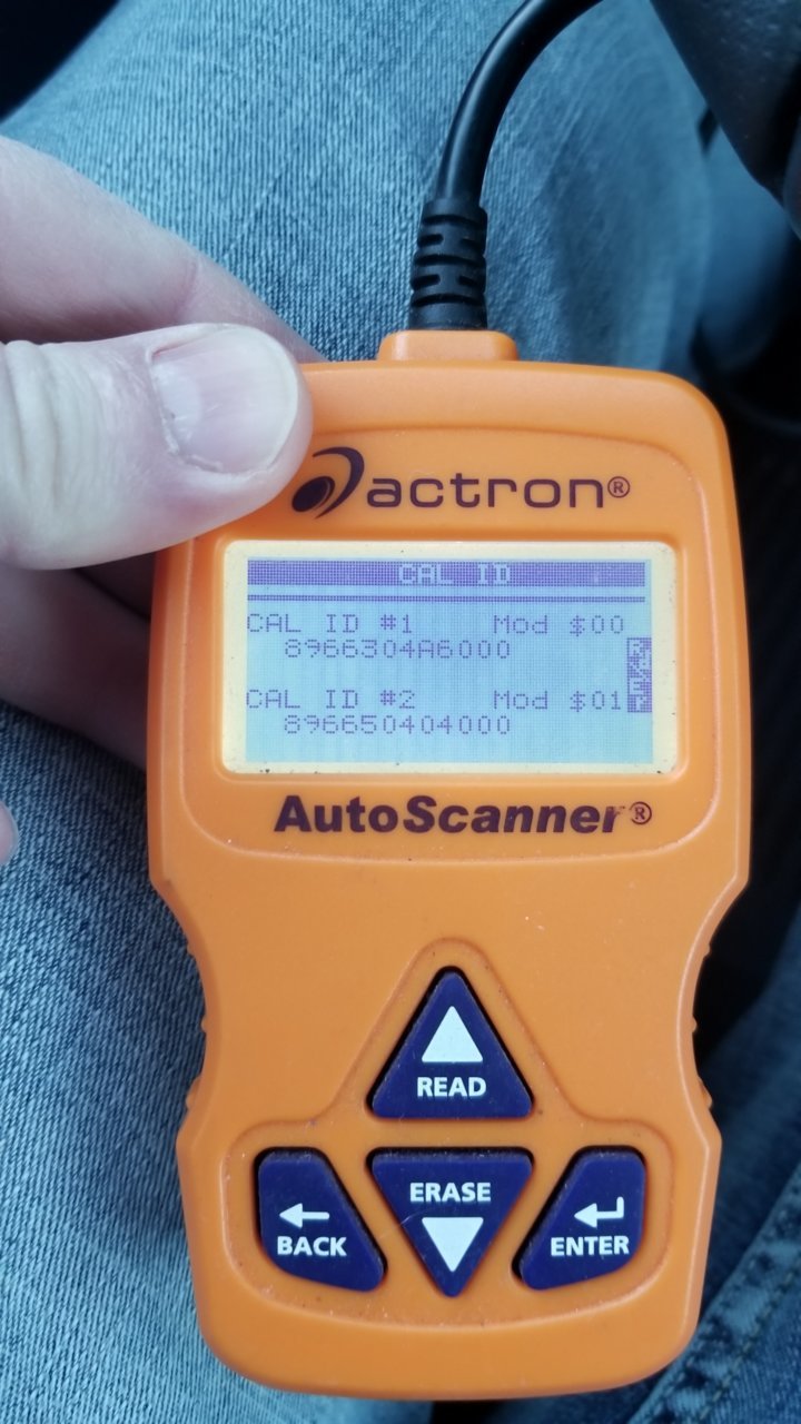

    Just had mine done today. Checked Calibration ID #'s so I figured I would share
    Keep in mind mine is a 2018 build date 2/18
    Before TSB 0062-18 = A6000
    After = A6100

    Hello all,
    I have a 2016 SR5 4X4. I've had many of the same issues as others. Shifting has been rough at times. Mainly, the truck seems to search for gears and be gutless until hammering on the gas, which is delayed then very pronounced. I went to the dealership yesterday and presented them with the current TSB-0062-18. My invoice states, "24602 up to date ecu & check & reflash with update tsb 00077-16".
    Am I correct that the dealership updated my ECU with one of the earliest TSBs? Truck does respond a little better, but not great as others have mentioned with the 0062-18 version.
